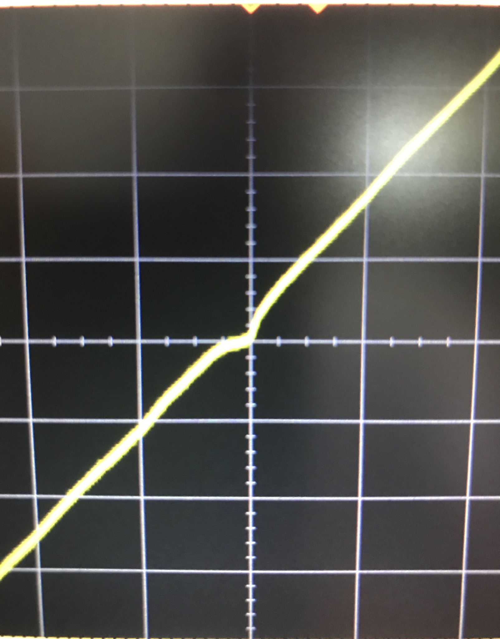

Hi gang, made a few adjustments.
I’ve adjusted the PSU, am now using the on board rectifier, measuring 55 VDC Rail. Any suggestions how to drop 5V?
Swapped R5 12K to 15K.
Added extra 33R to R8, with the recommended 50R on the schematic.
So..
I can’t seam to adjust the bias. I get just under 1 mV DC @ R-8 & R19
Still getting cross over distortion, maybe a little worse.

Do not use a trimmer and a fixed resistor(R8)in the same time.Hi gang, made a few adjustments.
So..
All suggestions welcome, thanks everybody.
Use the trimmer only!
Thanks thimios. I thought I might be off track there, two in parallel would be reducing the resistance. I’ll take it out and try again.

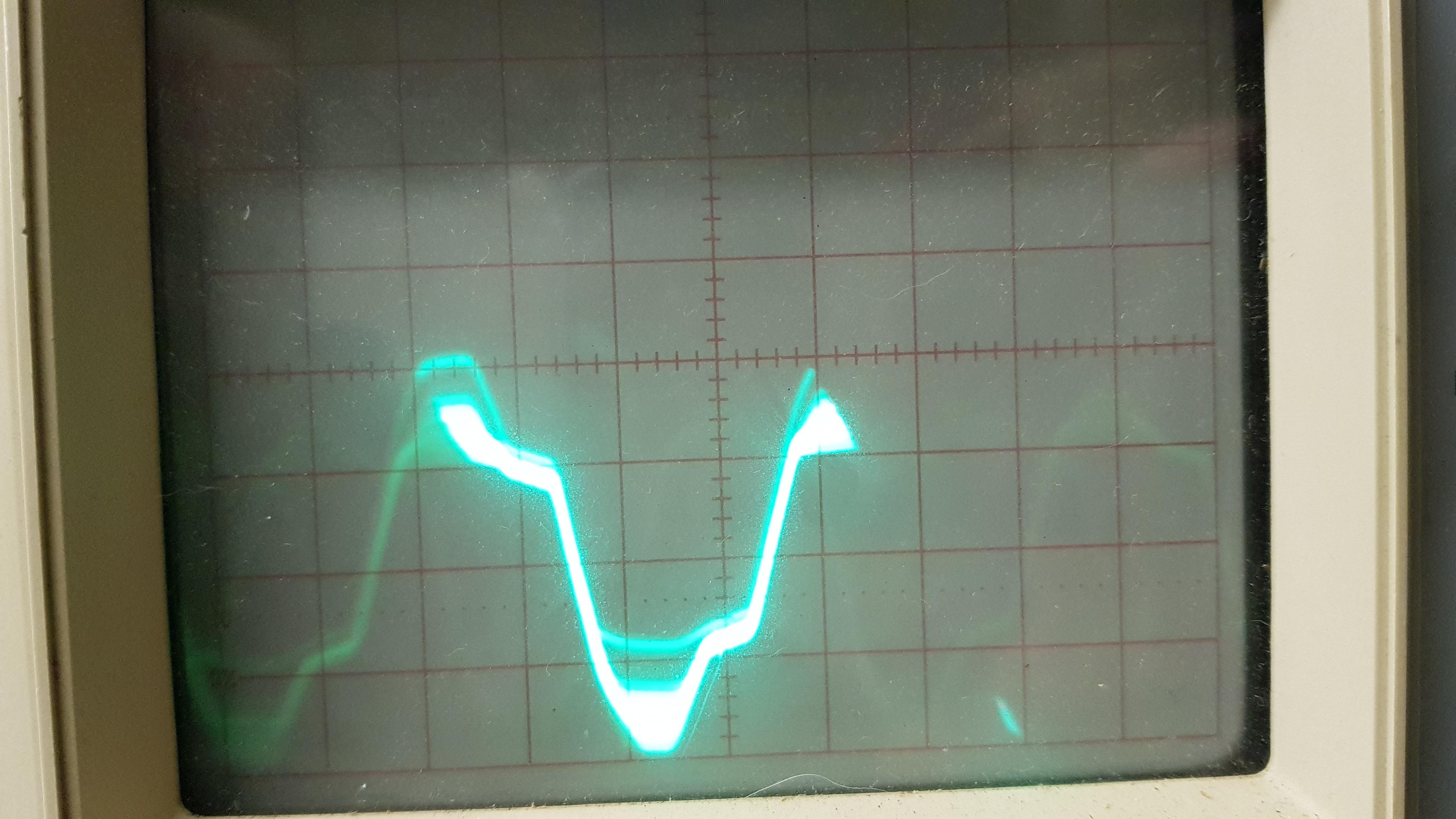

Used the good trannies from board 2 and fired up board 1.
Set bias at about 20mA, nice and stable.
Got a badly clipped output at 0.3v in so dropped it to about 0.1v which got me a sine wave. (I'll check out the voltages later).
Started to get oscillations.. shut it off quick.
Ran the board again without any input and got the output in attached photo.

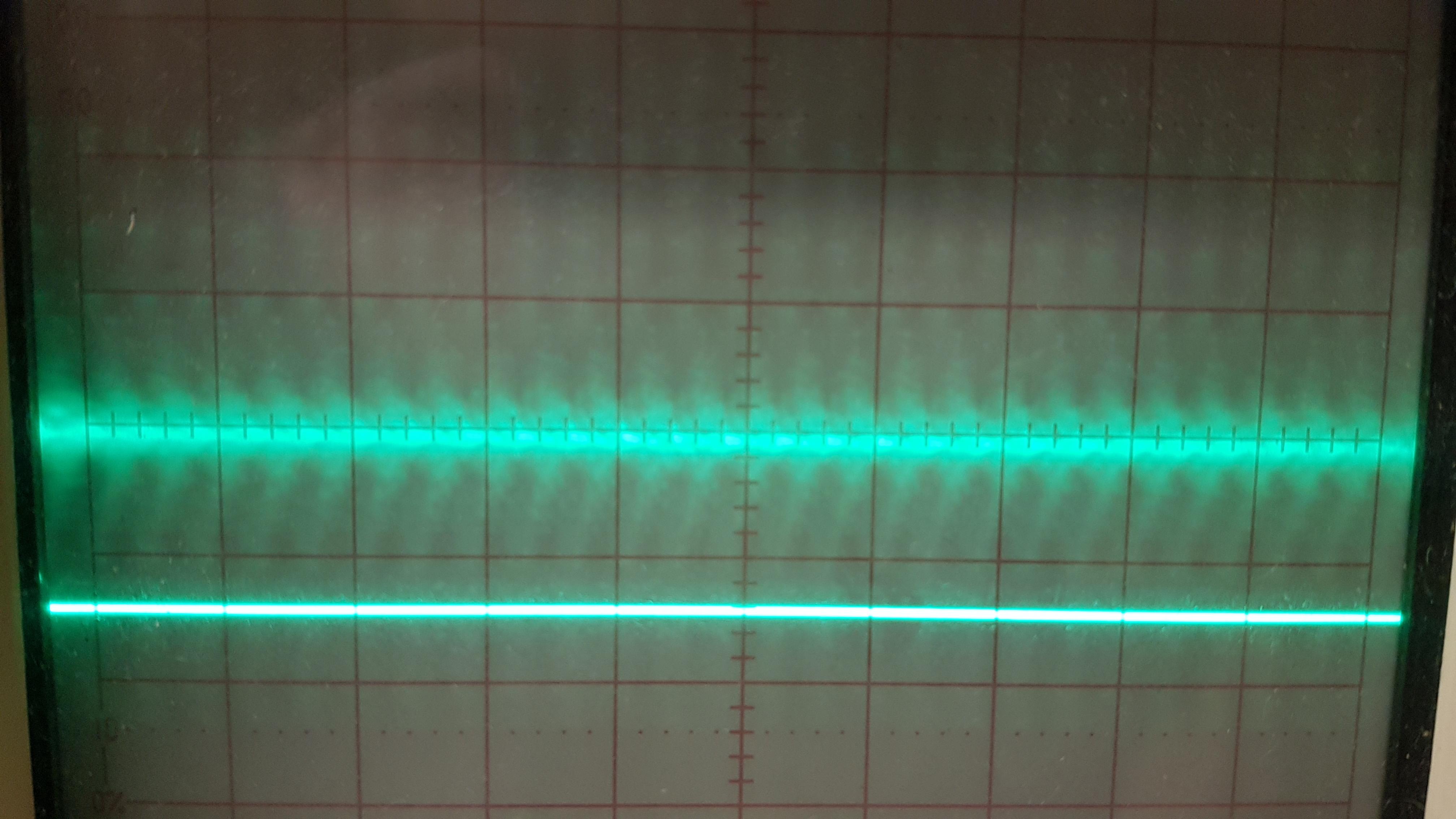

The SMPS I am using appears to be noisy. Second picture is the scope on the SMPS output.
I think I might order up a transformer and the diodes to run on-board rectification and try again then. Waiting for an enclosure to arrive anyway.
*But I did get a sine wave*
*And only had to change out the incorrect driver*

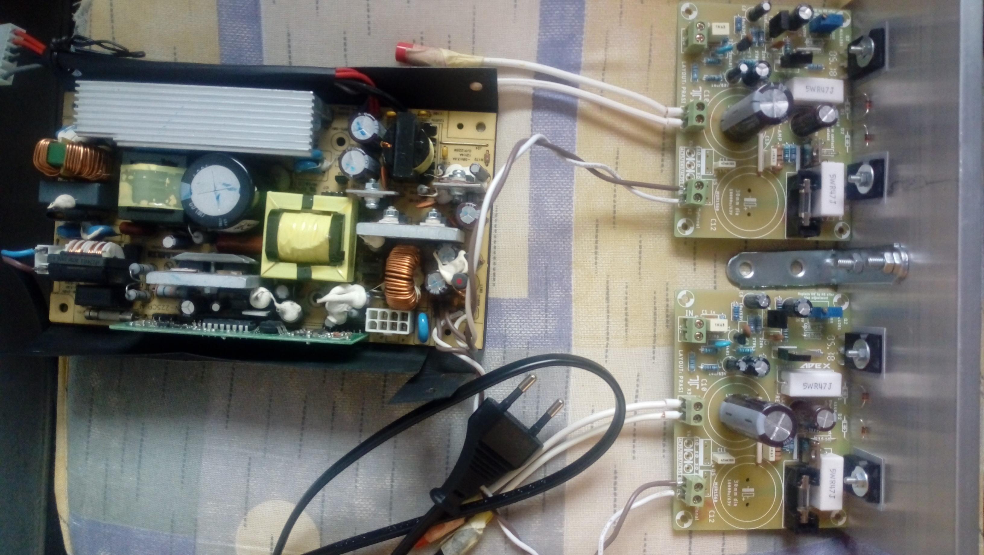

Test setup with SMPS.
Hi ivanlukic, never i have used a smps to power an amplifier.(except a salvaged car amplifier).
Is it noisy? I see a general use smps not for audio, can you tell if you prefer this against linear power supply?
No, it's not noisy. I don't hear anything in loudspeakers. To me audio amplifiers sound always better with SMPS, especially if it is good dedicated SMPS for audio. The only problem is susceptibility of other appliances to ultrasonic noise radiated from SMPS. I am not the only one who noticed that they sound better with audio amplifiers than linear supply! The only problem is that linear supply can be built by almost any diy-er and design and assembly of SMPS for audio is only for very few specialists. SMPS has enormous reserves of current and they can deliver it instantly to amp. The amp has more authority with SMPS. Equivalent linear PSu should be gigantic to compete with SMPS.
