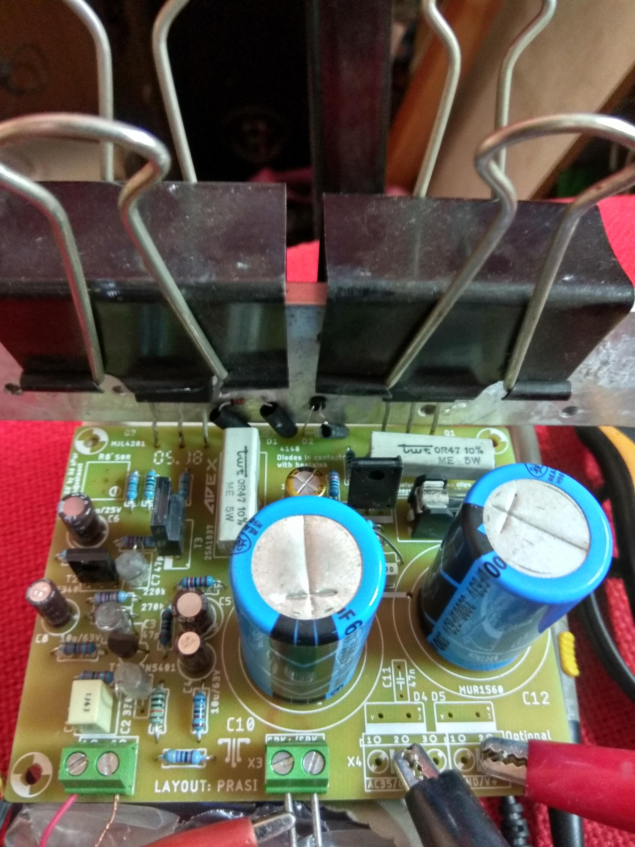

First attempt to play failed.
Only crackling sound, zero bias.
What is the recommented power supply, i had tried using 50v.
Hi thimios, congrats, first off the line. Can I please ask why the zenors are positioned the way they are, is it for easy access. What measurement do you look for there. Thanks, love your work.
I think the schematic (or pcb) said to keep those diodes in contact with the heatsink.

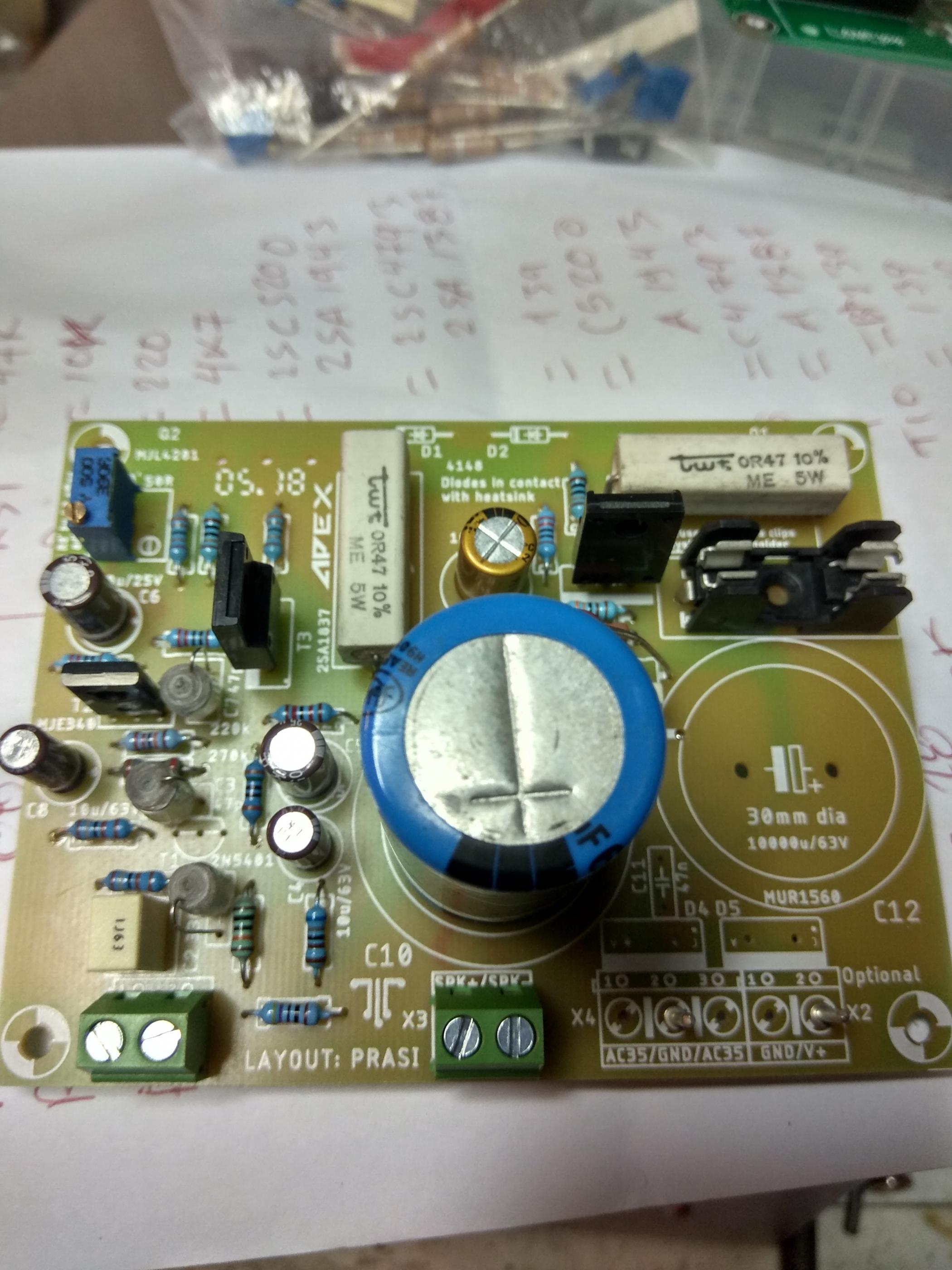

Congrats on getting the build ready to test Thimios! Always disappointing when the board doesn't sing from the start but hopefully it is a simple fix! Any chance of a top-down photo of the completed board?

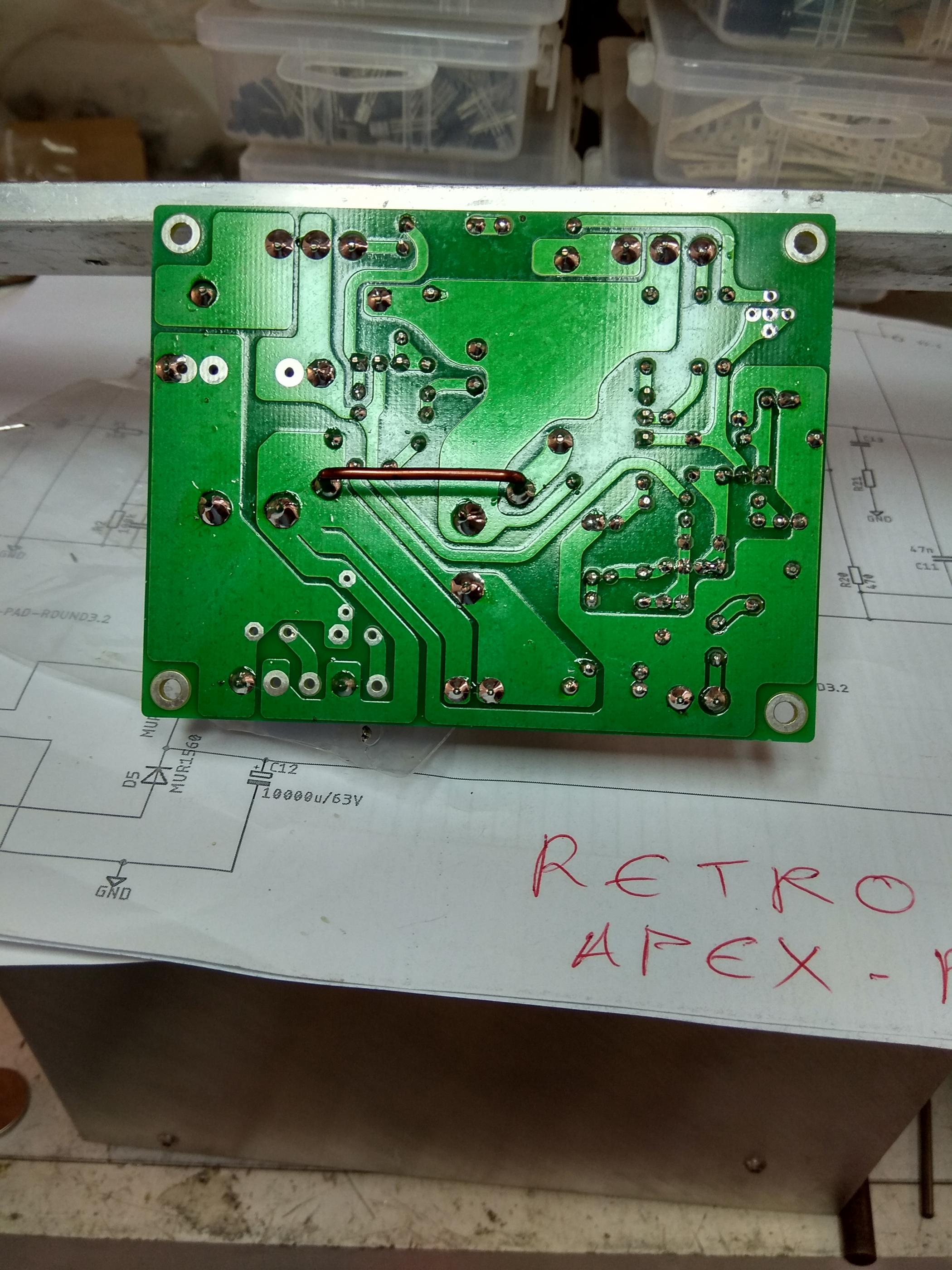

Hi thimios,
1. 50V is perfect.
2. Like Terry said, I dont see jumper installed (its a single sided PCB, so needs jumper).
3. Nice small value caps... retro?
regards
prasi
edit: on a closer inspection, I think I see the jumper installed underboard. post#361 first image.
So the problem could be somewhere else.

Tnank all of you for answers, diodes 2X1N4148 are here bacause this is instead Vbe multipl.
Close contact to heatsink required.
Maybe closer or inside to a drilled hole is better.
Yes Prasi! Eagle eye!!!
Jumper is under the board because putting this on the top affect caps position. This is first ver. PCB and Prasi will see something better in the future.
BTW i can't see any disadvantage using this way.
I will take some underboard pictures latter.
Tnanks again.
I feel that i find the problem now, i amn't near the workstation but as you can see on post#332 a npn symbol represents the 2N5401.
Due to 2N5401 unavailability i used MPSA42.
The Right is a PNP here.
I hope all other will be ok. now.

another observation: There is no need to instal R8 if you already have the trimmer(R8'). Once you finalize the bias, you can instal equivalent resistor in R8 position.
Yes, you are correct thimios, it has to be a PNP here. symbol is wrong in my schematic
Hi Prasi, did you mean... do no instal the fix resistor, instal the trimer, adjust for the bias setting, remove trimer, measure for the value, instal a same value fixed resistor?
Finally what is the recommended bias setting?
Hi thimios, yes, fixed resistor after bias set. Mr. Mile recommended 20mA to 50mA bias somewhere on the thread.
