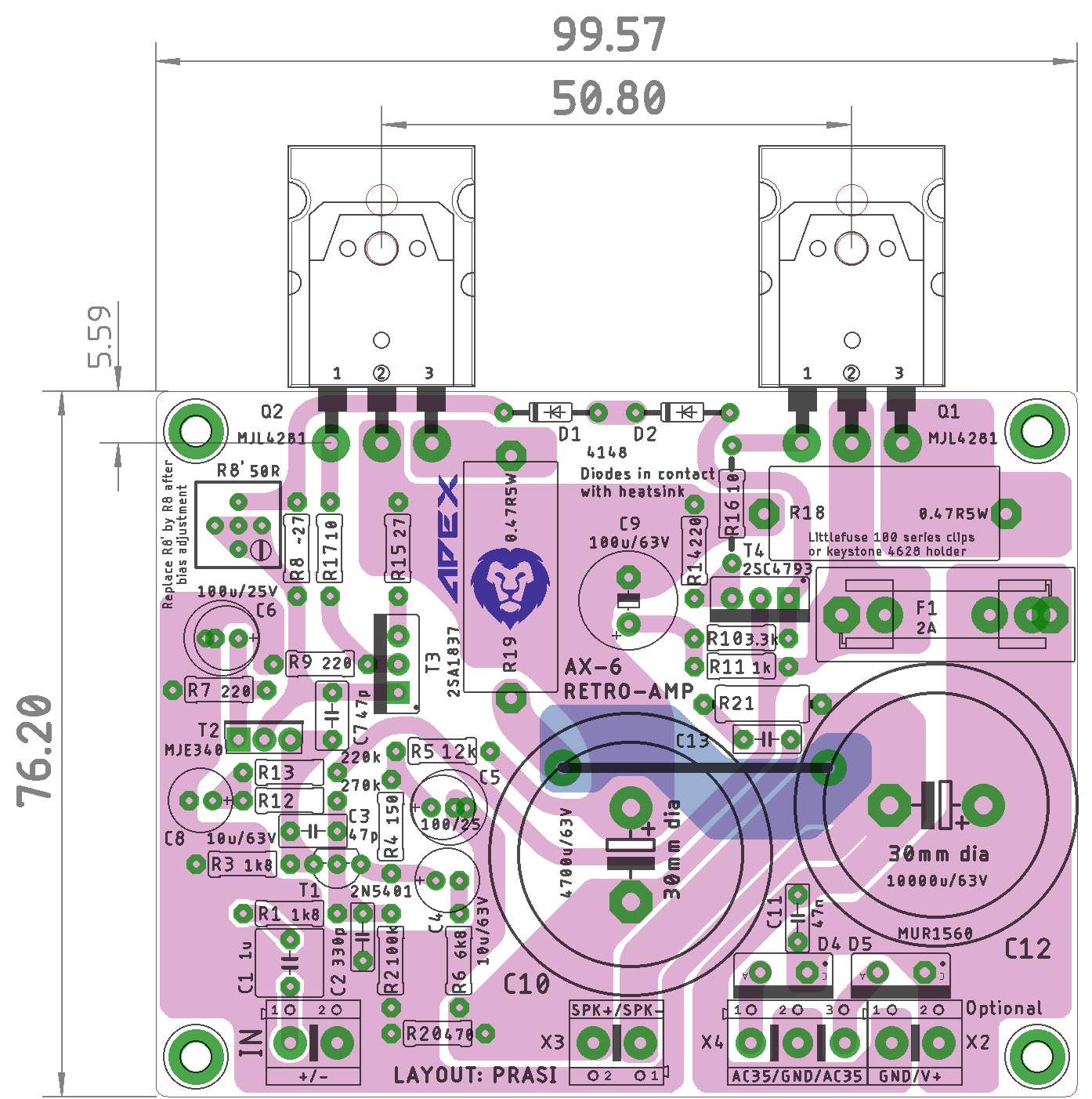

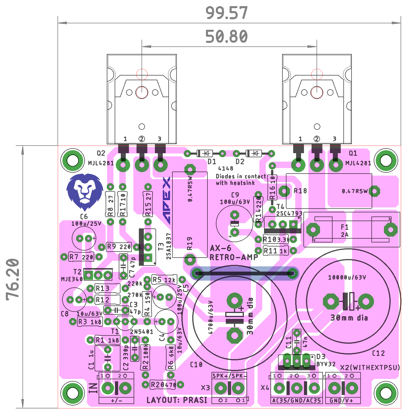

Retro Amp 50W Single Supply
Here is a version with MJL4281 devices in TO-264 and also NJW3281 in TO-3P🙂. Also drivers can also be MJE15XX.
regards
Prasi

Yes prasi if your board supplier is local I would be interested in a couple. Since money transfer would be international, best if you make an e-bay listing and link it from here. Bare boards, I have semiconductors already.
Bruce, that op amp is no longer available. RCA is a naked name like Sunbeam, the fab factory was torn down decades ago. Not entirely off topic, it does have single supply. The AX6 design should be able to drive several pairs of output transistors off board if you put heat sinks on the driver transistors. My Ax6 has off board output transistors, I did put an inductor in the return from the temperature sense over there on the heat sink to prevent oscillation from occurring. Also space the base drive wires away from the temp sense wires.
Hello Indianajo,
Thanks for your interest.
regarding PCBs, I was thinking more on the lines of getting 10nos. of PCBs with nice double sided , red masked from China. Local manufacturing for small qtys is costly as they charge development charges. Its only cheap if we go for higher qty.
ebay is not not possible for me, as I am only going to produce 10 nos and moreover, to register as an ebay seller in India, one needs to have a commercial tax number (GST no.) from Govt. of India..... Complicated!!😱
I have been using paypal for accepting and paying money without any issues till now and made many transactions with no issues whatsoever.
If the demand goes to more than 30-40 nos, I can get single sided PCBs quickly manufactured locally.
regards
Prasi
P.S. the 'list'
1. Prasi 2 nos
2. Member thro PM 2 nos.
3. Indianajo 2 nos.

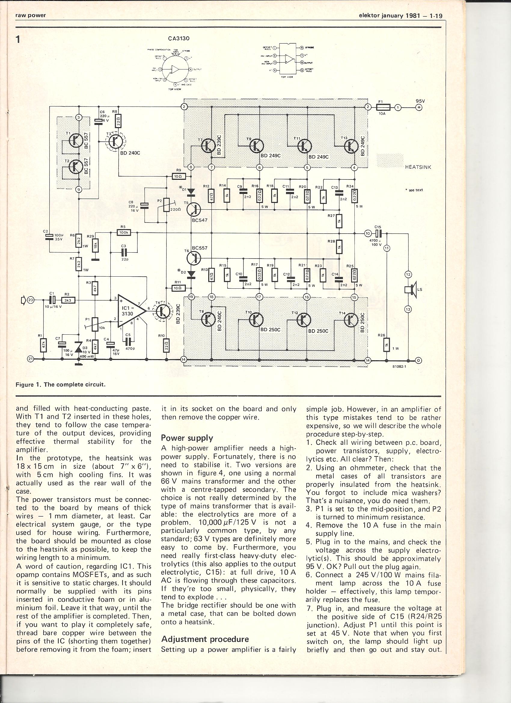

Has anybody built this beastie from Elektor January 1981😱
Mouser still offers this CA3130, now made by Renesas/Intersil, both in DIP-8 and SOIC cases.
Quite a strange design, though, with that thermal compensation by controlling the predriver's current.
Perhaps the output cap isn't drawn on the schem? Or the schem is drawn with the intent to "confuse".
It is a dual rail amplifier, but without the ltp front end. It doesn't need an output capacitor. And yes, it is drawn somewhat confusing.
Best regards!
It's drawn as it is a dual-rail but I fail to see how exactly could the bd240 bottom output pair driver get the "negative" swing required at its base for dual rail operation - and this with all the bootstrapping going on there (imho it can get only a diode-drop + VBE mult drop below the bc441 collector). Most likely a sim would clear things up but ... not at this time.
Hi Parsi, do you have a BOM for the #261 board on offer? I order through Mouser
I havent made a bom yet, if I end up ordering the boards, then I will prepare one and share here. I was planning to use whatever available in my parts bin otherwise.
regards
Prasi
P.S. here is the final ver. with some additional options like zobel, regular 2 legged diodes, cap options, etc

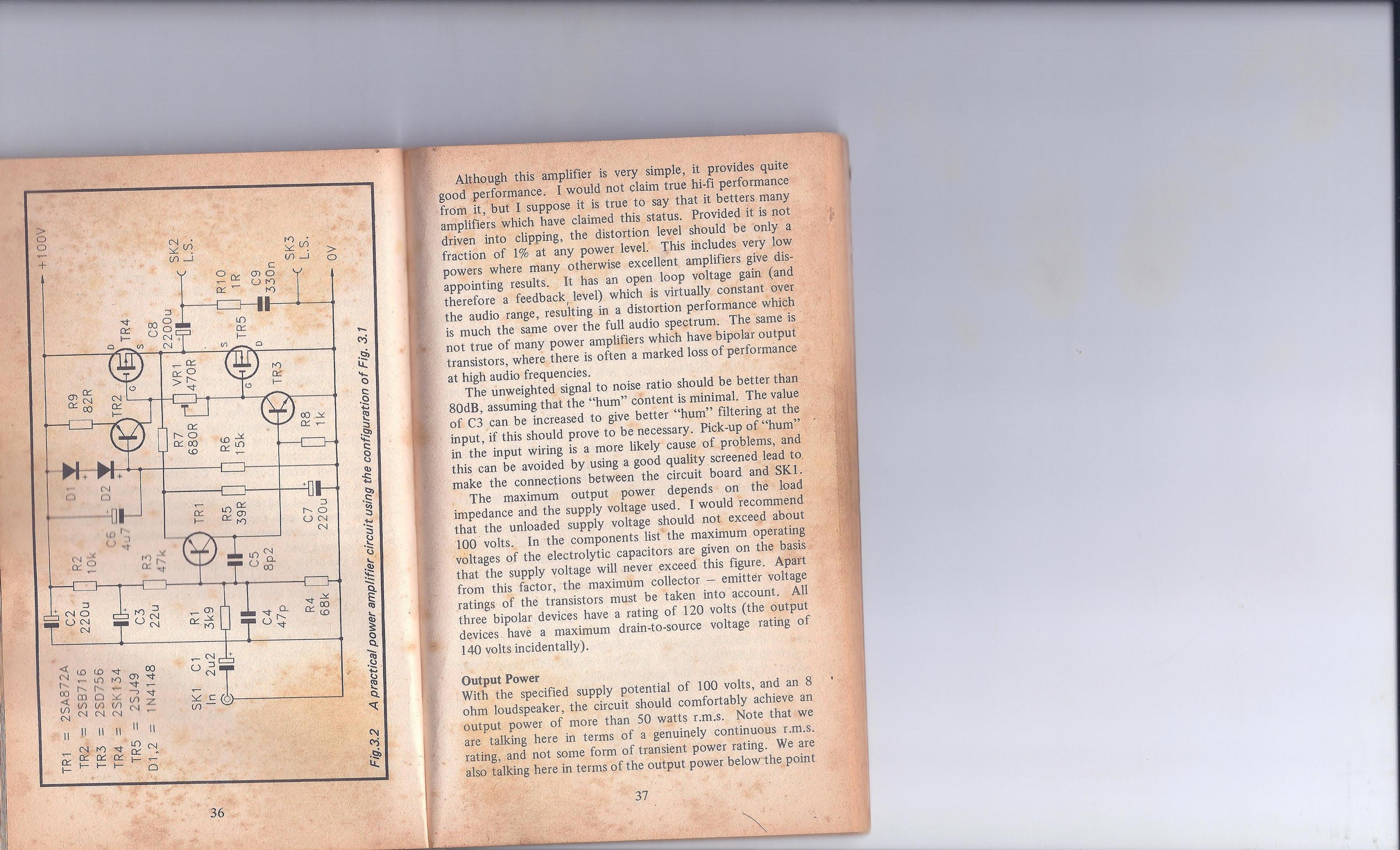

The Autona AL125 was a single supply of 80v. If you replaced the 2N3055 with MJ15003 you increase the voltage to 90v. The speaker coupling capacitor was not shown in the circuit as unlike the AX6 it is not mounted on the board. Nigel I did build the 225watt Maplin circuit and it worked well but I just could not get the bias current to adjust, but personally I still prefer the AL125 sound
