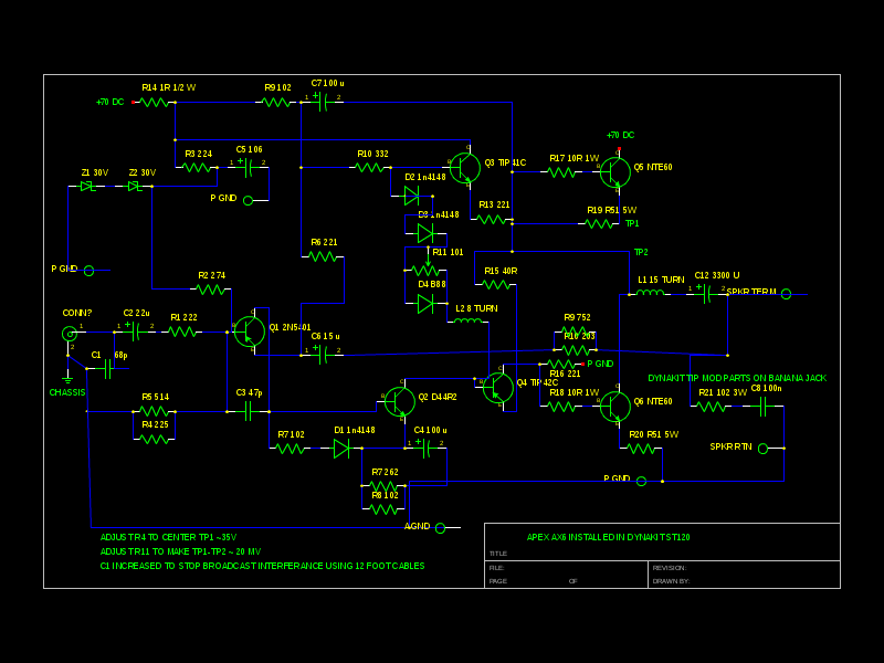

The gain is very high more than I want. The midpoint voltage, input of output capacitor, tended to be 1/11 of the rail voltage, so I moved the emitter resistor of the input transistor to a diode above the emitter resistor of the VAS, which I increased to 900 ohm. I then increased the pulldown resistor of the base of the input transistor to ~400 k which got the center up to almost half rail voltage. So 30 v music peaks (ha, but my speakers will take it) won't clip.
Sound is very good. No clipping detected up to now. I think having the center voltage too close to 0 might have been a problem. It is almost silent without input.

I'd like to decrease the gain, but am unable to read Mooley's sim diagram to determine which functions the resistors R16 and R18 that determine the gain, have. I tried increasing emitter resistor to ground of VAS (my Q2), to 2.2k but it didn't help the loud gain. Decreasing value of global feedback resistor didn't help either.

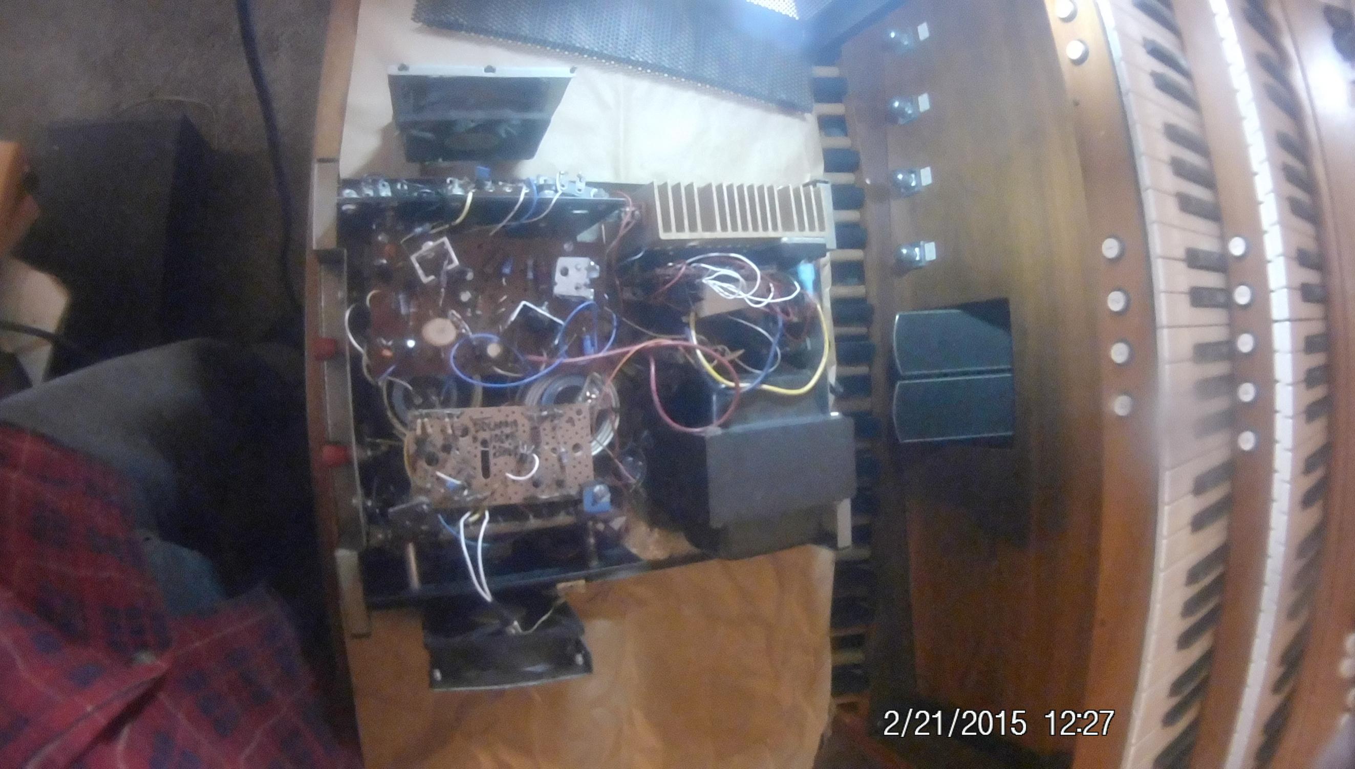

AX6 fits on a 9 cm X 13.5 cm board, very compact little circuit. OT's are remote from driver board on the old dynaco heat sink 4" away by flying wires. No RF pickup or oscillation resulted. OT's are NTE60 bought 1992, equivalent maybe of an MJ802. Bias spreader diodes and pot are mounted on the heat sink too.
All TO220 transistor have heat sinks, and there are PCAT fans on the output heat sinks. For ultimate thermal stability, the discarded ST120/djoffe board blew a transistor and went to 220 mv/0.5 ohm idle bias current, but didn't blow up output transitors.

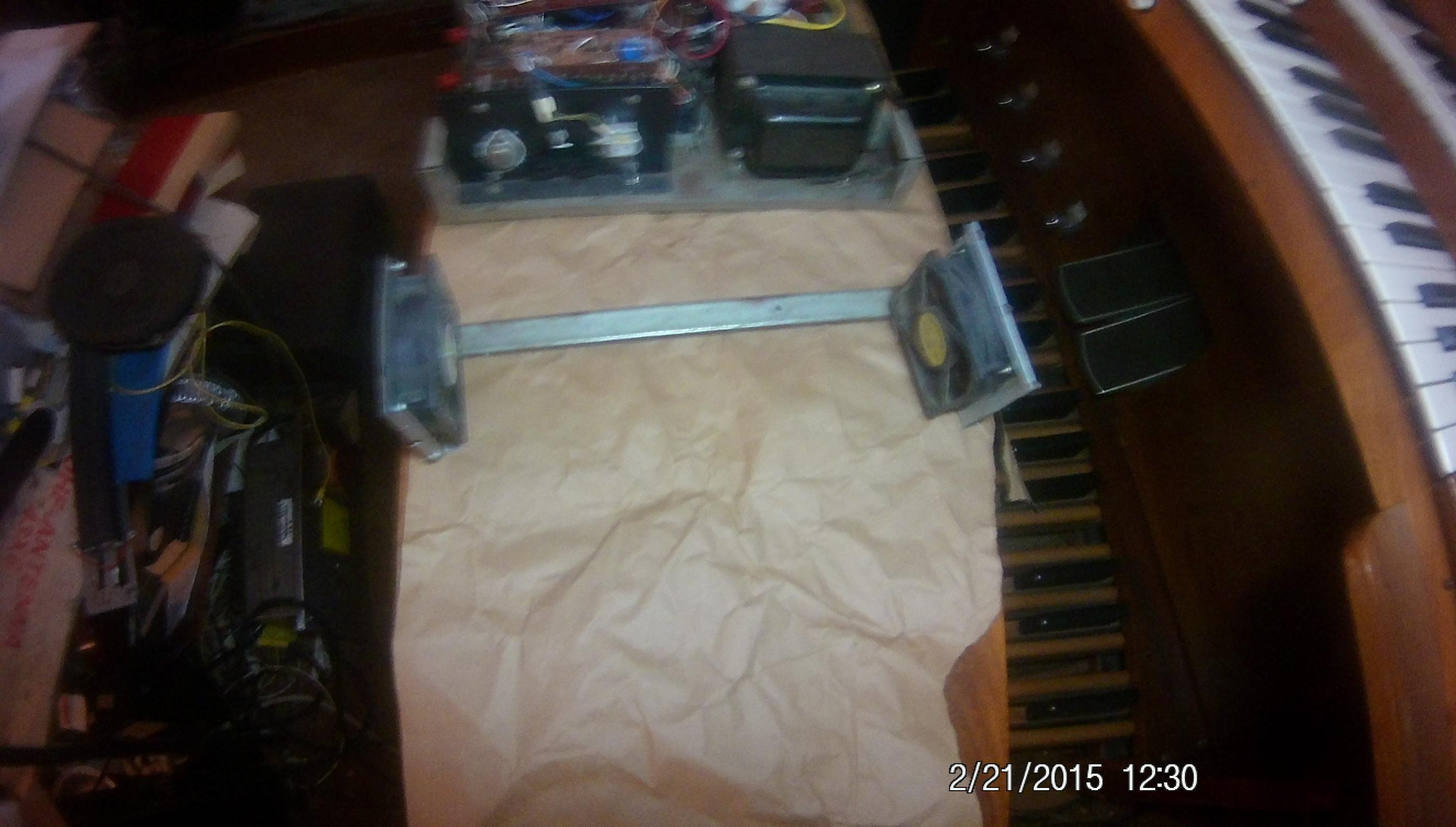

With fans My output transistors are just barely warm on a 3 mm thick AL flange. Up to 14 hours per day use. Idle current set to 8mv quiet, up to 85 mv loud.

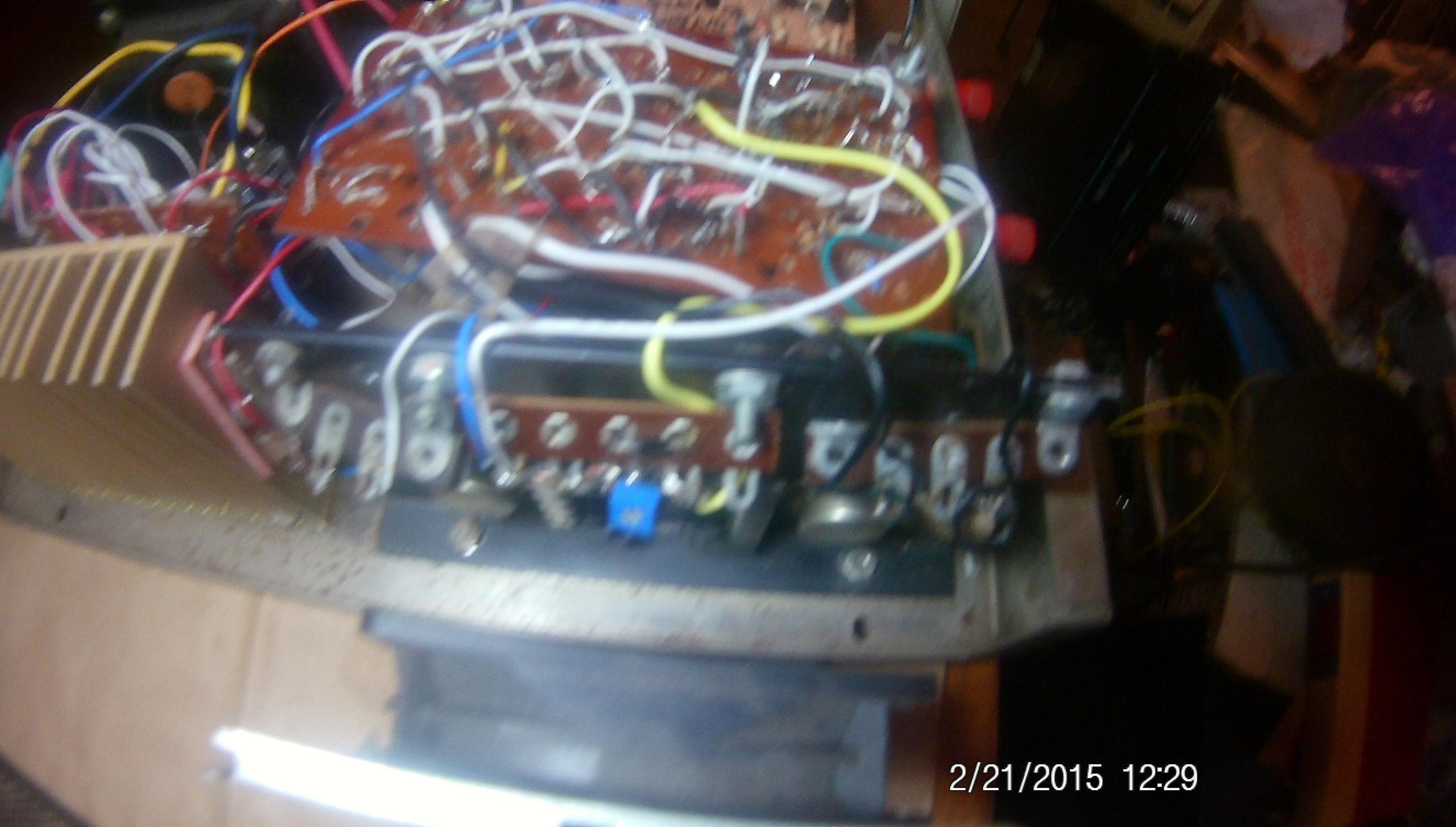

First picture, the dynakit ST120 overview with fan accessory, one AX6 board top, one dyna PC15 with djoffe idle current control accessory board bottom.
Second picture, the fan accessory removed from under the amp. Two PCAT power supply fans run at 9 v instead of 12 v nominal, from a wall transformer.

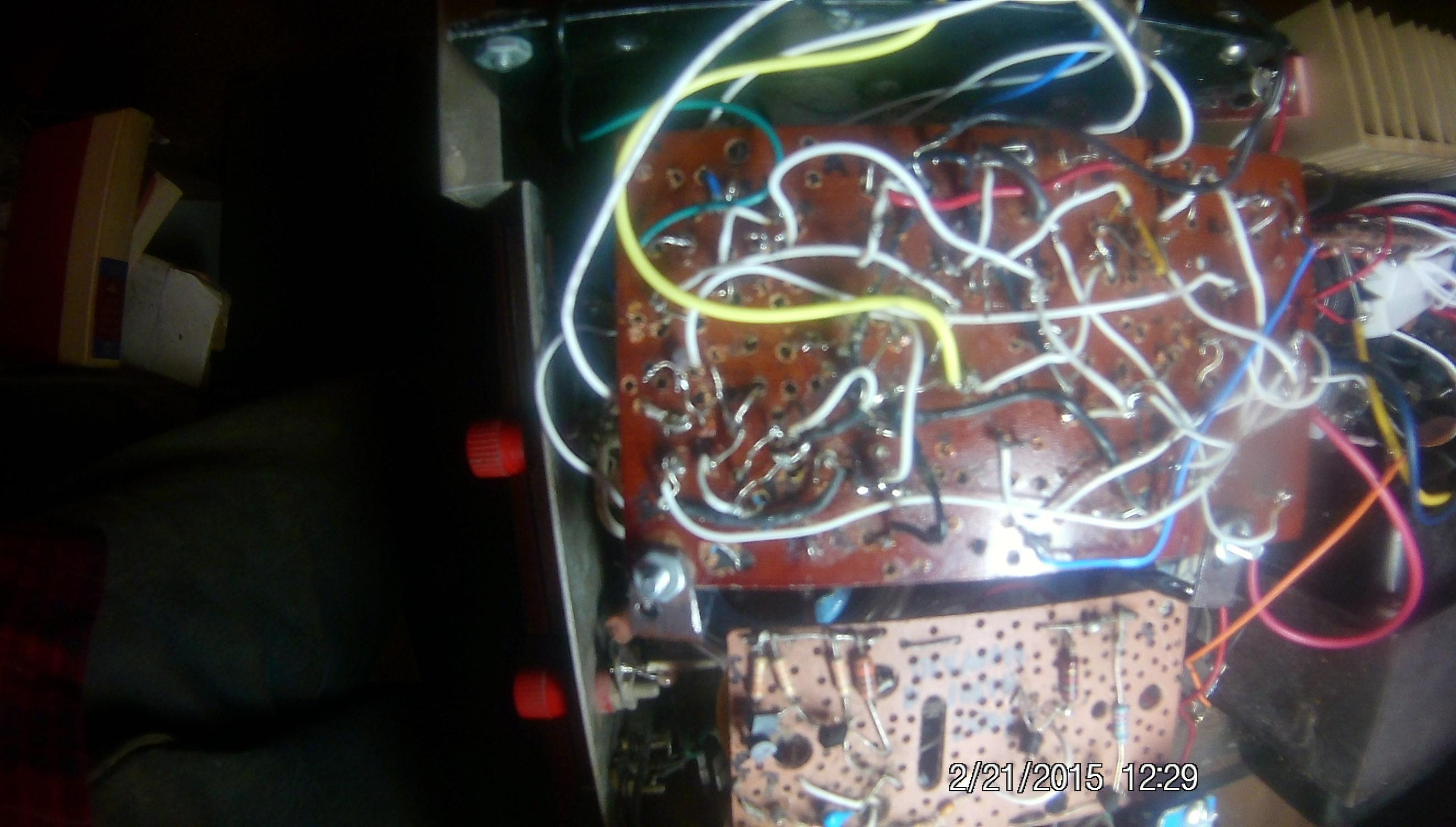

Third picture, the point to point AX6 board, component side. Nema CE laminate.
Fourth picture, the point to point AX6 board, wire side.
Fifth picture,left the OT current test points, middle the idle bias diode stack & pot, right a ground test point, mounted on top of the OT flange.

Sixth picture, the AX6 schematic as modified by me to center the output quiet voltage 1/2 of regulated supply voltage, for best 2nd harmonic minimization. Also the 68 pf input cap kills radio stations from coming in on the 3 m RCA cables from the RA88-modified mixer.
