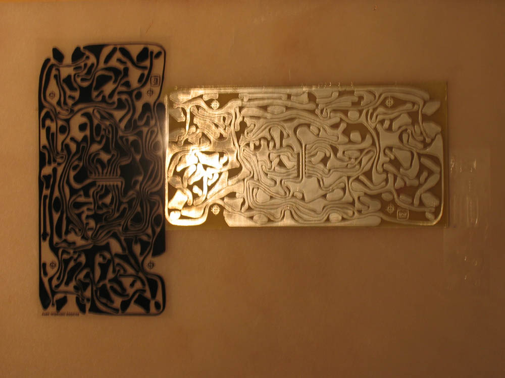

A new Driver PCB for Crown DC300A
I cooked up some pcb's last night to replaced the crown boards. The driver board is almost the same as the orriginal but I tweaked a set of pads for the new potentiometers to fit. I made some output boards but when I compare them to the orriginal Crown's, jeez the copper is so thick on them, I gotta keep them! So I'll strip them and remove the flux and gunk and I'll plate them with tin and they should look good as new.
Looking closer at the components on the orriginal Crown driver board, I just have to tip my hat to those folks back in the 70's because the components are top notch. Most caps are film foil or Mica. The mica's are 5% or 2% tolerance.
More to follow...
Shawn.
More to follow...
Shawn.
Poor pics
Yeah thats pretty bad. 😉 Perhaps Santa will give me a nice SLR with macro options and a real tripod for Christmas this year? While I'm at it, I need a new color laser printer.
Can the ol fart do any thing for the shakes?
I'll post better pics tonight when the 3 piece set is done.
Shawn.
AndrewT said:I hope your boards are better than your camera/photo taking technique!😉
Shawn.

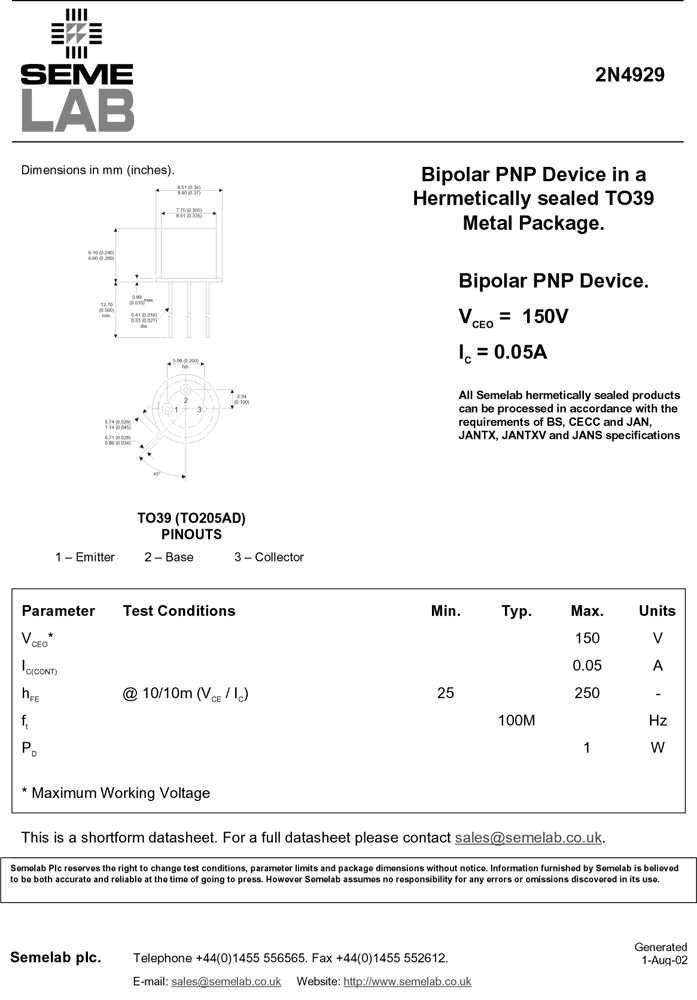

Hi Shawn,
I used to use 2N3440 and 2N5415. I think they are still available.
MJE340 and MJE350 will work.
-Chris
-Chris
Looks good and no pin-out changesanatech said:Hi Shawn,
-Chris
EchoWars said:Zetex ZTX795A and ZTX694B.
More money perhaps? Zetex = High -end? Do they fab or package select die components. They are mentioned often around here but I have never seen.
anatech said:Hi Glenn,
What case style are those in?
-Chris
The Zetex are TO92 and would not dissipate heat as well as the TO39.
Shawn.
Zetex = British. High end? As opposed to what? Low end? I'm confused...
Those small critters can dissipate 1W, just like the originals, and you can put TO-92 flag-type heatsinks on them if you're overly concerned.

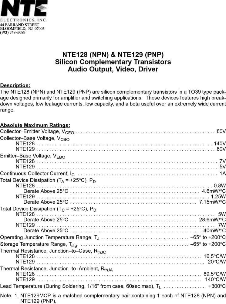

FairChild NSD128
I think these did end up as NTE128's but the spec's have changed. I don't know who is right. This one is my biggest thorn. Any suggestions? Thanks.
Shawn.
TomWaits said:These are trouble at Q104 and Q204
Part Number = NSD128
Description = Si NPN Power HF Bipolar Junction Transistor
Manufacturer = National Semiconductor
V(BR)CEO (V) = 180
V(BR)CBO (V) = 180
I(C) Abs.(A) Collector Current = 250m
Absolute Max. Power Diss. (W) = 1.7
I(CBO) Max. (A) = 50n
h(FE) Min. Static Current Gain = 50
h(FE) Max. Current gain. = 500
@I(C) (A) (Test Condition) = 10m
@V(CE) (V) (Test Condition) = 5.0
f(T) Min. (Hz) Transition Freq = 100M
Status = Discontinued
Package = TO-202AA
Military = N
Looking for subs,
Shawn.
