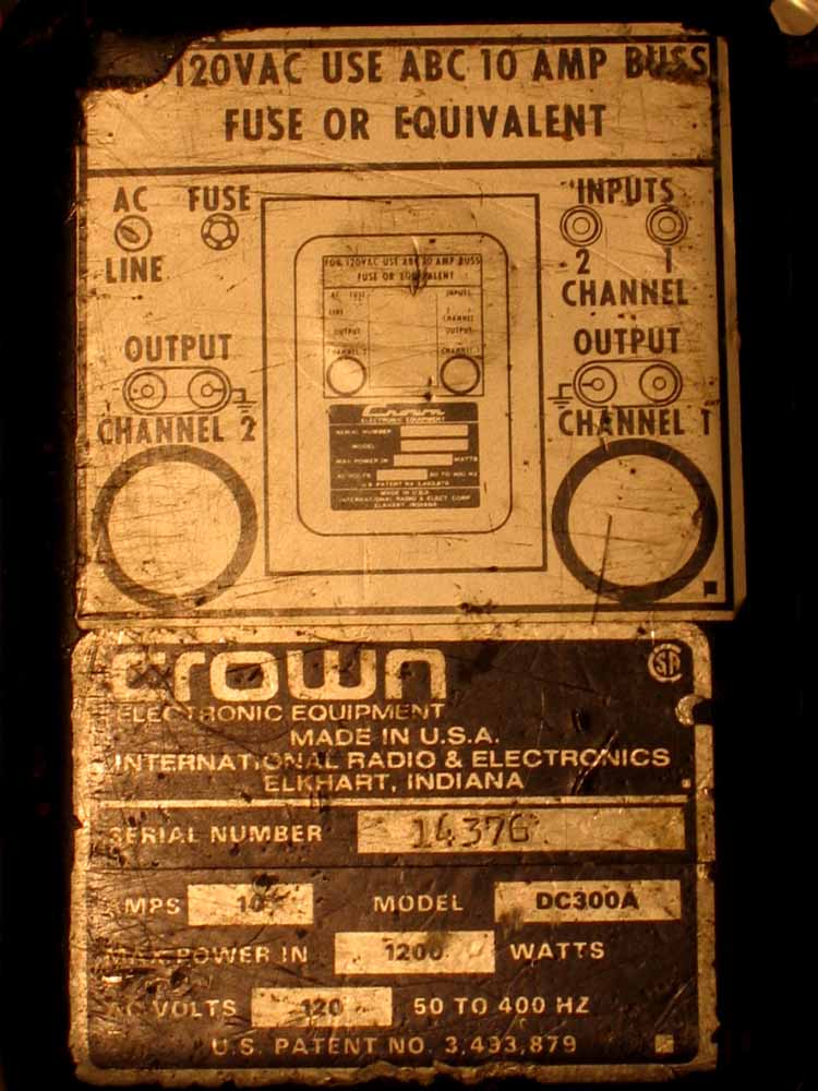

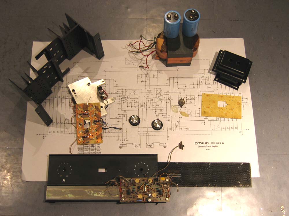

You've mistaken me. I'm the kid! Doing this makes me feel like I was a kid again. I remember putting a bid on a set of amps in Glace Bay, Nova Scotia. This older chap was selling his pride as he was hanging up his dreams and getting a day job. In the pile of goodies was a Crown DC300A mounted in the Crown enclosure. That was my first sight of DC300A. I didn't buy it because I purchased some new junk from the music store. I was 16 years old. I remember it like it was yesterday.
To pick up a DC300A (vintage '75) for free in the basement of a dirty old pub? Dream come true, might as well be written in the stars! For me it is all fun. No I'm not a kid anymore but having the skills and knowledge to do this and then actually apply it? Man, I can't think of anything better in the world I'd rather be doing. Well there are a few other things but they don't last all day. 😉
If the DC300A sounds like a sheet of glass then damn yee all, I'm going to make it the best sounding piece of glass it can be. I'm behind the mule and I've got my hands on the plow. Get out of the way naysayer's, I'm coming through....😱

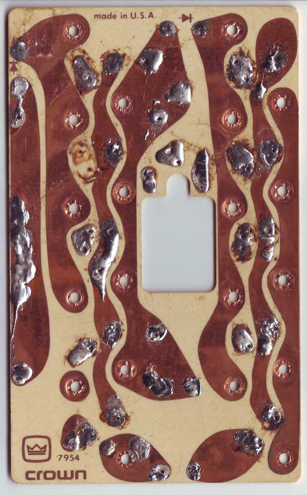

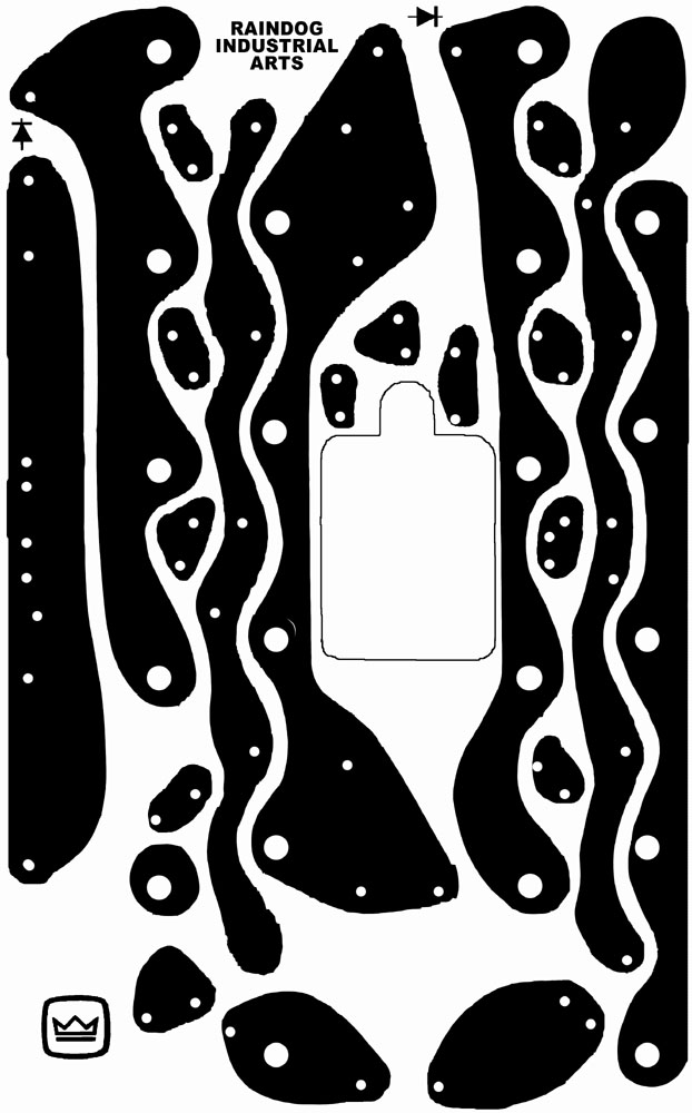

The road less travelled...
When I'm done my work with this boat anchor any DIY'er out there with enthusiasm and a DC300A will be able to restore their amp in a fraction of the time. We are going to pave the road for them, right here, right now. As you can see, it has begun.
