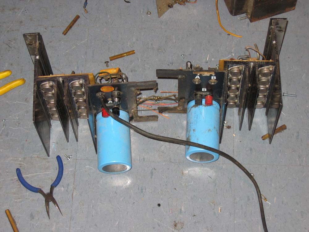

I'm done for the night dismantling but I will clean it up a bit and in the morning I will remove the transistors and the output boards.
Can you folks suggest a test jig for 2N5631?
The output transistors are marked:
M (batwing logo from MOT)
2N5631
Mexico
9348
Going down each bank of 2N5631's in the middle of each row is a TO3 faintly marked
C5869-0
#1
What is the scoop on the middle TO3 with this marking? Perhaps I should look at the schematic now?
The PWR supply caps are marked 17,000uF @ 75VDC
The bridge rectifier is marked
SDA990-3
SI 7519

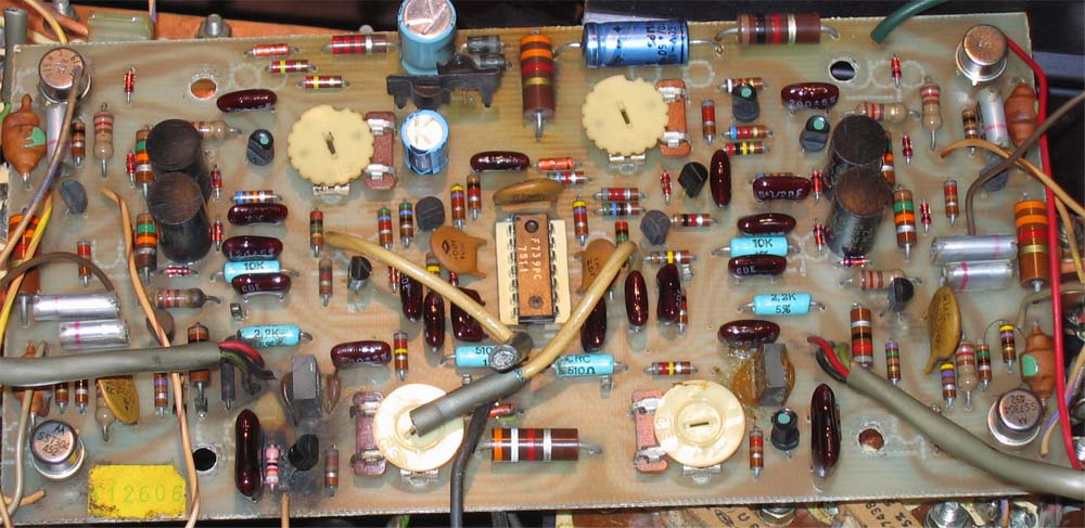

The output stage could use something like Mj15003s. These are cheap, have higher gain and are faster than the original. There are better TO3's around but the price-performance balance applies.
I've made a list of all the transistors in a table. I'll offer some suggestions soon (FWIW).

Heat Sink
The potential power available from this old set up seems to overwhelm the heatsink/chasis set up of this amp??? Perhaps the power supply drops down a large percentage under full load? I will test and provide DC RMS values to see where it sags to.

Power Supply is Very Good
The XFMR measures 54-0-54 VAC unloaded
I rectified it and filtered it through 30,000uF per rail and measured +_ 62 VDC
I loaded each rail down with 10 ohms and measured +_54 VDC @ 5.4Amps per rail. The XFMR did not warm up at all during this test.
I don't have a smaller load to test it with. The back plate of the ransformer says it draws 1200 watts (not VA) I think it is Beastly. This transformer rocks. No humming or buzzing btw.

Re: Power Supply is Very Good
Hi Shawn,
The unloaded DC voltage seems about 10 volts too low. You might want to try that again with a different DC section.
Cheers
Q

Well i went to bed art 12 last night and now when I wake I find that you are really busy !
The design as you can see is AB/B and cropwn have always quoted distortion figures on this amp in a wierd way! saying it below ? at 50 mW and below ? at 180 watts I suspect a little glitch or so around the 0.5 watt level ?
Can not one of you guyscome up with a current duming type of scheme to get the figures really low
About 30 years ago I produced a large no of AB/B amps for a ocal heavy rock disco using this Idea and when I loaded the amps at about 2ohms the tranfer function could be seen to change as the booster s came on.
I never did clear that one this was a year or so before the Quad 405 was laubched
So I see the Crown Dc 300 as an improved version of that scheme at the time

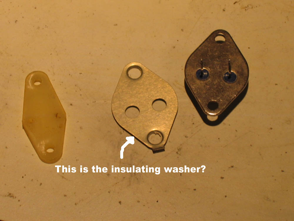

Insulators are hard-anodized aluminum, do not scratch.
Original outputs are epitaxial 2N3773, 150W SOA at 100V. Do not use 2N5631 or MJ15003, the MJ15024 or MJ21194 are fine.
Original main filter caps were 13,500µF at 75V, and ran at ±67V.
The 10µF filter cap in the voltage doubler circuit goes bad all the time, also replace the current source transistors in this circuit. The zener diodes that power the µA739 frequently fail.
Crown has always used inductors in the base circuits to reduce oscillation, even in their newer amps.
