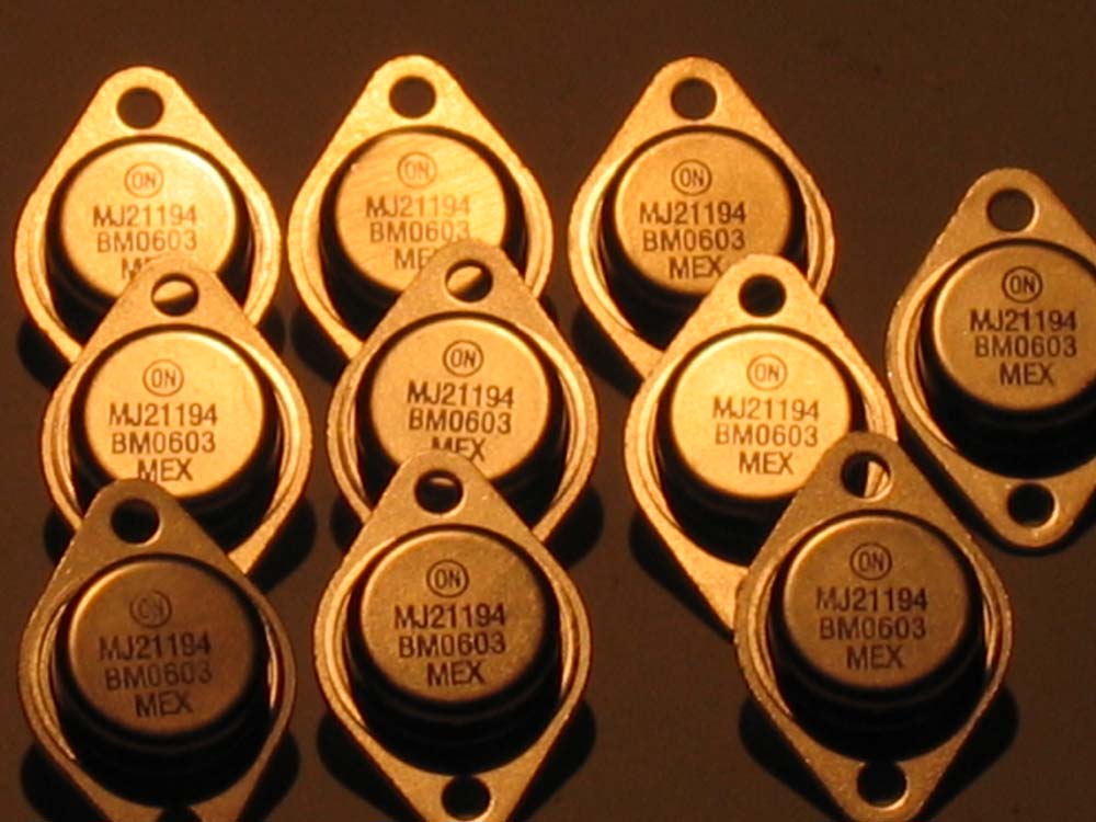

I had a rendezvous today to pick up the On Semi Outputs but only half of them showed up after losing the previous shipment?
Ouch! The rest have been taken care of (?) and here is a pic of the new kids on the block. Just another little delay.

Hi Shawn,
That's a happy looking crowd there. I'll bet they are looking forward to making music. 😉
-Chris
-Chris
Happy Looking Crowd...

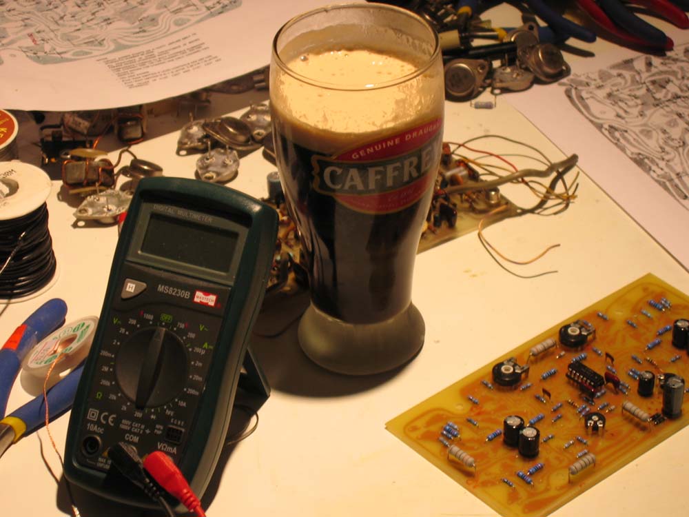

I wish they were from the same batch? I'm certain a totally different date code will show up in the next shipment of 10. In this design it may not really matter but still...? Kinda sucks?
I picked up most of the remaining semiconductors today and the balance of passives. I just got home and the soldering iron is warming up and the beer is cooling off.

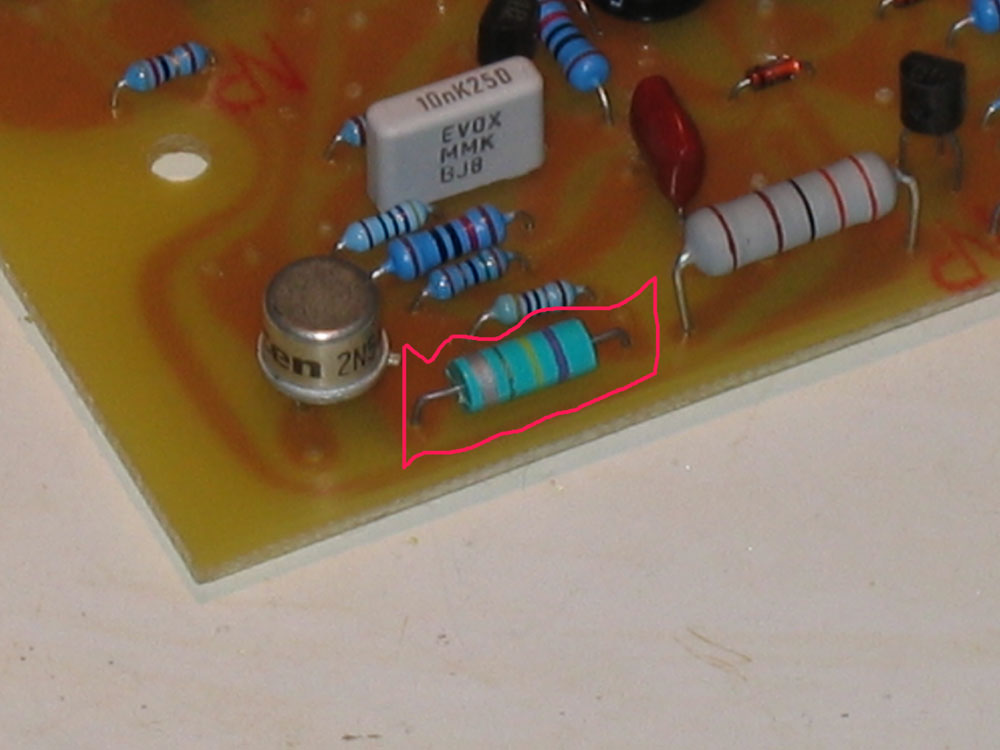

anatech said:Hey Shawn,
Look'in good!
Are those Philips resistors?
-Chris
I remember ordering direct from Philips when they were located in Scarborough (Toronto). I used to expedite billions of pieces back in the day...what was the lead time when I finished that gig...1995...32 weeks!?
I don't know who makes these but they are "good" quality 1% from the Orient. I think the Philips I used to order were from Malaysia back in the mid 90's. I think these are from China but I'm not 100%.
Lately, I've been eye-balling the .1% they now stock at Parts Connection (PCX) but not for this job, not yet.
Shawn.

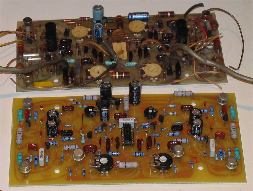

quasi said:Sorry Shawn but by the looks of the photo of the input and driver board, I would replace everything....xept the inductors (why the .....have they got inductors?)
Cheers
Q
See the new inductors!
Just for Quasi's peice of mind!
