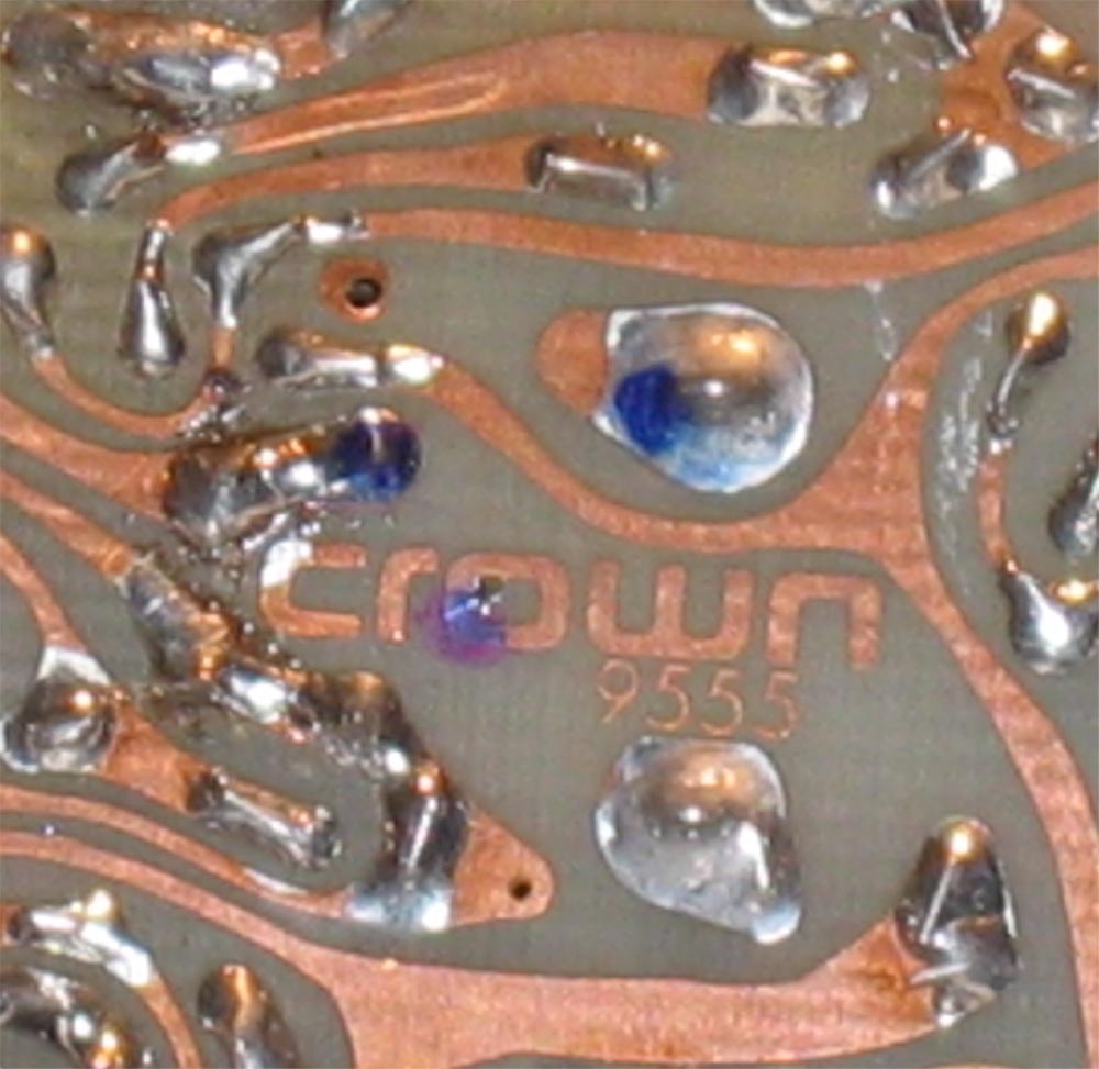

Shawn.
burnedfingers said:Shawn,
Nice pictures. What is the board number?
Date code of 1993 on those outputs.

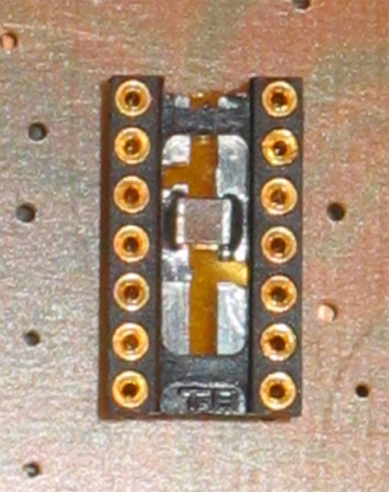

uA739
I'm going to use uA739DC on my first time around. I'll be sending some quid to krmaudio in a day or two to hook up with the ceramic option.
I'm very interested in substituting this opAmp with better technology so I'm listening very hard.
The machined T&B 14pin dip socket I have has a decoupling cap across 14 & 7 of the rail supply. Should I disable it or will it be fine running in this design?
Shawn.
Shawn.
Decoupling will be fine. Pin 7 and 14 are the B+ and B- supplies.

burnedfingers said:
I need the board number. Should be either a 7958 or a 9555. Circuit 9555 was used with Fairfield or RCA 1Bo5 outputs.
Check R107 and R207 will be 3.3k with IC uA749 or 10K with IC uA739
Big differences in parts with different outputs and IC's.

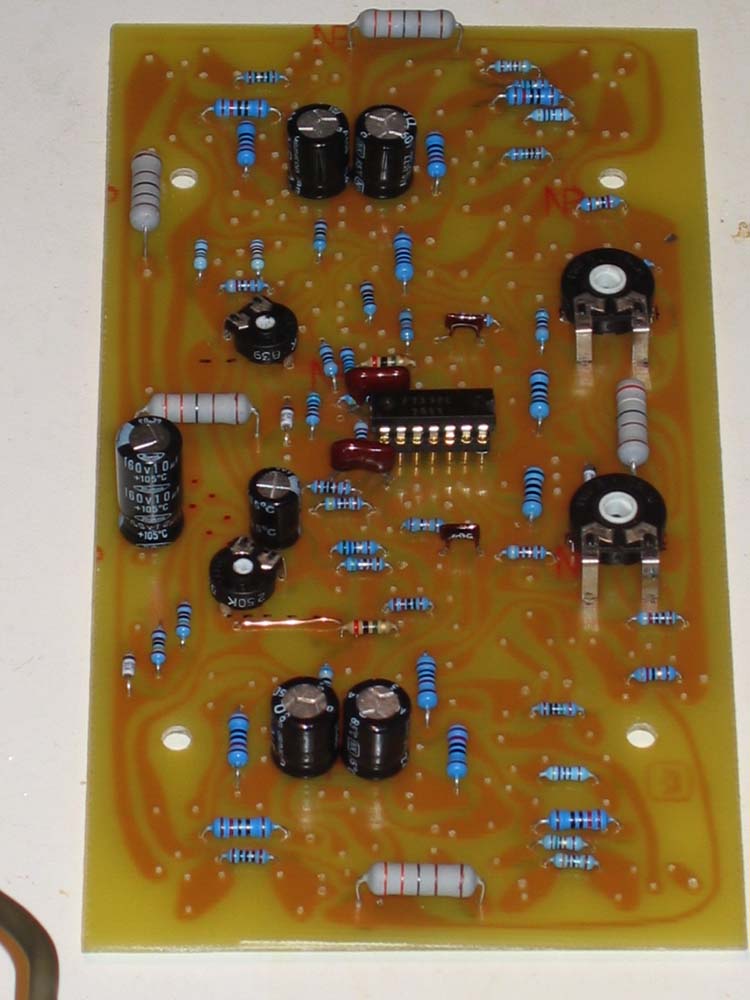

New Board
The new driver board is shaping up. As I loaded the resistors I compared them to the ones in the old board. A large percent of the old R's had values measuring 20% or higher than the indicated resistance on their color bands. They are supposed to be 5% to 10% tolerance. So in this case, it is not just the caps drying up affecting the sound, the entire amp must have been drifting?
I'm certain the sound quality will be night and day from the before and after when I'm through. All of the new R's with the exception of two will be 1% (not including the output emitter R's, they'll stay at 5%).
It's been a long night. Should be lots tomorrow and in to the weekend.

How long did it take you to get your back unclenched and your eyes uncrossed after drilling that board? I always hated drilling my homemade boards - almost as much as dealing with the ferric chloride. I finally ended up putting a Dremel drill press at eye level on a couple of boxes, and I was able to drill boards without looking like the hunchback of Notre Dame afterwards.
The end result in your case is looking pretty professional, though I would maybehave chosen something besides the Piher-style pots for adjustment. Maybe that's just snobbishness on my part - the ones you chose will last a lot longer than the open-style crud you see on a lot of commercial boards.
Current address
I drilled it out in an hour. I was comfortable, the press was clamped to a countertop, I used fluorescent back light over my shoulder from behind and took a couple of deep breathes occasionally. It went well but for similar reasons to yours, I think I was avoiding the drill for a couple of days. 😉
I personally think the boards I am making are crude but I also think of most of my projects as prototypes on my first approach and that if the end result is good enough, and then I will later revisit with higher standards and more money. I’m glad you think they look pro and I guess if you compare them to the original then they are.
The pots I used were drop in replacements for the originals but something went wrong on one pair and two of the four showed up smaller than what I wanted. My final goal is to restore the amp and try hard to keep the original PCB layout. If there is a next time around I’ll certainly cut a new layout in a CAD program and optimize the set up. Change the OpAmp & the output board too. I don’t know if that is ever going to happen? It would be a lot of fun but for what?
In the end, I think I should be able to get it all done for under $100 Canadian and if I purchase the new decals and id labels it may go up to $200. If it runs as well as I think it could, at that point I’ll decide if it is worth spending the extra cash on the labels and decals. I’m optimistic and I am anticipating that it will be a full deluxe restoration, right down to the stickers and date codes that were inside the chassis. Doesn’t that sound like fun? I’m having a lot of fun with this anchor. 🙂
