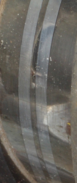

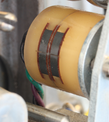

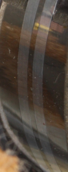

The heads look OK, from the degree of zooming I can do on those pics. The horizontal space in the record head is normal, and record heads DO have a wide gap. The erase head has an even wider gap - its not a fault.
The light flecks i assume are dirt or dust. If they are holes or corrosion in the pole-piece, thats a worry.
