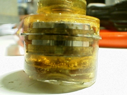

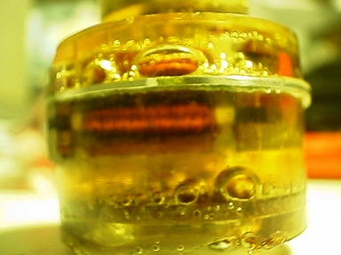

It is a very good thing I did not send the old heads off to be relapped, unfortunately the playback head is bad. I measured the inductance after removal and the right side which is good measured 465mH and the left side measured 415mH which is well out of tolerance based on prior experience. The record head measured virtually identically on both channels at 33mH which is close to the expected value.
The QC on these heads was not the best, the epoxy encapsulant is full of voids, and tellingly the left channel of the playback head has the worst one..
Those pretty shield cans hide a multitude of sins unfortunately. The QC definitely appears to have slipped on these heads - I've never seen worse on a ReVox, and sadly there is relatively little wear to the head surfaces so they died before their time.
There also appears to be a considerable amount of corrosion (actual rust pitting) on a small area of the surface of the left channel pb head - it isn't oxide left from old tape as I originally thought. It might be a metallurgical defect or similar as there is no evidence of moisture anywhere in this machine.
I have included a picture...

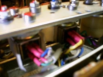

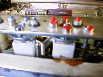

Here is a picture of the head assembly with the new heads installed and in the deck..
Note that the protective covers are in place until I start to do the actual alignment.
The new heads are far better than the ReVox in terms of their finish quality and build quality.
You can just see the edge of the original erase head which is still in good shape.
Here is yet another picture showing the back side of the heads and the new terminal clips which are quite similar, but better quality than typical cartridge clips as they actually have small spring contacts. They are gold plated and easily soldered as long as you use a work holder or similar to do it.
Good results ,but terrible out of focus pictures. In the first pic, I only can see the air bubbles in the epoxy.
miklos said:Good results ,but terrible out of focus pictures. In the first pic, I only can see the air bubbles in the epoxy.
True unfortunately, about the best I can do without a tripod with my 10 yr old camera. They're low res too..
The bubbles in the epoxy were exactly and the only point of that first picture.
