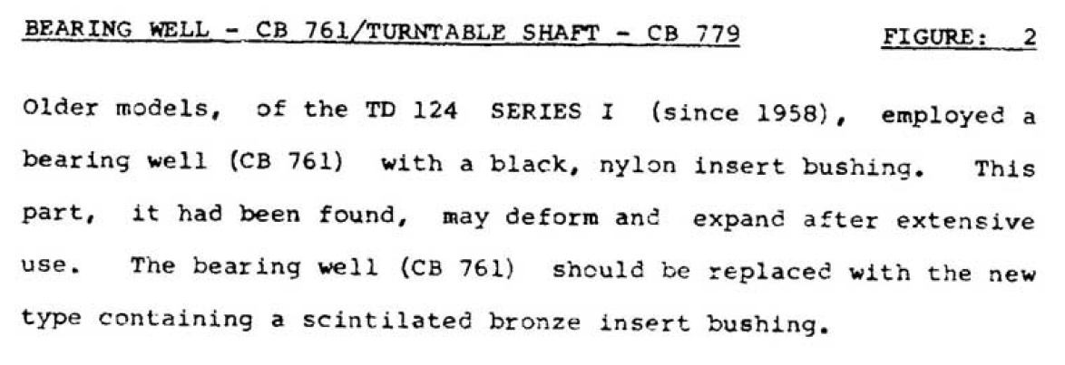

If main bearing is nylon bushed they are noted for seizing. Given the serial# this is possible. Recommend replacing the bushings with sintered bronze.

I've run across at least 3 tables with bad nylon bushings where the bushings had expanded sufficiently to seize to the spindle. The spindles were generally significantly scored at the edge of the bushings. In at least one other case a table fitted with nylon bushings ran slow regardless of eddy current brake setting and all of the other usual suspects - in this case replacing the bushings resulted in a table that ran well after some initial adjustments.

My instruction book is in French/German, but in English translation this is what it says: "First version: Nylon bearing (black and shiny) only use silicon fluid Rhodorsil X 58 (Rhone Poulenc) or General Electric Silicone Fluid F 50". I think that is specific enough.
