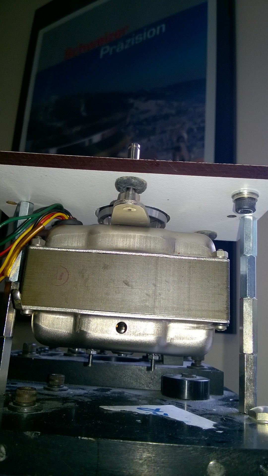

Encouraged by Nigel started with experimenting with a magnetic floating motor trust bearing for the E50 motor , work in progress.
Just find the centre of the stator field. Easy to do as the motor will pull up or down when energised. Make it slightly pull down. The motor on it's side makes it more obvious. Should be a big difference on transmitted vibration. My patent on this was never filed. Greenwich University ( old Navy college ). Should be doing a new project this year with them. I am an electrical engineer who is allowed to work at degree level in mechanical engineering. I woke up one day and realised I am totally unqualified. Time served and in a similar field seems to be OK. George Stephenson also. If he had of been qualified his bridges would have been too weak for modern 100 ton plus loco's. They still stand.
Do you mean magnetic suspension inside the motor ? Or the whole motor is suspended ?View attachment 550523

Inside the motor floating rotor !

This is a invention to run a inductionmotor after starting synchrone with the magnet on top of the rotor running in the statorfield.
At the E50 motor I have mounted the magnet under the rotor so it float its also outside the running stator field.

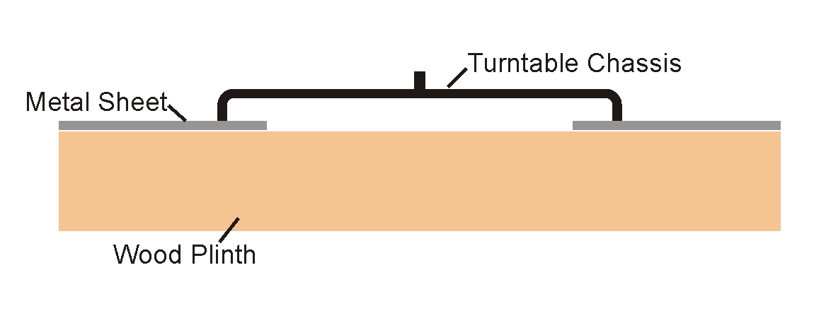

Just finished reading this entire thread. I don't actually own a thorens or any other idler turntable but am into all things vinyl. Most of this thread seems to have concentrated on bearings, motor and drive train. There are other areas that can be improved.
Many years ago I helped a friend restore a 301. The single biggest improvement made was the construction of a super heavyweight plinth. This was a 1/4" welded and powder-coated steel box with appropriate cutouts. This had 3/4" plywood glued to the inside. The cavity was then filled with multiple layers. These started with lead-shot loaded concrete and had multiple layers of reducing density ending in plaster of paris. The plywood had many screws protruding to anchor the concrete. The finished internal structure had a very organic look. The total mass was about 80kg and the resulting plinth was incredibly inert.
An other thing we did was to damping the chassis. We cut thick lead sheet to fit between all the cast ribs of the underside of the chassis. If I remember correctly we adhered these using a silicone rubber. This helped to paint a background to the music in blackest black.
Both of these methods should be equally applicable to a 124.

Both of mine are directly mounted to heavy slate (80lb) multi-layer plinths. The thread is mostly about sorting out the mechanical issues inherent in the table and not necessarily about end use. There is a not a lot of agreement as to what constitutes an ideal plinth for this table; many people use classic (low mass) plinths while others like myself subscribe to the high mass approach, still others use constrained layer damping (can do with mine as well, but not currently implemented.)
For a number of years I used 12" tone arms mounted on the plinth, these days I am using a pair of Souther linear tracking tone arms mounted on arm boards bolted to the tables proper.
Outside of the still poor motor warm up behavior of my MKII I am pretty happy with the performance of both of these tables. Someday I will go to the Papst motor driven by a 3 phase controller..
