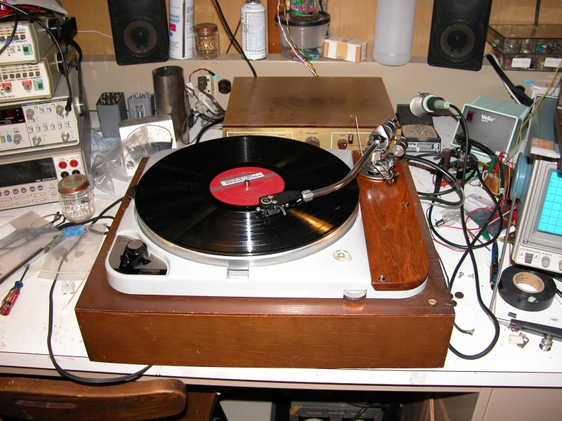

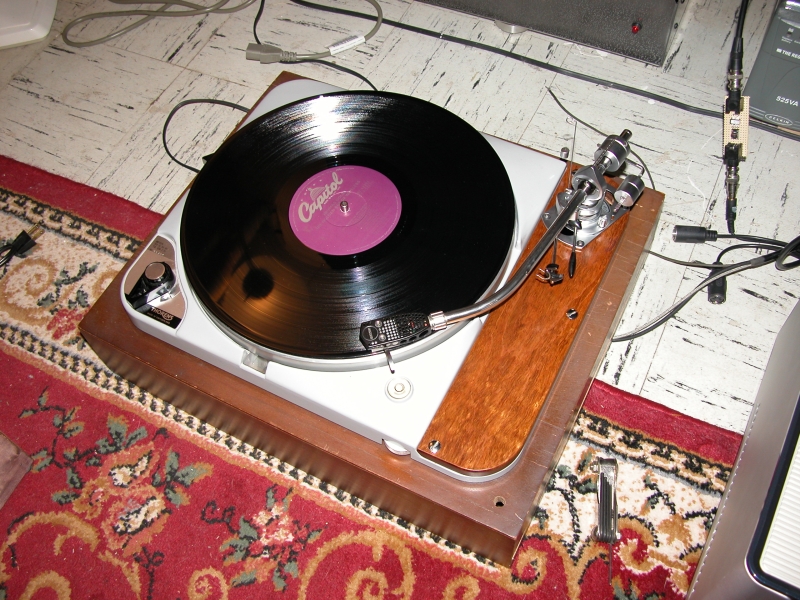

It's Alive!
Using some of my now copious free time I spent a few hours tweaking the table and then mounted one of my fleet of restored SME 3009 Series II arms on a Brazilian Cherry armboard - my god is that stuff hard! Success though with a minimum of fuss. Finding a compromise mounting position for the arm was more of a problem as I was not convinced that the commonly seen mounting approach with this arm on this board was right. I was not able to mount it the way SME recommends, but I got close enough and the geometry is good. Yes it's playing right now.. LOL
Surprisingly the original Stanton 681 cartridge is still in working order.. And it sounds ok, it however is NOT a good match to the SME arm it was in..
Next I swapped headshells for one with an AT120E in it and installed it on the floor near enough to the phono stage for the cables to reach. It sounded somewhat promising so I swapped in the ZU/Denon DL-103 and set up the arm properly for it. This actually allows a comparison between the SME 20 and the TD-124.. I'm still thinking about what I am hearing but a quick summary follows:
It is rather sobering to realize that the last record this deck played was 4 decades in the past. As I listen more and the deck warms up, I am not sure that it is not significantly better than the SME any more in some indefinable way. I can certainly live with this level of performance.
Some thought provoking comments, take note that many of the self appointed experts on the NET aren't. I have never gotten more conflicting and incorrect information about something off of the net, and former Thorens employees are not necessarily right either. Use your own judgment!
Something else quite sobering to realize is that someone designed a table 50+ yrs that would easily embarrass a few rather more expensive modern tables. Again it hammers home the point (in my mind at least) that in terms of performance at least there has been very little improvement at the cutting edge, perhaps at best it became a bit more economically attainable.
Edit: I'm listening to it, and I guess I will just say for once the hype surrounding this thing is justified.

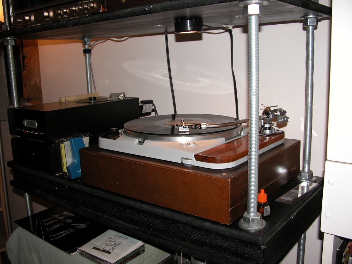

In System
The pictures attached should hint at what has happened here.. 😀
I've enjoyed having the SME 20/2 since this spring time, but the long term cost of acquisition is steep, and frankly (and very conveniently 😛 ) there are important aspects to the TD-124's performance that actually I prefer to the SME.
The TD-124 is very quiet, there is no audible rumble, and even noise at the lead out groove is tame by comparison to my old TD-125, and not significantly different from the SME. This thing is much quieter to be honest than I had expected.
Another unexpected area where the Thorens is clearly better is in the area of imaging and stage depth. Despite having exactly the same arm (type if not the specific arm) and cartridge the TD-124 recreates a more convincing performance.
This is not to say all is perfect, this is a slight midrange hardness I can hear which may relate to the stock SME cables I am using**, and I am certain that significant improvement will come with a better plinth, and in all likelihood a better platter. In the meantime I can work with what I have, and for me at least it is clearly an attainable improvement to my system.

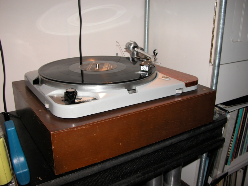

Yesterday I picked up another North American version TD-124 MKII (clearly marked above the speed controls) for a friend, and noted that this one also has an aluminum platter - this is the third MKII I have seen with the AL platter. I believe the story here is that these are all late production units made after the iron platters were discontinued. He picked up his new table tonight and as you can imagine he is pretty excited.. 😀

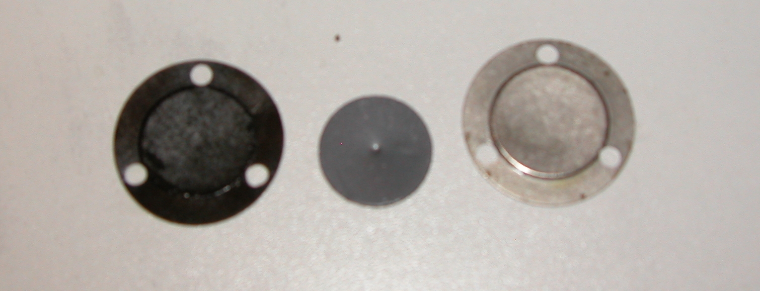

That belt from turntablebasics has gone totally AWOL.😕 The gunmetal bearing cap arrived from Australia in less than a week, and the Bren1 record weight I ordered a couple of days ago has also arrived.
A quick look under the turntable late this afternoon revealed a pretty formidable puddle of oil under the main bearing so I ended up installing the new cap and gasket. Nicely made, at some point I will probably go for a silicon-nitride ball bearing as well. Going forward I will separate the platter from the spindle rather than pull the spindle to avoid blowing out this gasket. I used a little form-a-gasket to coat the cap and the housing end to assure a good seal. No leaks so far. The original thrust plate and cap were not in great shape having become significantly concave, and the thrust plate had a rather significant dimple in it.. (See the pix.) I must have damaged it installing the spindle and platter on one or more occasions.

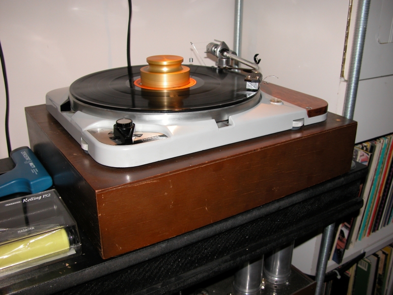

I purchased a Bren1 record clamp because I was relatively certain that my wide headshell and cartridge body would clear. Fortunately I was right - I have about 3/8" of clearance which is plenty.
The combination of improved bearing cap and weight seems to enhance overall resolution, provide a bit more rhythm, and results in a very significant tightening of the bottom end. The differences except in the bass are fairly subtle, but all positive, and don't detract from the good qualities of this table. (I can't say the same of all tweaks, I found a mat I had thought to use actually was not demonstrably an improvement.)
