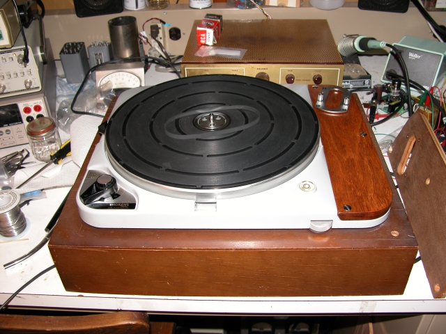

Some more pictures..

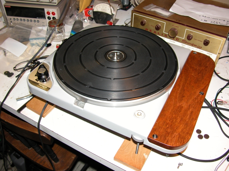

Here are the latest pictures of the TT, basically it is just about ready for a preliminary run in a loaner plinth.
The new arm board is Brazilian Cherry and I think looks pretty nice. I will be borrowing an SME hole cutting jig in order to locate and cut the hole for the arm bedplate.
Several people suggested stretching the belt on a coffee can, but the Thorens belt circumference (length) is considerably greater than that of the coffee can so no stretching action possible. I am running in the TT at 78 rpm and as the belt stretches with use it should in theory get a bit quieter. (I'm still having noise problems with the intermediate pulley, which seems to be caused as much as anything by excessive belt tension.)
I've flushed the main bearing and refilled it to the top of the lower oilite bearing, it takes about 10 minutes for the spindle to settle all the way to the bottom of the bearing housing, but this forces oil all the way up to the upper bearing which should not be run dry.

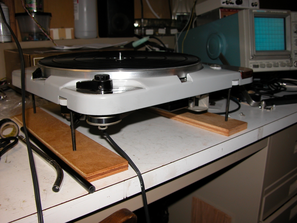

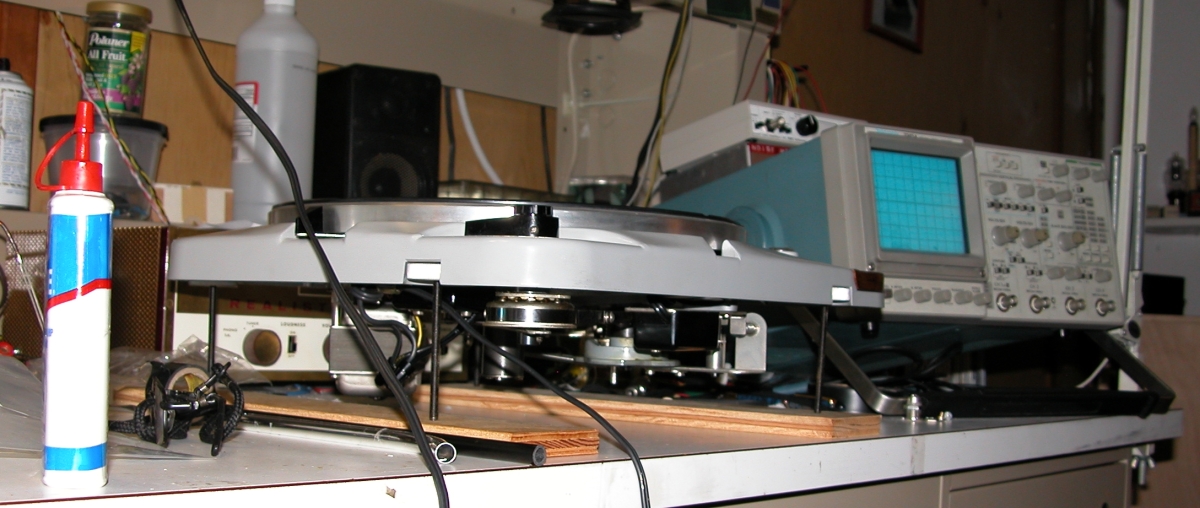

TD-124 in its temporary plinth. This plinth is a very light weight plywood affair and as a result I am using the gel bushings as I doubt that this plinth will do much to absorb and dissipate vibration from the deck..
Tonight I also discovered that purchasing a Thorens branded belt from Thakker is no guarantee that you are getting a functionally equivalent belt to the original. The original belt was in good condition and as it turns out the new belt has stretched to about the same exact length as the original. The original however is much more compliant, and a lot thinner. The new belt measured 0.036" thick and the original 0.021" quite a difference - and the old belt runs much quieter, night and day in fact. This is not really good news because 43yr old belts generally don't have long service lives, but this may help me to locate a more suitable belt.
