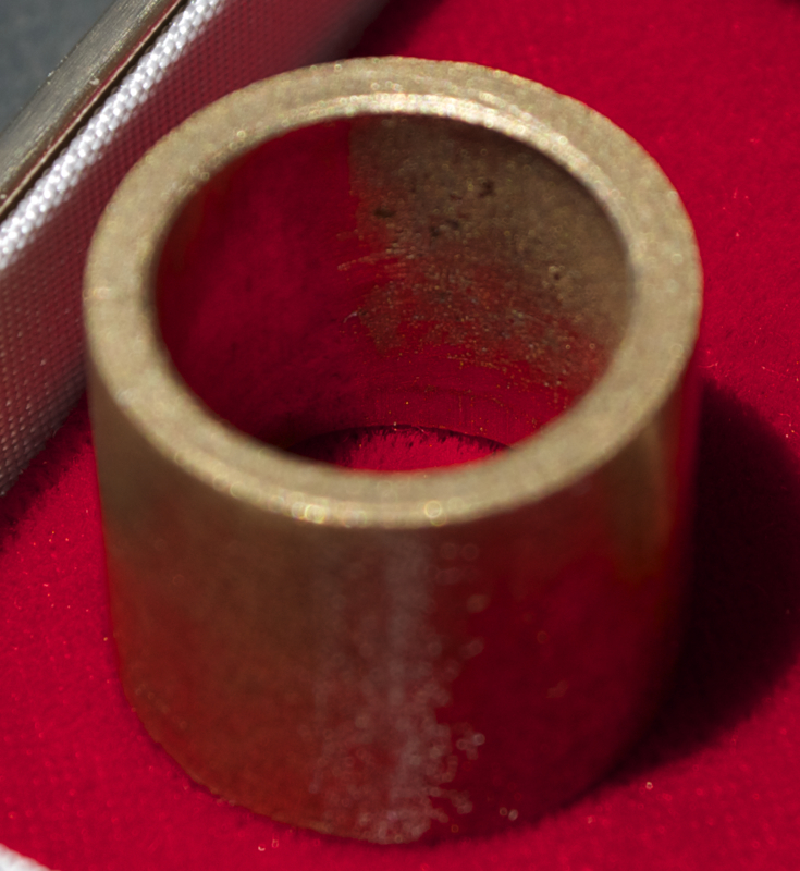

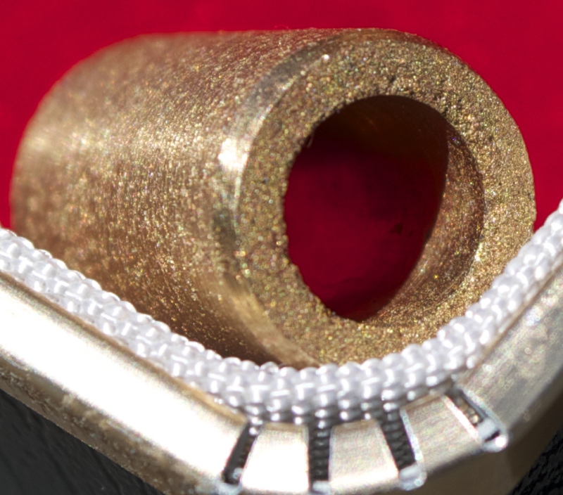

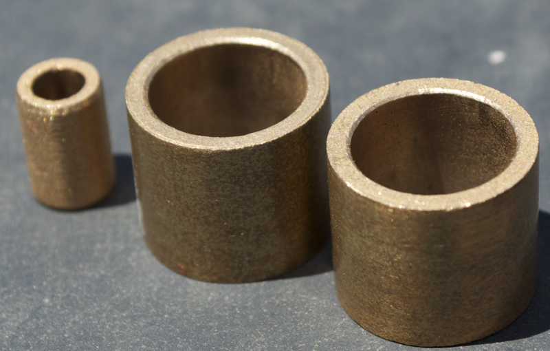

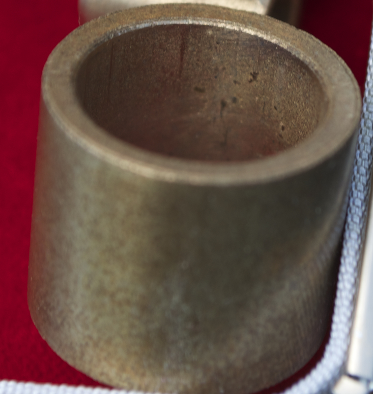

Here's a page with photos I've been using to better understand good and bad sintered bronze.
machining sintered bronze
re: sizing and correct installation.
The material is soft enough that it is possible to severely distort the shape of the bushing if, when it is pressed in, the bushing isn't adequately squared up to the bore it is to fit into. And that can mess with the final ID size of the bushing. So, I have learned to take pains to adequately square the bushing prior to the application of force. typically, I use a pilot shaft that fits within the bushing and helps to guide the bushing during the press-in operation. For a pilot shaft on the main platter bushings, I use a spare spindle shaft.
re: correct appearance of the Oilite bronze. As you note, the material should not become smeared during the machining operation, or the bushing will not have the "self lube" ability during operation. In your 4 photos, I think I don't see evidence of smearing. Typically, hand polishing to size should be avoided on this material, as that will smear the surface finish!
That last photo to the right is probably a bushing that I would not install. Like it is made of tiny bronze balls. That appears to be a bad casting. (I think) There is another one that shows some dark pits within the surface of the ID. That is actually normal and OK. If you were to section cut one of these bushings and magnify the cross section at the cut, you'd see plenty of large pores like that one. Features like that are normal and necessary to the function of this type of bushing.
