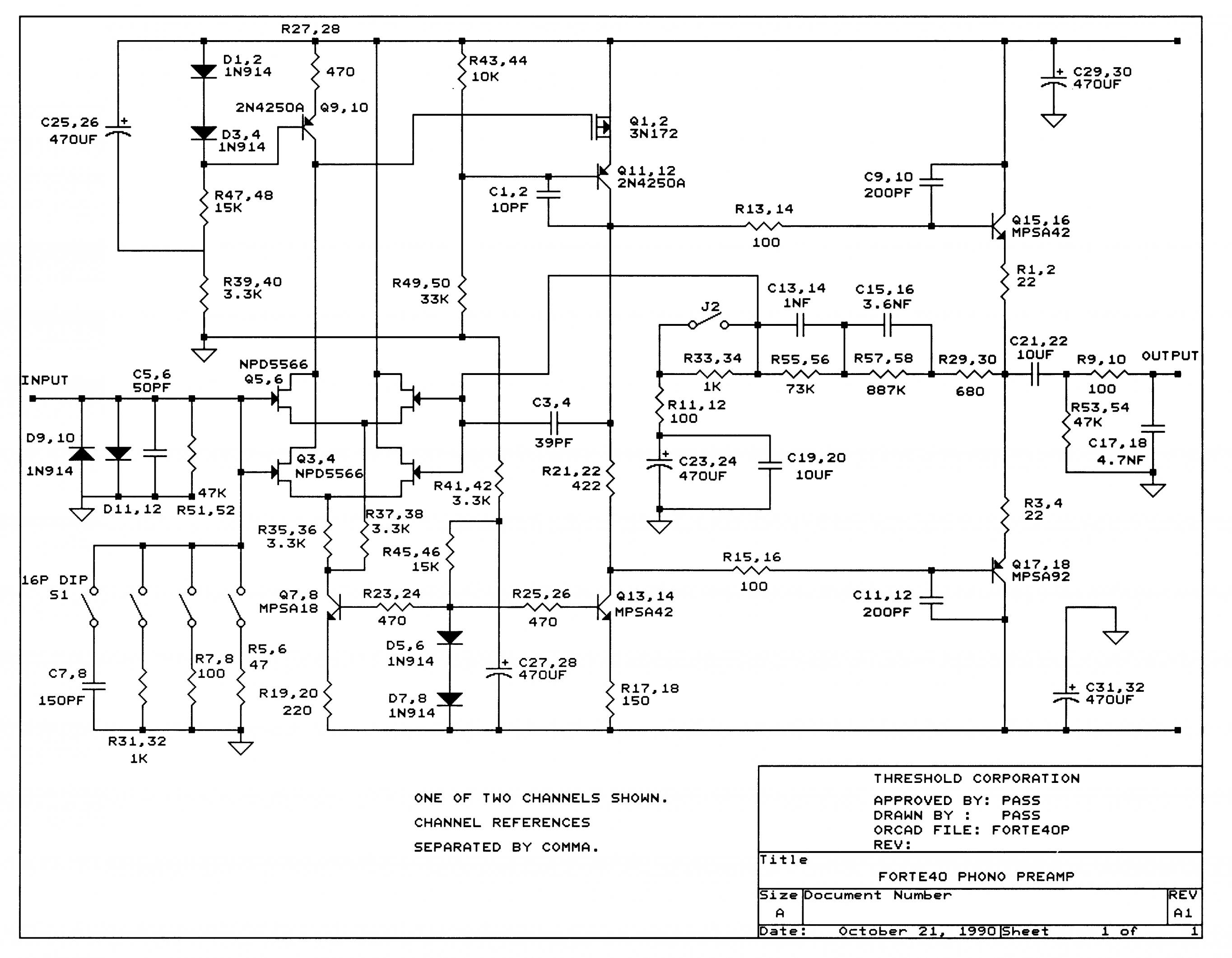

Thank you so much! I know that power supply is intended for a power amp.. and I know that it would be considered overkill for sure... but based on GaryB's posts in this thread, as well as (what I perceive to be) similarity between these preamplifiers, I thought if I had to build one I may as well build a nice one (and who knows, maybe someday I could dedicate such a power supply to a Pass power amp... that would be nice!).
Here's a pic I stole from the internet. I can provide more of my actual unit if it helps. But from what I can tell the original power supply for this threshold was remarkably similar in design to the original power supply for the Forte Model 40.

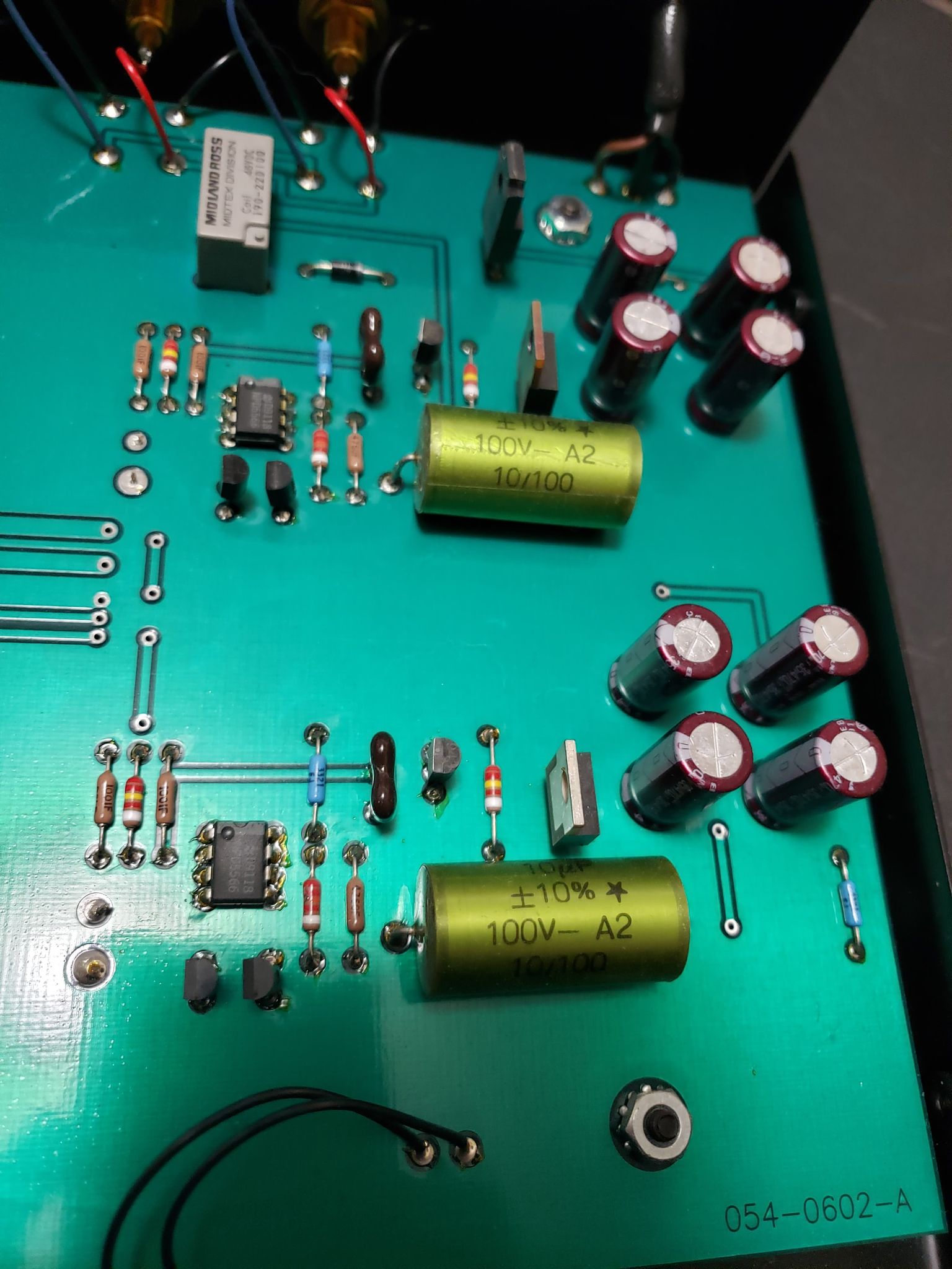

pull your unit and give us well detailed pics of PSU input and local regs, so we can deduce what voltages you need

I seem to recall +/- 18V, easy enough to replace.
Here is what I have for schematic.![]()
I don't have something out of the box for you, but you are simply looking
at a decent linear regulated +/- 18V.

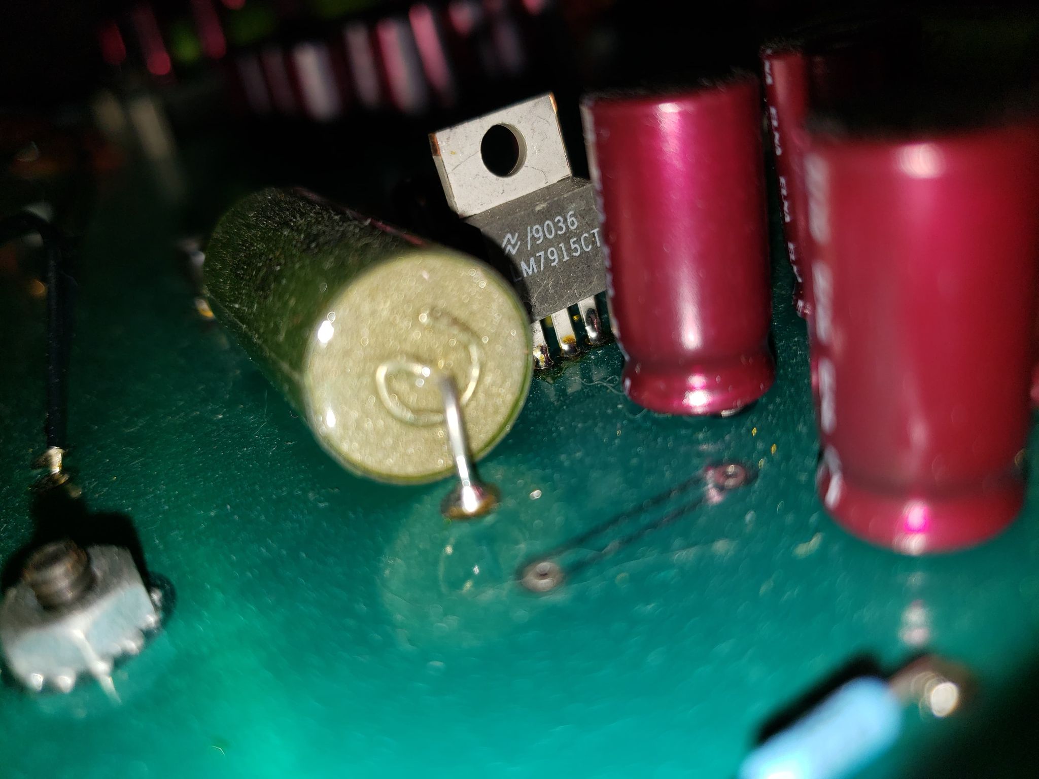

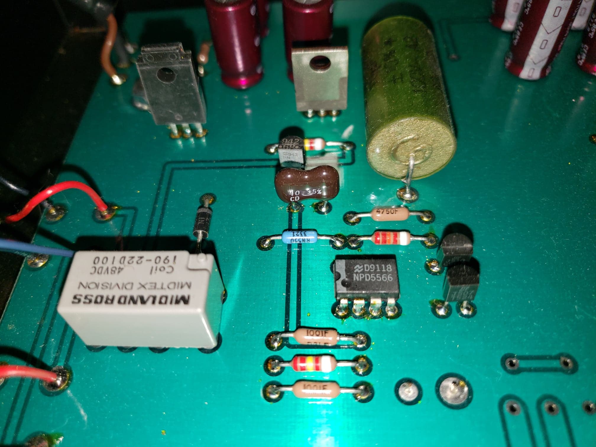

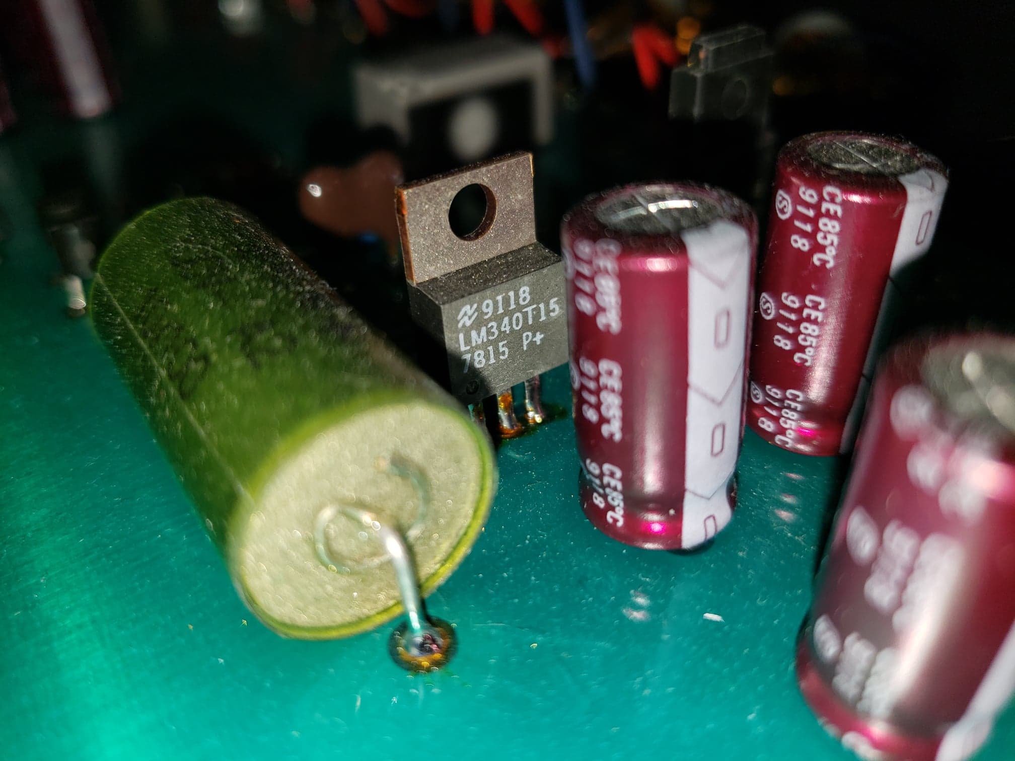

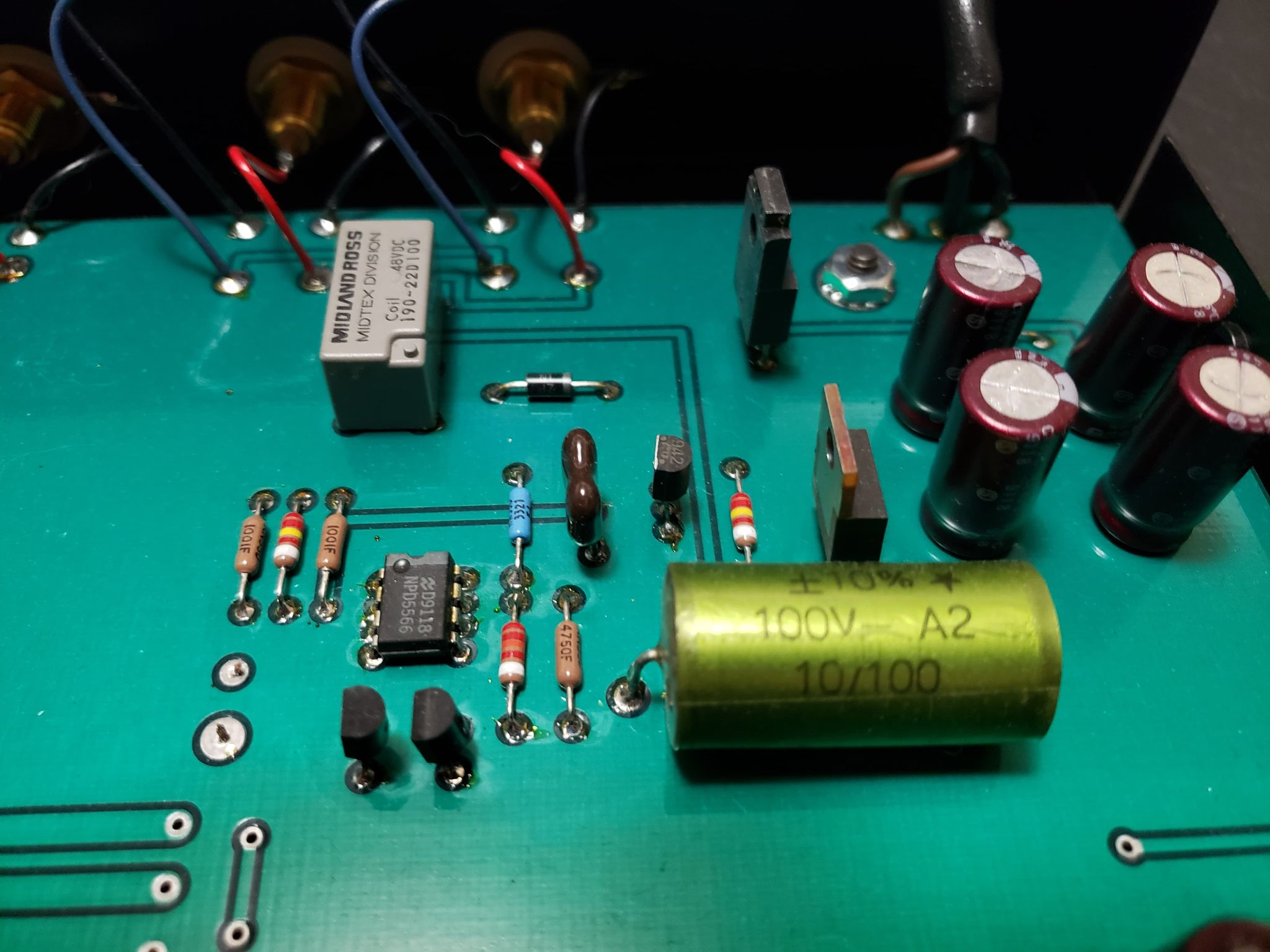

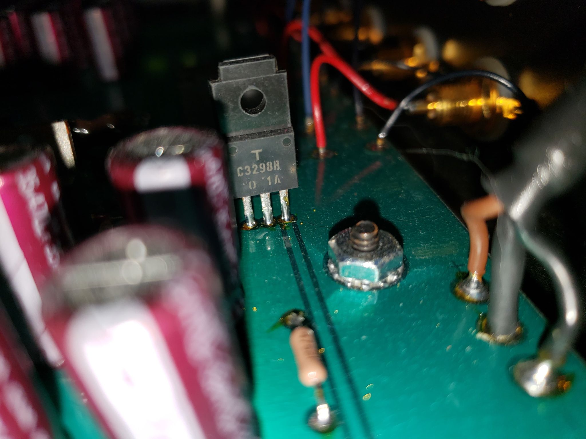

Here's where I was pulling info from before! But I'll get the preamp out today and have a go at some decent photos. Thank you so much for you help, Zen Mod!!
Here are a few pictures, which I'm sure won't be quite good enough. What specifically can I take better photos of to be of better help?
30-50VA Donut, 30Vct to 36Vct
nice 5A-10A Graetz bridge
10mF/25 V cap, 2pcs
nice PVC or metal box to pack that all
you're good to go

all your questions are covered in this thread
replace caps and replace xformer with larger one

few things (in new thread) are important to find:
-arrangement of PSU connector on back of preamp and wiring of it
-do you know how to make exact separate PSU box, looking at schematic
-do you want that PSU using only for preeamp, or you have some other intentions (I can advise first, why complicating)
-how much you're trusting in claims that overkill xformer is resulting in better sound (I mean - even 10VA is technically enough there; 30-50VA, as I wrote, is already overkill, which is good for sound........ and I did wrote that you can go as big as you want, if that gives you better sleep)
regarding size of xformer - I'm writing my opinion, which is - quality of xformer is more important than size , if size is enough ; but, as always, I'm not standing in way of someone's happiness - if you want xformer bigger than preamp, just do it
