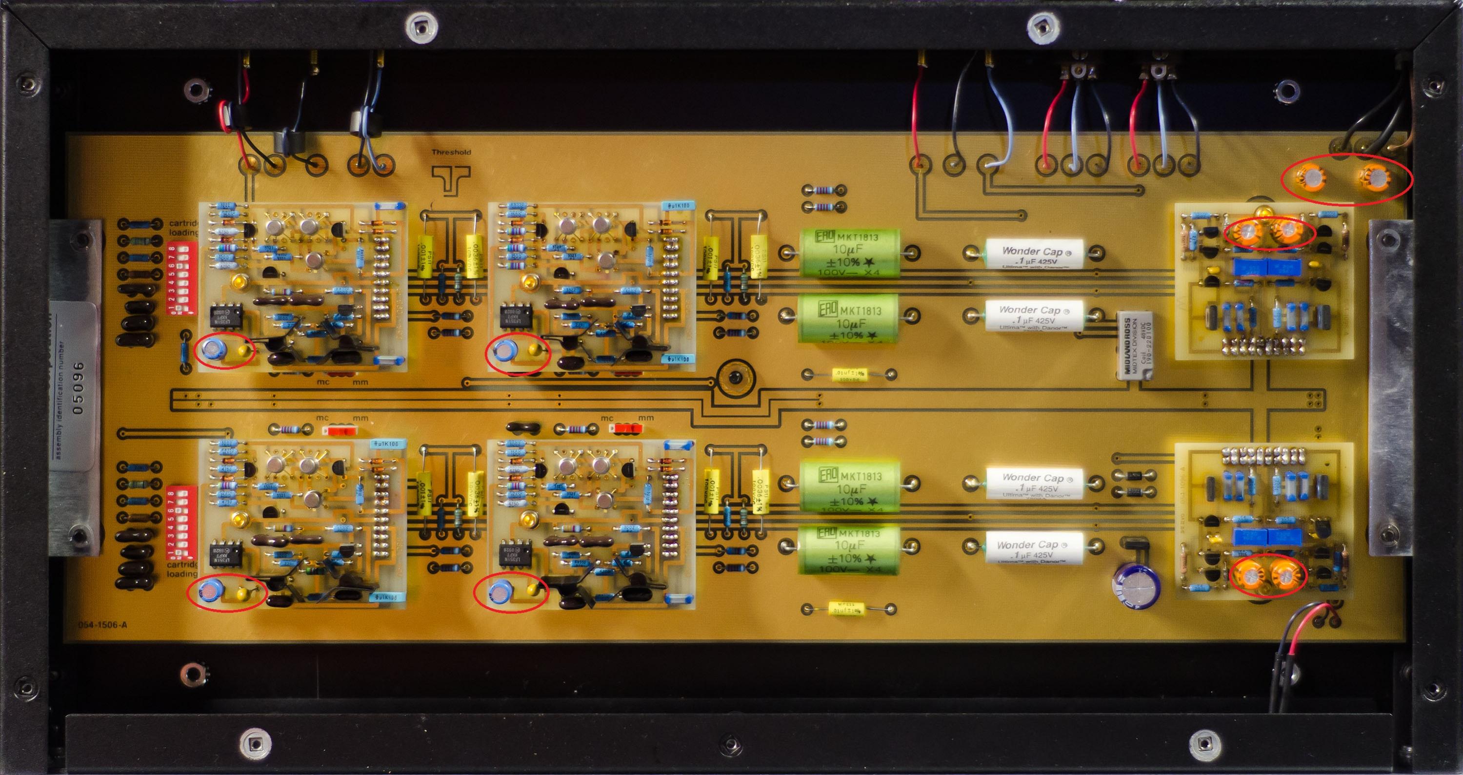

You're right about the power supply - you're trying to get +-24v when the power supply is hooked up to the preamp or phono stage. A dual 18v transformer is what you need.In case of interest to anyone: an image of my phono pre: arrived Friday
I took your photo of your new phono stage and circled in red the caps that you should think about replacing. It's what I did in mine.

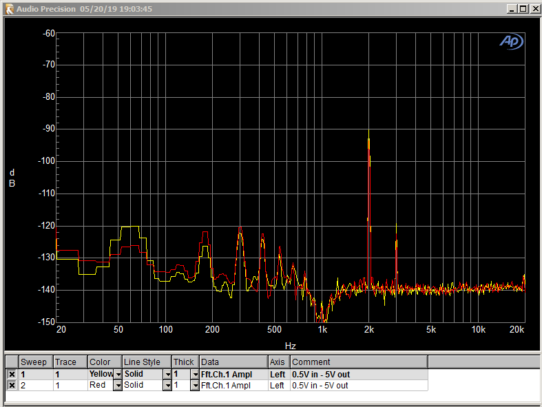

Hi Gary,
We have discussed a lot about my Fet-10He upgrades and we have exchange a few photos, as I own 2 of these babies.
The first one has been upgraded exactly as described here: Threshold Lovers - Threshold - Fet-10 HE 'competition upgrade' Level 1
including Goldpoint attenuators.
The second one has been upgraded in exactly the same way, except that the power supply is built around one hundred Nichicon Muse KZ capacitors instead of 2 big Nichicon Fine Gold.
There are 4 capacitor cards hosting the Nichicon KZ.
The transformer is exactly the same, the rest too.
But the internal Power Supply cables are NOT Teflon insulated, whereas they are Teflon insulated in the first version of the Power Supply presented on the thresholdlovers.com website.
The common point between these 2 upgraded Fet-10He is that they sound very very similar. The improvement over the commercial version is more than impressive, unbelievable, and the 2 preamps become much much better in every domain.
The question is: is there a difference between the both, provided that the 2nd P.S. upgrade is more costly than the 1st one ?
The answer is no, and if I had to chose one of the two, I would chose the less costly, although I cannot really define the sonic differences.
As I expected the 2nd upgrade to be better than the first one, I will soon slightly modify the second upgraded P.S., and the primary target is the cabling, that will be changed for Teflon insulated with UP-OCC copper.
The reason that pushes me to bring this slight modification, is that I have experimented in all my recent upgrades that the Teflon insulated cables provide better results over PVC insultaed cable (the core of the cable being of course exactly the same) in the power supplies (not talking about the ignal path). It seems a bit surprising to me, but this is what my ears said to me.
So changing the cables will be the first change.
The second step will be a change of the transformer.
I am not 100% sure, but based on my recent experimentations on other preamplifiers, I believe I will get an improvement. And if I get it, then the second Fet-10He will be better than the first one.
Hope this helps,
Nounours

Nounours,
It's good to hear from you; it's been quite a while. It's interesting that the expensive bank of many, many small capacitors is no better than a single large capacitor. But it does seem to be a reasonable result. The only advantage of many paralleled capacitors would be lower parasitic resistance/inductance. But this is a remote power supply and the resistance and inductance of the umbilical cord probably dominates over that of the capacitors. Nonetheless, I look forward to hearing about your experiments with internal wiring.
You also mention changing the transformer. I presume that you want to try an even bigger VA rating? If so, my experience has been that I continue to hear improvement up to 300VA but I haven't tried any bigger. What are you going to try?
All the best,
---Gary

Hi Gary,
You are probably right regarding the resistance/inductance of the umbelical cord, and I have already built a new one (but not yet installed) using OHNO (equivalent of the OCC) cables. I have not tried yet, but the ones who have tried to replaced the umbelical cord on the Counterpoint preamps have reported a huge improvement...
By the way, i am looking for a skilled fan (member of our forum) , who could help me with the optimization of my power supply design: if somebody is OK, just contact me by P.M.
No I do not plan to go to a transformer bigger than 300VA as it is already really big for a preamplifier.
But I plan to move from a toroidal transformer to a cubic one based on a EI circuit, and using high quality plates. I do not know how to translated this in English, but the plates are said to be heated and to have their "grains" oriented.
i have already compared such cubic transformers with high quality toroidal transformers from PLITRON in my reference DAC. Although the VA rating of the PLITRON toroidal transformers is higher than the VA of the cubic ones, the cubic ones provide much better musical results !
So my next experiment will be to replace the 300VA toroidal transformer by a very high quality Cubic one. I know a small French manufacturer that manufactures such very high quality transformers on custom specifications. I have been using many of their cubic transformers and they are stunning and pure beauties at a reasonnable cost !
Just need to find a higher cabinet for my Power Supply because a cubic transformer is bigger than a toroidal one for the same VA.
Nounours
