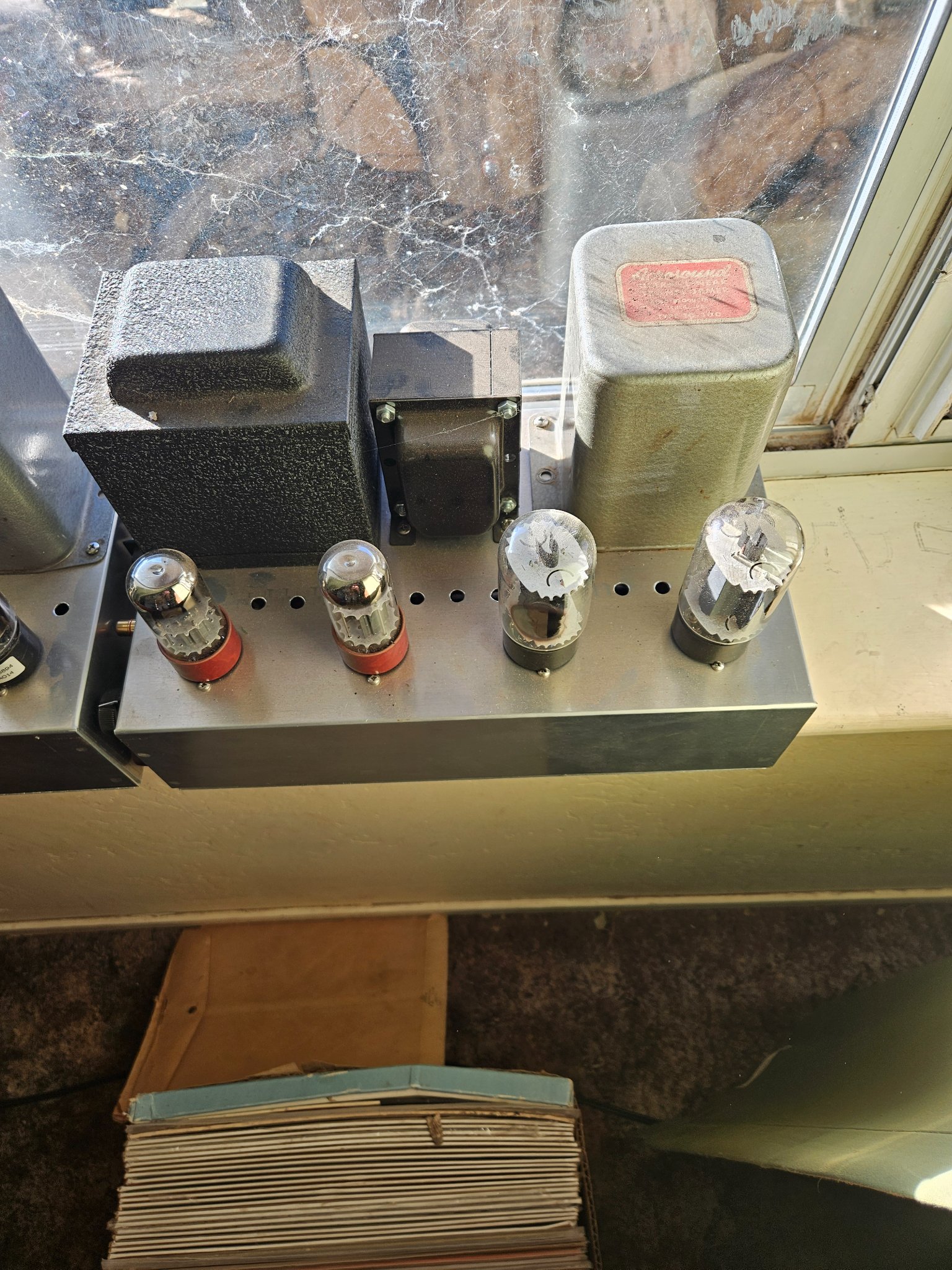

It... Is... Alive! Finally getting back to this project! I replaced all the supply related electrolytics, and a few of the resistors that were tangled around the multi-section cap, and powered it up this morning, for the first time in a couple of decades. The smoke all stayed contained, and the amp is working! Next step is to perform Gillespie's mods, as Grover suggested, but first I'll plug in a speaker and see how it sounds! Thanks for the pointers and suggestions guys! Cheers, Dave
Not so lucky today 🙁 After my successful power up last weekend, I went ahead and made all of the Gillespie mods... Maybe I should have done them in steps.... In any event, after checking my wiring a couple of times, I powered the girl up once more, and discovered that I've made a nice 93 kHz oscillator! Well not that nice, it isn't a perfect sine wave, but you get my meaning! I'll start double/triple checking things tomorrow, in particular around the feedback network mods, but I'll take any other suggestions you might have on the troubleshooting front. FYI, I'm testing this with the input shorted, and a 9 ohm resistor on the 8 ohm output (it's my "close enough" 50 watt test load).

Never let an old dude with bad eye's read schematics.... Looking things over for the fourth time, I noticed the tiny red dot next to the second set of inter-stage coupling caps.... What I had read as 15 uFd, is in fact supposed to be 0.15 uFd (I hate people that drop the leading zero!) The decimal is there, but it's a bit hard to see in red, and I didn't double check the text of the mods, where it's a bit clearer....
So I'm off to buy a couple more caps, and am hoping this turns into a "Wull thar's yer problem" moment! Stay tuned!

No joy in mud-ville.... I replaced the second pair of coupling caps with the correct 0.15 uFd ones, and I still have an oscillator. As Midnight suggested, I disconnected the feedback network from the input triode, but that didn't change anything. Poking around with my scope, the oscillation is clearly at the plate of the phase splitter portion of the first 6SN7 tube. Once the caps have had a chance to discharge, I'm going to pull the tubes, and measure all the resistors around this part of the circuit, to make sure they're in spec. Can I fire it up with the output tubes, and the middle 6SN7 (tube C in the schematic) pulled, to just look at the input/phase splitter portion of the circuit? Or would the lack of load cause the supply to rise too high? I can dial back my variac, but that would drop the heater voltages as well....
Bummer again! You can power it up with the driver removed, it's not that much of a current draw, maybe 10mA.
Double check your work. When I built mine I had one lead on the wrong pin and it oscillated and had other problems until I found and corrected my error.

Just to close this thread off, an update! After putting the project aside for a bit, I returned to it, and with some help from the folks over at audiokarma, finally figured out what was going on. When I did the mods suggested, I also swapped out the input jack, for a nicer one, which resulted in the chassis being floated, rather than tied to ground. I was aware of this, but didn't think it would cause any issue other than potentially picking up some noise. Wrong... It seems like the parasitic capacitance to ground, provided by the chassis, was adding to the amps stability! As soon as I grounded the chassis, the 90kHz oscillation went away, and the amp is working perfectly!
Thanks for the help and suggestions! I appreciate them, and am enjoying my Dad's old amp because of them! Cheers, Dave
