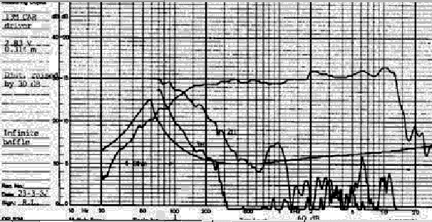

response graph for scan speak
Madisound has the speaker you are looking for. It is priced at $90. I believe that is for a single speaker. You can check that yourself-at the website, click "catalog":
www.madisound.com
Madisound has a Scan Speak pdf file that is well worth looking at:
www.madisound.com/scanspeak.pdf

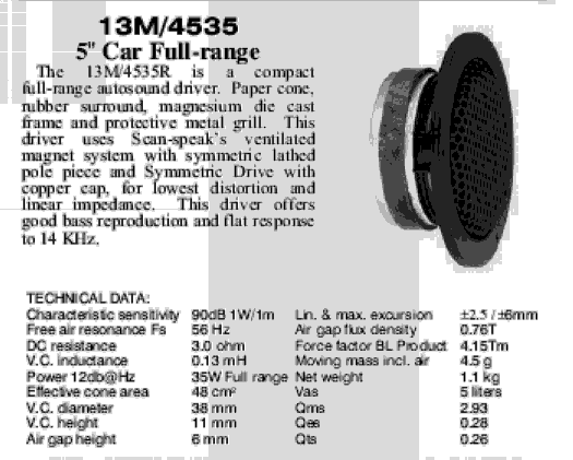

First, I will post the descriptive text, including the Thiele-Small parameters. In my next post, I will post the graph.
And here is the graph for it. It has an impressively smooth curve. In fact, I am going to mention this on a thread where someone is looking for a full-range speaker.
If you look closely at the bottom of the graph, the last visible vertical line is 20,000 Hz. So this thing is smooth to 14,000 Hz.
Good luck on your project.

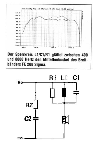

For the mid, as mentioned in the Basszilla website, he uses a Fe208s If you are using this driver I have been told that the notch filter that Dick Olsher includes in his plans is a very good idea. Probably a good idea if you are making any speaker with the 208! The Basszilla doesn't use a tweeter.

Hello Mark,
I forgot to say that if I have think of use 10" or 12" it also because in europe we have small rooms than in usa unfortunately. Real open baffle is too big to.
The filter call "noch" filter is a old filter wich is very ofen use with FE208S, it's a filter which is published in a german publication there is a long time.
Pascal.
