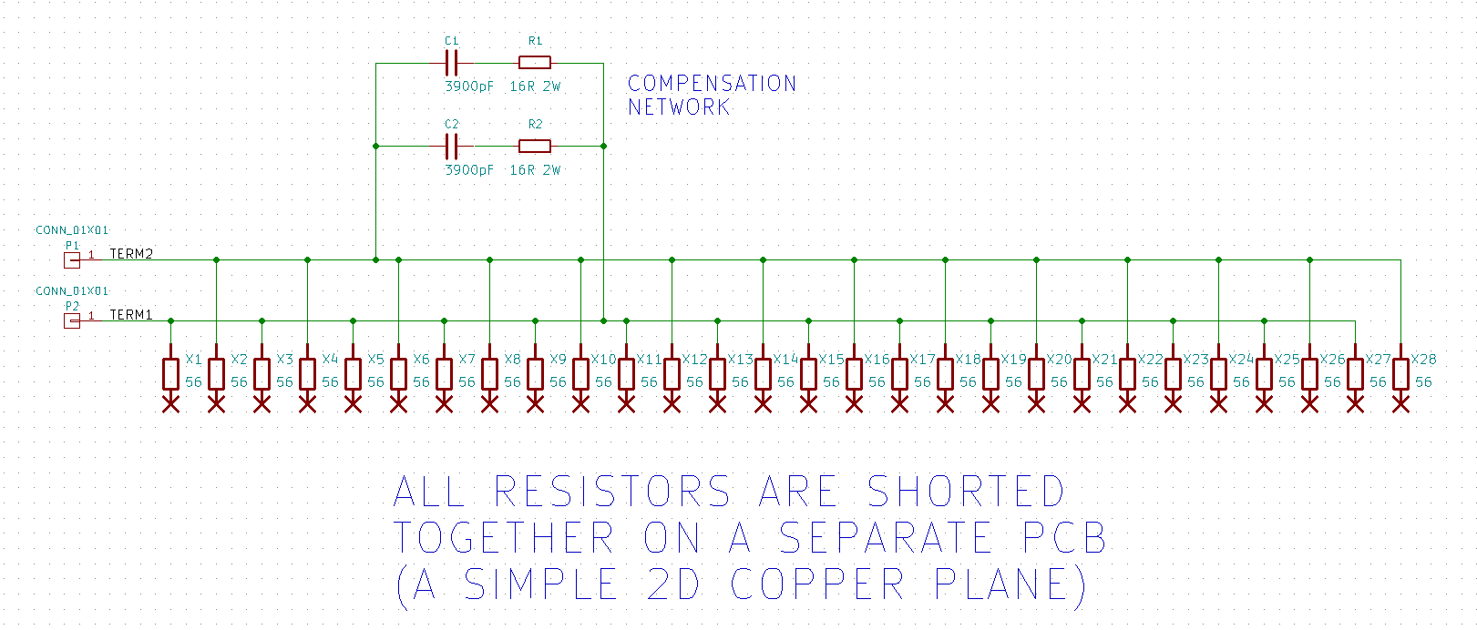

You may replace the even or odd resistors with just a return wire. https://www.celem.com/dos_and_don_tsI did that with the cheapest wirewound 10 watt cement-body resistors, to get a (mostly) noninductive composite resistor. Current flows downwards on the odd numbered resistors, and upwards on the even numbered resistors:
They're arranged in a two dimensional array, having four rows and seven columns. A copper plane shorts everything together on the bottom
Then, since the field cancellations were not 100.00 percent perfect, I added an RC compensator to shape the square wave response. This gave a pleasing, nearly ideal square waveform. (link)
