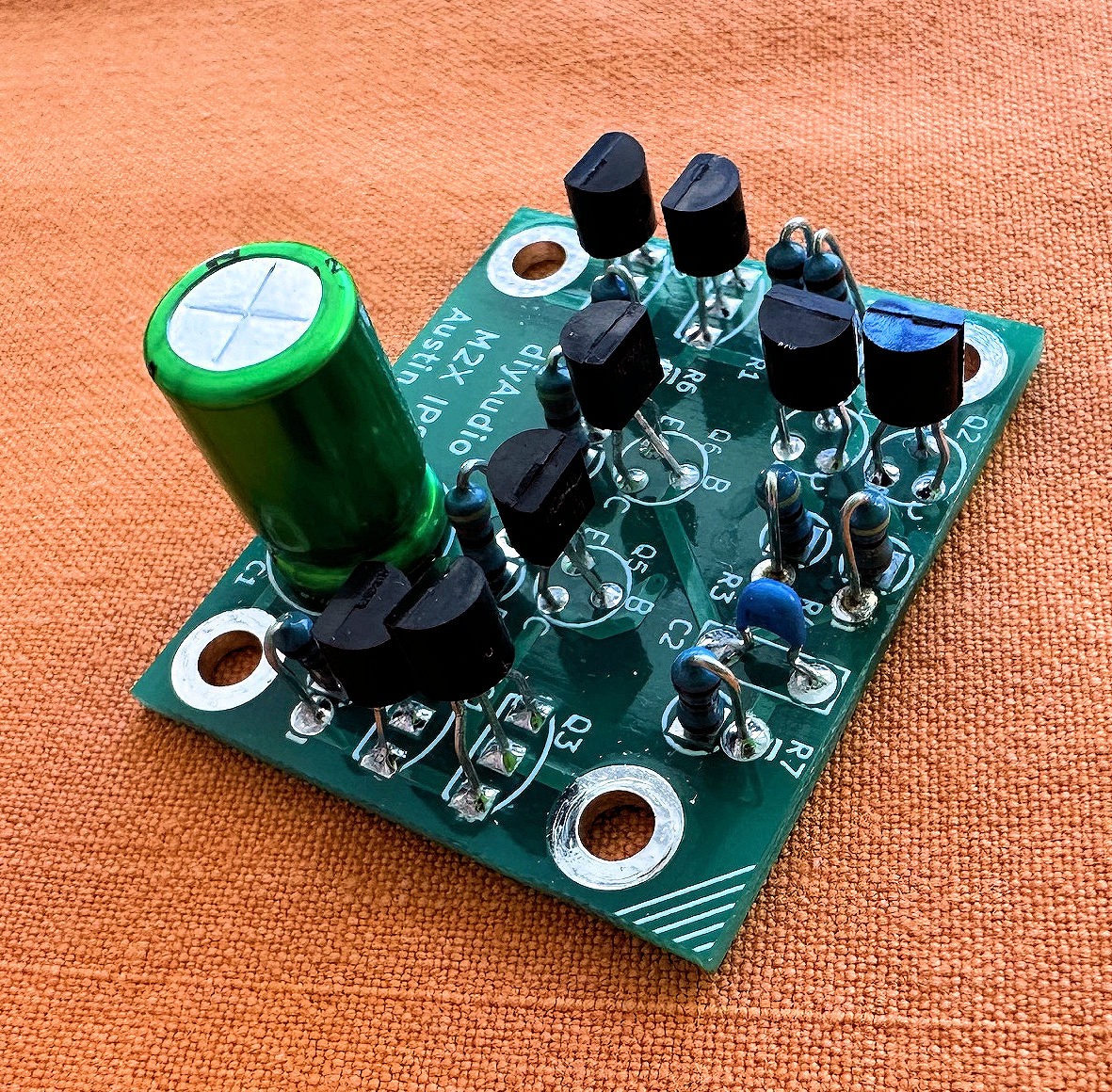

I wondered how a couple of the circuits I was considered building might leverage that idea to make layouts more compact and elegant. These generally separated active from passive components with the power distribution comprising a third level.
I laid out a Leach phono stage and Marsh's Pooge-3 gain stage. There a mix of interconnecting resistors and wire and in the case of the Marsh a couple of constant current diodes. I wondered about loops but the moment passed and I moved on to something else.
the layouts were neat though...

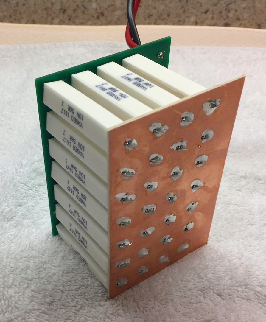

No, but if you put them in series with one rotated 180º and have 100% coupling of their magnetic fields the inductance would theoretically cancel. Getting 100% coupling is a significant challenge. One way to get there is to get "non-inductive" resistors, which are kinda constructed like that. Look up Ayrton-Perry winding: https://en.wikipedia.org/wiki/Ayrton–Perry_windingwhat about wire wound resistors? If they have inductance and you used two in parallel, with windings in opposite directions, the inductance cancels?

I did that with the cheapest wirewound 10 watt cement-body resistors, to get a (mostly) noninductive composite resistor. Current flows downwards on the odd numbered resistors, and upwards on the even numbered resistors:
They're arranged in a two dimensional array, having four rows and seven columns. A copper plane shorts everything together on the bottom

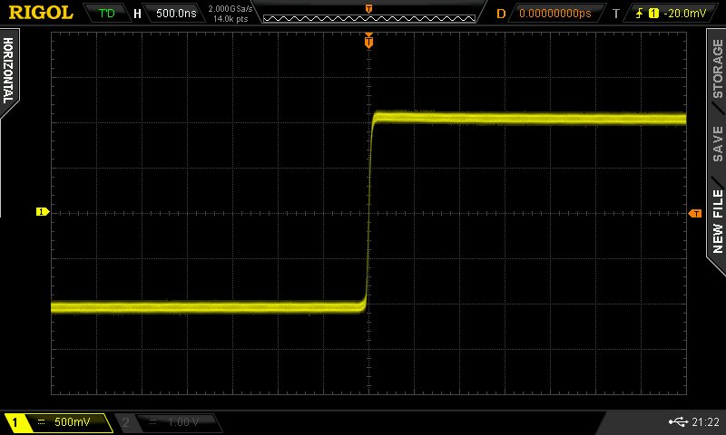

Then, since the field cancellations were not 100.00 percent perfect, I added an RC compensator to shape the square wave response. This gave a pleasing, nearly ideal square waveform. (link)
