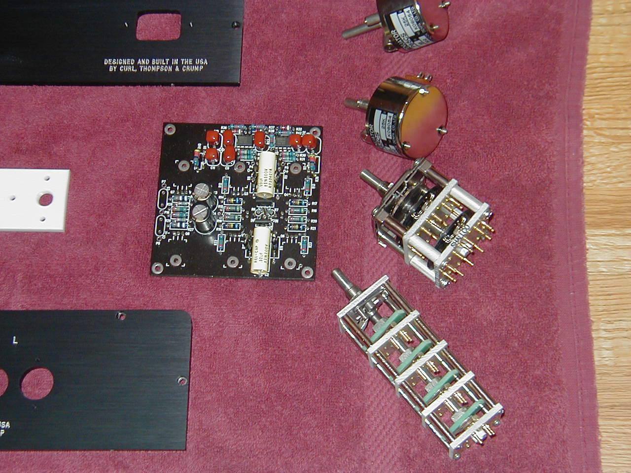

If it cant be measured then it aint gonna be heard, that is a fact.
