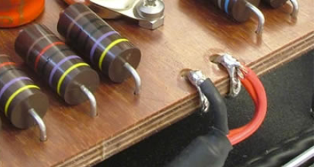

Yes Mr Gregg !Do you have any links to the audio note equipment you are referring to?
Regards
M. Gregg
http://http://audiofederation.com/blog/archives/519Audio Federation Blog Blog Archive Audio Note M9 Phono Preamplifier photos - High-end Audio Blog
... with 2watter resistors .... even in a preamp 😉
Yes Mr Gregg !
It does look a lot like Ply wood...I wonder what it its made of....
I would think its impregnated with something to stop it absorbing water..
I can only get the second link to work the first one seems to be broken..

Half way down the page,
Quote..
Picture below shows a close up of the wooden board holding the RIAA correction circuit showing in detail the 2 E80F input valves, the two watt Audio Note™ tantalum resistors and the serious number of silver foil signal capacitors and the two RIAA correction transformers at the top right.

Wood and circuitry sounds like disaster, meaning a fire hazard waiting to happen. This looks like a commercial product, I suspect it is just made to look like wood.
It's worse than that- it's electrically leaky and changes dielectric properties radically with changes in humidity and temperature.
... like AB do 🙂 But bakelite was used a long time ago by HP, Tektronix, and many others . I warnished (polyurethan) some oranges boxes wood plates and got very nice results 😛
That was my thought (Fire risk)...But further down it looks like plywood..
It looks like its coated with a lacquer of some kind.
And yes this is Audio Note M9 preamp..
I have no problem with wooden chassis...Circuit boards???😕
However it has made me think..M77..😀...I would want to mount tag board on the wood and that isn't what I'm seeing here!
Whats the resistance of ebony..😀 And yes it looks like 2W tantalum resistors. Valve bases are lifted with nuts..no pun intended with wood..😀
I wonder what the underside of the wood PCB (connections look like)..
I keep looking for the date 1/4/14 etc..but there isn't one..

Its wood..
Audio Note M10 Signature Owner's Information (Page 8 of 23)
Quote: The M10 uses the finest materials and components available, even down to the use
of a special 'densified' wood circuit board material.
What ever densified means!

Densified wood..
www.roechling.uk: Laminated densified wood / compressed wood / Lignostone / Transformerwood
https://www.google.co.uk/search?q=d...JYmAON3hgIAK&ved=0CAgQ_AUoAQ&biw=1455&bih=665
Does that include laminate flooring?
https://www.google.co.uk/search?q=d...55&bih=665#q=densified+wood+flooring&tbm=isch
I guess pick the colour of your circuit board..light oak seems nice..😀
Looks like an M77 dark or light oak for a fun test then...sorry off topic..
Many years ago I have built on all sorts of things Acrylic, Tufnol, even slate..but this is a new one..😀
