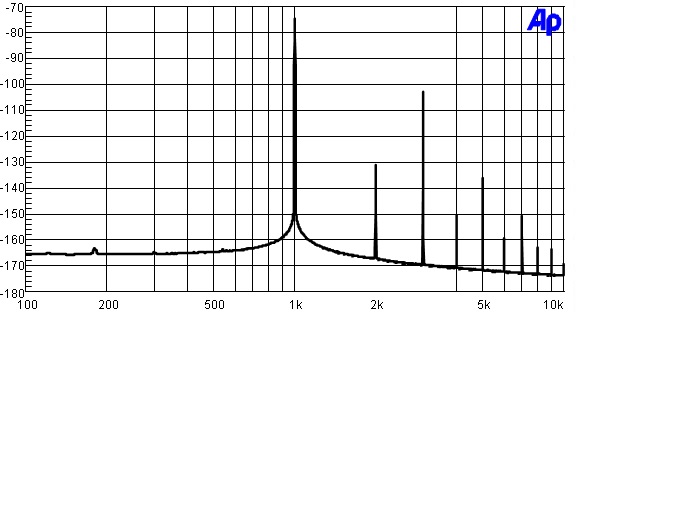

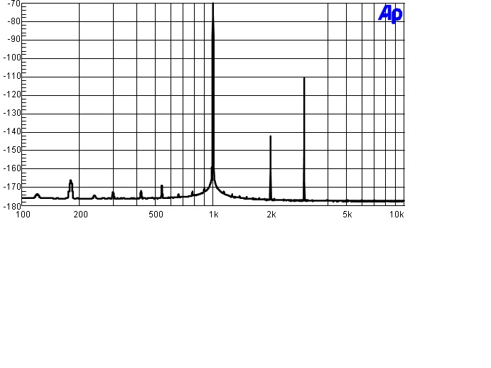

Attached are the distortion curves form a carbon film resistor that is one of the worst of it's type and the same curves for a carbon composition resistor that is one of the best of it's type. Note that if you use two resistors in series the distortion will drop by 6 db. Also if you double the resistance you will get 6 db less distortion also.
So by changing the resistor from 390 K to 600K the distortion may drop 10 db. Going to a better quality one can add another 10 db. So hearing a 20 db drop in distortion is possible.
You don't label which is which, nor the test conditions or values. Meaningless, as usual.
Very sloppy work for one so (self) exalted.
That would be too much to expect. But you can think about what the source impedance is, what the grid leak's value is, how the voltage divider looks, and the effects of the carbon comp resistor's voltage coefficient, then estimate its effect without having to worry about superficial graphs. Five minutes and a pencil.
