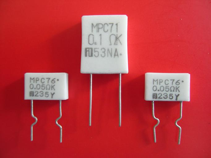

Metal Plate Cement Resistor (MPC).
The construction of these resistors is a metal plate with several cut lines to increase effective conductor length with perfectly reliable spot welded lead outs and encased in ceramic body.
Economical, easily available and probably better than WW THD/TC and non magnetic.
Also available in Dual 3 pin version, as used in billions of amplifiers.
Dan.
Dan.

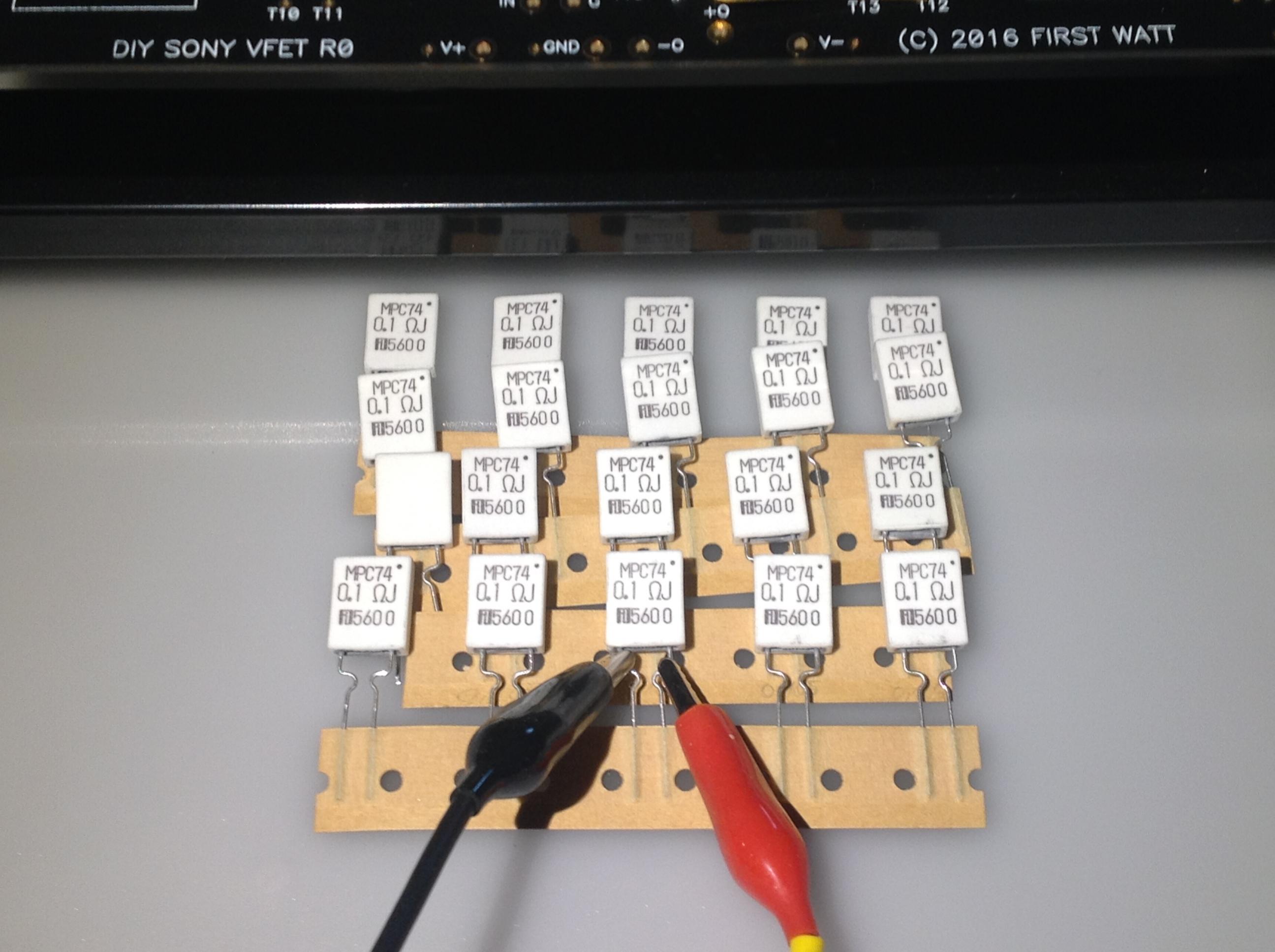

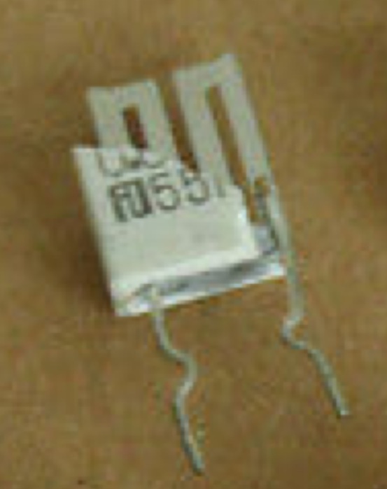

Hello Max
Yes interesting candidate for source resistors.
MPC74 Futaba 5 watts type is my favorite.
:cheers:
