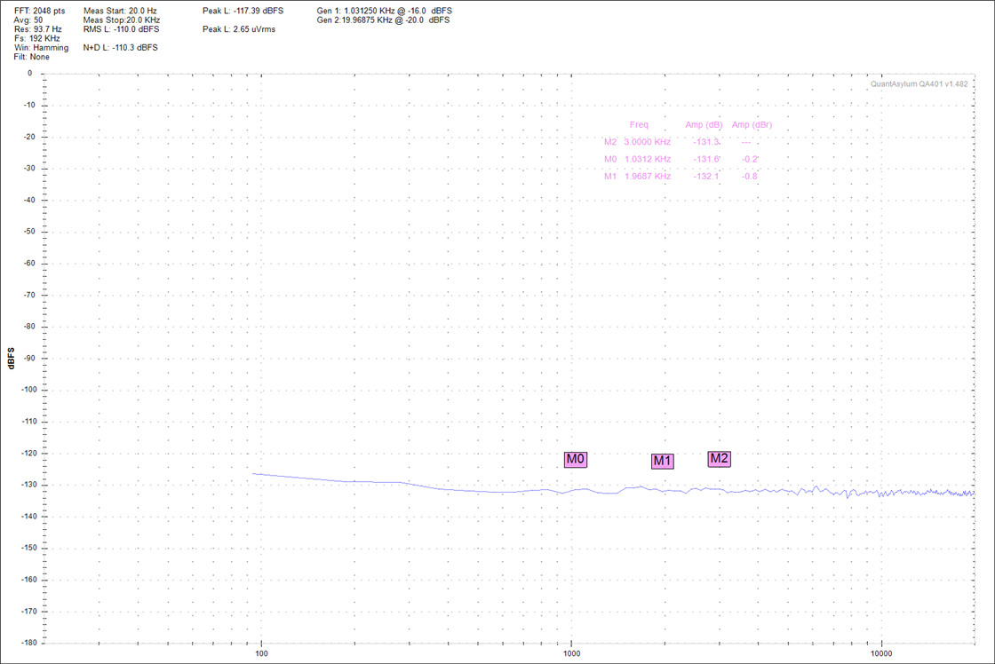

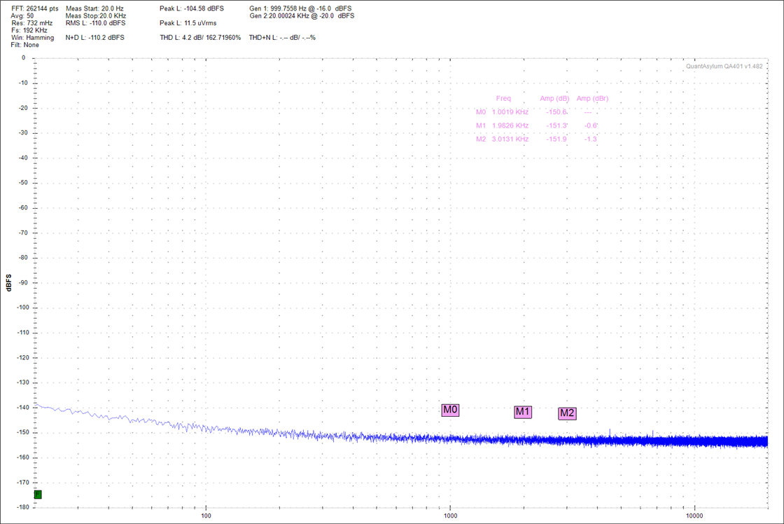

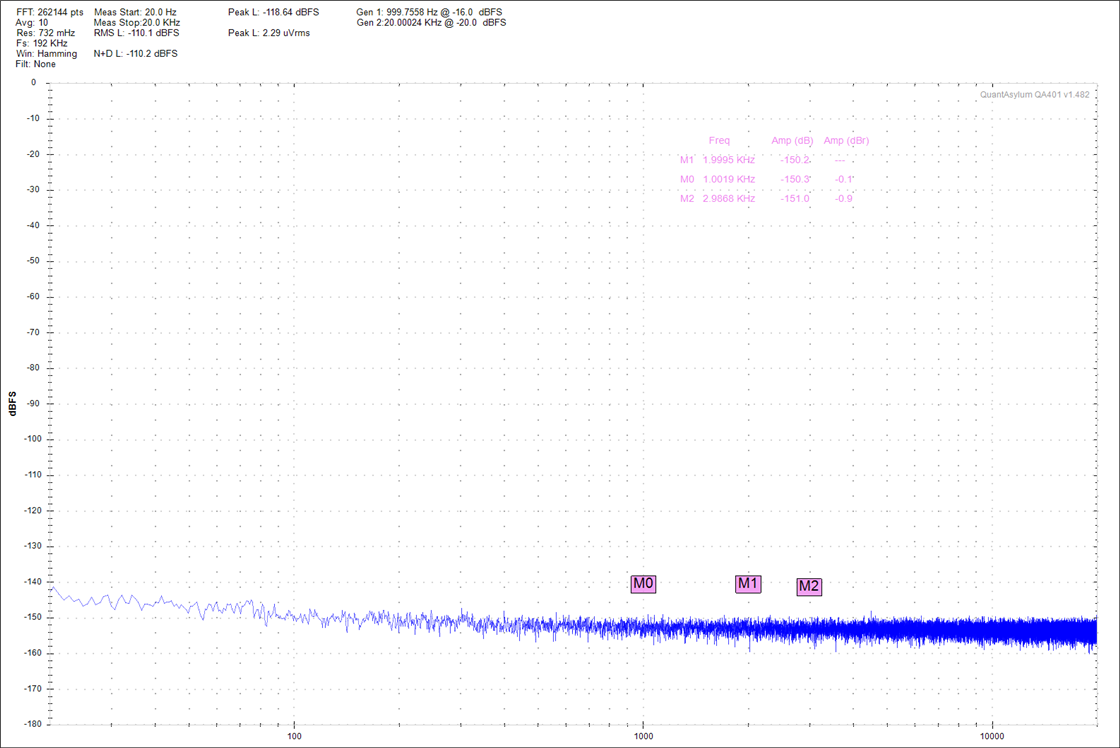

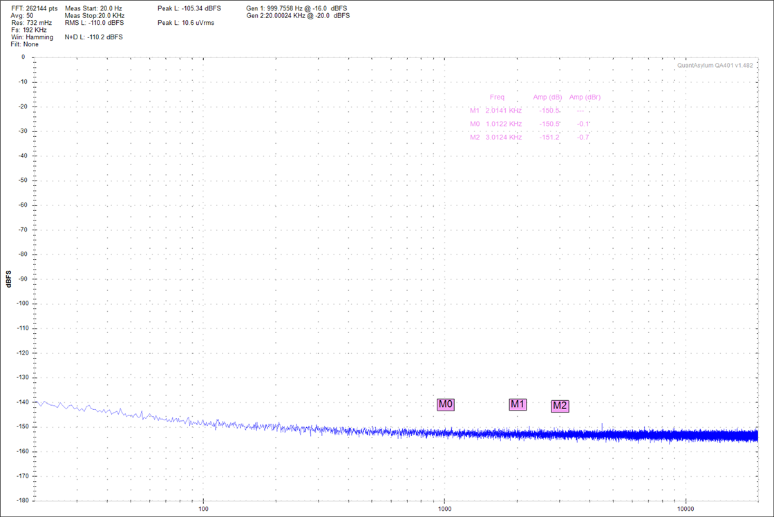

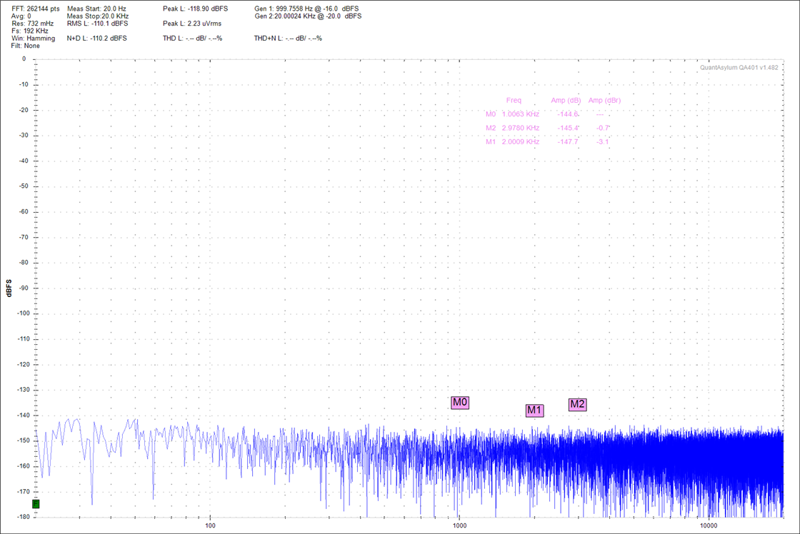

cute little QA401
I have this cute little QA401 sitting here on the floor by me. I thought I would use it to illustrate a couple of things.
https://www.quantasylum.com/content/Products/QA401.aspx
Increasing the number of averages reduces the fluctuation or swing of plus and minus values from the noise floor mean. See the attached plots; 0 averages, 10 averages and 50 averages. Increasing the number of averages does not lower the mean value.
Increasing the sample size increases the number of FFT bins. For every doubling of the sample size the number of bins also doubles with a 3dB reduction in apparent noise floor. As the number of bins increases with sample size, the noise per bin times the number of bins remains equal to total noise. See the attached plots; note that the sample size changes, the noise floor changes by 20 dB and the total RMS noise remains unchanged at -110.0 dB.

My Gosh DT,
You be learning us pretty good there. And I recon I agree with ya'.
'Cause we aren't really changin' the noise floor really as we didn't
do nothin' to begin with.
And I see that you are doing the proper nomenclature also, i.e.;
M0 for the fun-dimental
M1 for the 2nd harmonic
M2 for the 3rd harmonic
It always struck me as funny how the fundamentalist
was Zero while the 2nd harmonic was One
and the 3rd harmonics was two.
I guess it all falls back on the zero, cause that is where
we start. In my not to distant past, before I saw the light
by the professor who whacked my knuckles with a ruler
one too many timw, I put the fundamental
as M1, and the second at M2.
Thank you for settin us straight, that is us unlearned one's
but rest assured I be learning and quickly too.
