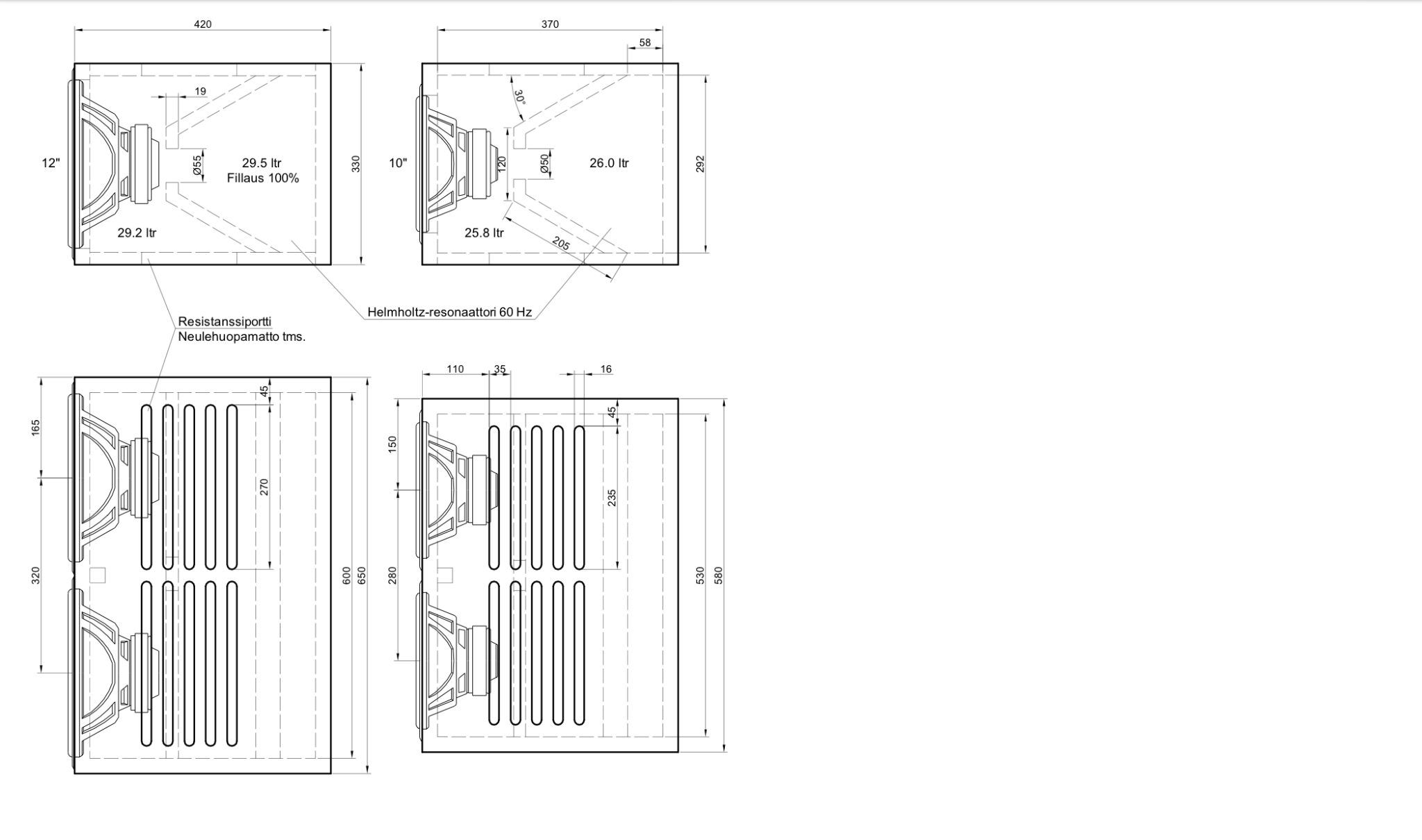

This concept from kimmo‘s website over a decade ago, is intriguing, the Helmholtz absorber I assume, reduces the cabinet resonance, flattening the impedance spike, but does it also it’s attenuating the back wave? However the Q of the absorber will mean the attenuation won’t be constant over a wide frequency band.
Kimmo described it as variable volume resistance enclosure.
From the description in this archive it seems the helmotz part act as a filter:
https://web.archive.org/web/20170905054902/http://kimmosaunisto.net/CardSub/CARDSUB.html
The design presented in the link seems well tuned and gives good directivity behaviour below 500hz but seems to lack overall level capability.

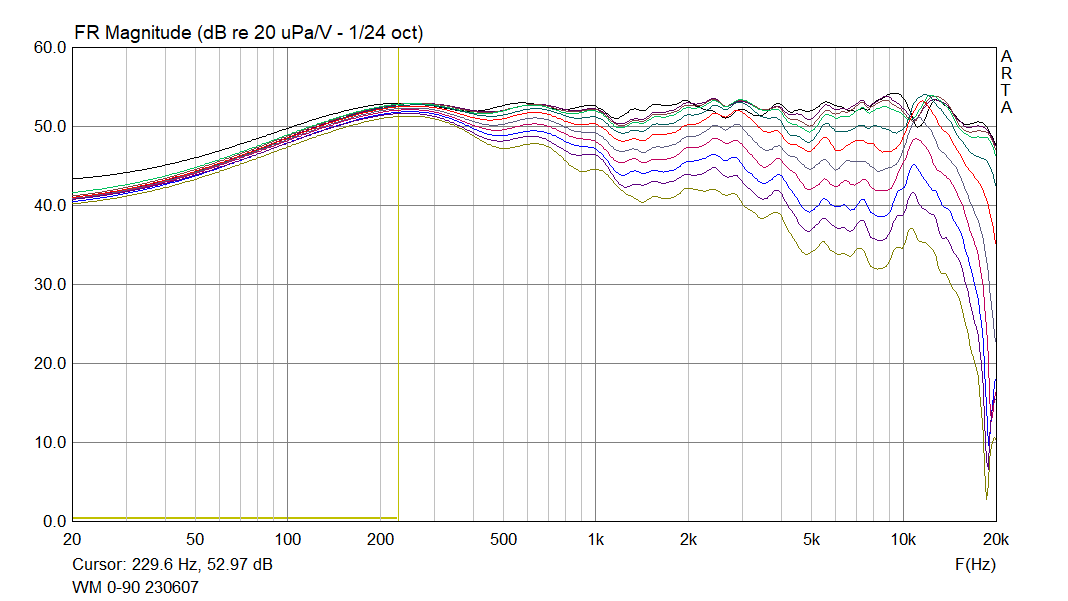

Hey on Page 21 are measurements of my prototyp.They look very good. It would be interresting to see some measurements. How did you print them? Face down? Did you make your own waveguide for the tweeter?
https://www.diyaudio.com/community/...eaker-insipired-by-d-d-8c.369939/post-7039293
I print it upside down. The tweeter Area was down.
Yeas i make my own waveguide for the tweeter and it took 4 prototypes.

What is that chamber going to bring you that a gated measurement will not? Did you explore modern measurement techniques? Attached results were acquired in a room 8’ tall, 16’ wide and 27’ deep, measured at 3’ distance from the speaker. Valid up to 300Hz, the caveat being the resolution isn’t very high either.

For those frequencies you don't need any anechoic chamber. Gated measurements with REW, ARTA or CLIO works equally well in a ordinary living room.
