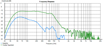

So here are some measurements I did today in small anechoic chamber (300hz).
This is the DUT and the crossover is 800hz.
The green trace is a nearfield measurement of the woofer.
The blue trace is a nearfield measurement of the ports.
Both are taken while the heavy cotton absorption was in.
