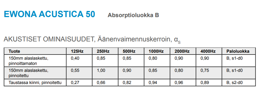

I'm using Finnish Ewona insulation material. Their acoustic products have coefficients in the datasheet. See the other attached table to translate coefficients to dB of attenuation. https://ewona.fi/wp-content/uploads/2020/03/tuotekortti_acustica50_1.5.pdf

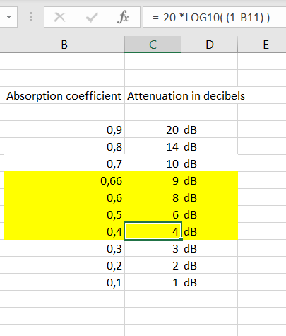

According the logic I'd need the coefficients to be between 0.4-0.9 on the 200-500Hz bandwidth to get flat DI and extend the flat DI bandwidth towards 100Hz. The Ewona has that absorption range too low in frequency, below 200Hz. I think this makes the measurements of my prototype box have the Dipole response below 200Hz as you commented few days ago. I'd like to move that to be above 200Hz and test that with the emulator somehow. I already know 6db attenuation is best, but the ramp of attenuation across bandwidth is hard to emulate with the simple filters.

Looking at the Ewona coefficients (previous post attachment) they are pretty constant between >250Hz! Great, I need to find thin sheet somewhere. Top two rows on the table are "with 150mm airgap behind", the other is with surface coating. The bottom row is "attached to surface". I think the airgap row represents the situation in this application (the aperture). 0.85 coefficient means 16dB of attenuation and I'd need half that. If 1cm+ Ewona thickness is not available I need to change brand. Still waiting coefficients for the Ewona insulation board I have, different product altough it might be close to what the acoustic products in the table above are.
Again, the problem is that the absorption coefficient (attenuation) goes up right there in the low mids on all acoustic damping materials I've checked. Stacking layers of thin product can be used to tune to right attenuation if the attenuation (absorption coefficient) lower than required, 1-4dB. Many products have too much attenuation like the Ewona I'm using, I'd need much thinner layer of it.

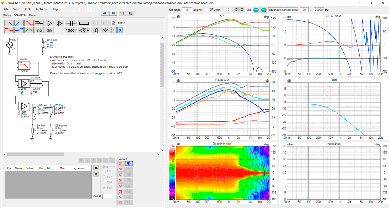

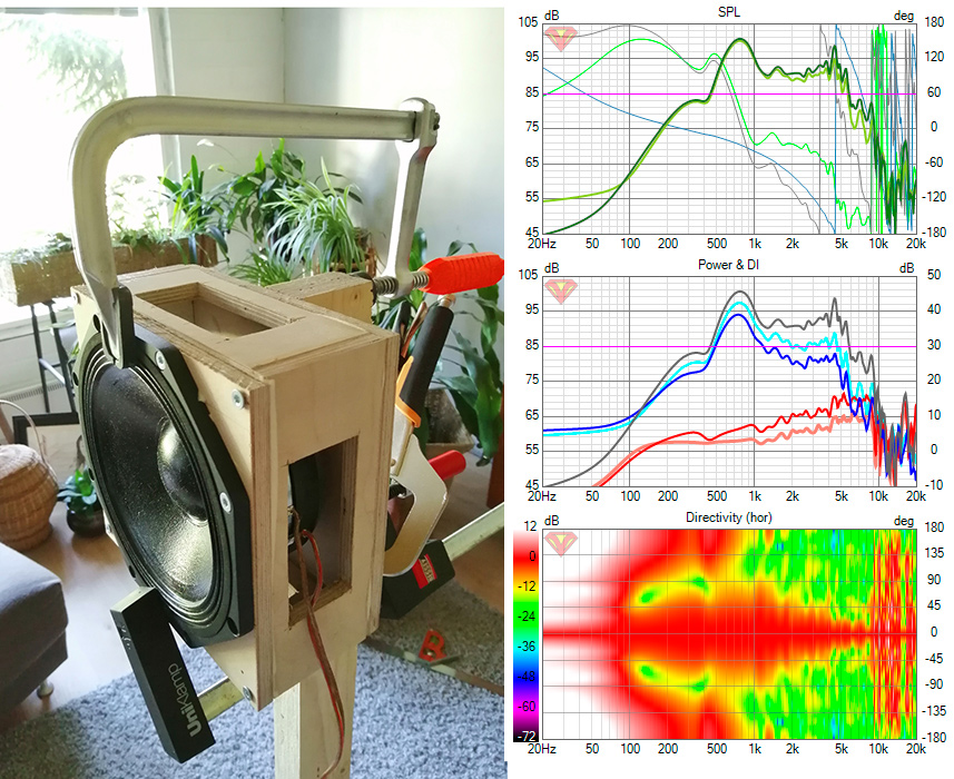

Help, lend me your brain! The emulation shows that when there is four apertures the optimal additional attenuation (with damping material) to get flat DI would be 6dB. This is equal to attenuation of sound power to each aperture since the four apertures each receive 1/4 of the rear sound = equal to front side of the driver of course.
Now if I block two of the apertures (mute top and bottom in emulation) and reduce the portion to each open ones accordingly to receive 1/2 of the rear sound power to reflect reality. Now the optimal attenuation of damping material for flat DI seems to be 3dB which is again as much as each aperture receives sound. Power to each "hole" is emulated by the gain block near the side drivers on the VituixCAD. Gain block next to the text is the "perfect damping material" emulating attenuation. When both of these gain blocks have the same attenuation, a flat DI is achieved.
What is the relation here, how to interpret this for the real prototype? Is it that attenuation of each aperture should be 3dB = attenuate half the power / output which is 3dB of attenuation no matter how many there is? my brain is twisted! Am I confusing power or volts or something with this kind of emulation setup in VituixCAD, multiple drivers simulating the four holes? What is going on? Thanks!

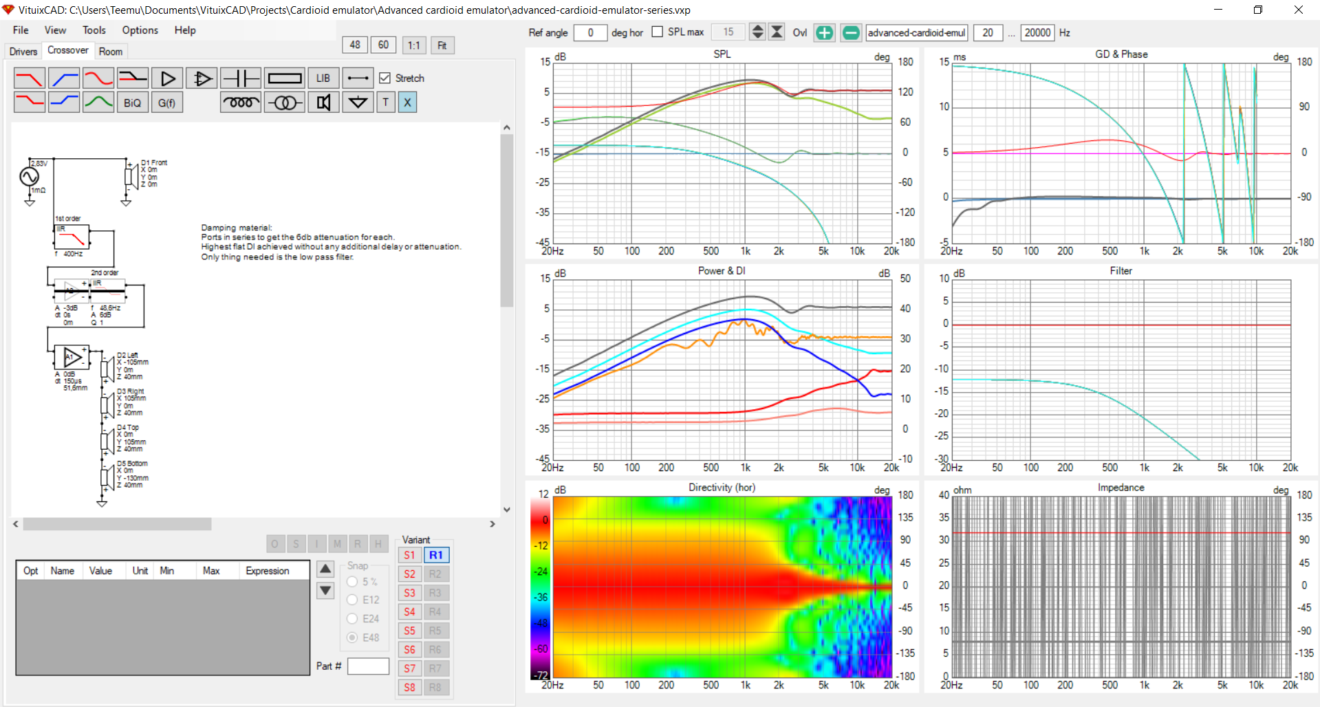

Technically, there is no need of attenuation. The simulation needs attenuation only to simulate the division of rear energy into 2 or 4 slots of a real world case, thats all.
If you simulate the rear slots as 4 drivers in series parallel combination then there is no need to attenuate. Do note, you can only simulate 4 drivers but not 2 this way.

Here, no attenuation blocks needed when all ports are in series but the result is same as with parallel and attenuation blocks in front. This solves the mystery with the attenuation blocks and gets the emulation equal to the simple one with just one driver representing the back side of the cone, the box with holes and damping material.
The verdict is still the same from the emulation: Any added delay or attenuation to the aperture(s) output just lowers the DI and makes DI slope higher up.
This would mean the damping material is needed only for killing some reflections on the response but as a trade-off the polar pattern gets wider. If wide polar pattern is required then use more damping material and kill some reflections while doing it. Damping material adds delay so this needs to be compensated with pulling the port back and widening the baffle.
Less damping material yields tightest pattern but with some ripple due to reflections inside the box. Add as much damping as requirements for DI are fulfilled, the DI will ramp up the more there is damping material (due to attenuation and delay) and the damping material is tuned to try and reflect the DI target one has for given system. No damping material should yield highest and flat DI, more damping yields lower DI rising with frequency.

I'm ever more confused about all this though, the emulations show any damping and delay inside the box seem to harm the response (reduce flat DI bandwidth and DI itself). Why dampen at all? What is the reason for name "resistance enclosure" when any resistance (attenuation or delay) is bad for the response? What piece of puzzle is missing from the emulations?
Damping is needed to low pass the rear source. Without damping there can be no low pass.
Alternatively one could just low pass the rear by right sized port alone, SL already said somewhere that the rear is already havin an LP due to the basket which forms an 'enclosure' and a 'port', so it should be technically possible to get the LP with an enclosure that low passed acoustically with just a few ports. I am not sure whether the rear enclosure can be low passed that high though.
But dont take my word, I am just learning.
Acoustic low pass is done with cavity and a pipe, damping is not needed, see post #185 there is a link. I haven't seen mentions to attenuation while searching info on acoustic low pass filters, it is not in the low pass fc equation either, only physical dimensions of sound, cavity and pipe.
Simplified, the acoustic low pass filter is formed by the volume inside the box and the (combined) aperture at least. There is probably another low pass due to the basket but much higher in frequency. See responses of naked driver and driver with box with apertures without any damping at all to see the effect on post #185. I'll attach them here as well.
Introducing the box, without any damping whatsoever transforms the response of a naked driver dipole to something "cardioidish" least one octave lower, maybe two, so the low pass is working. High frequencies back side are reduced. When damping material is introduced the response doesn't change too much but the ripple is reduced. Although the measurements are not lab quality, the trend is there I think, this should be well above gate time of 3-4ms I used.

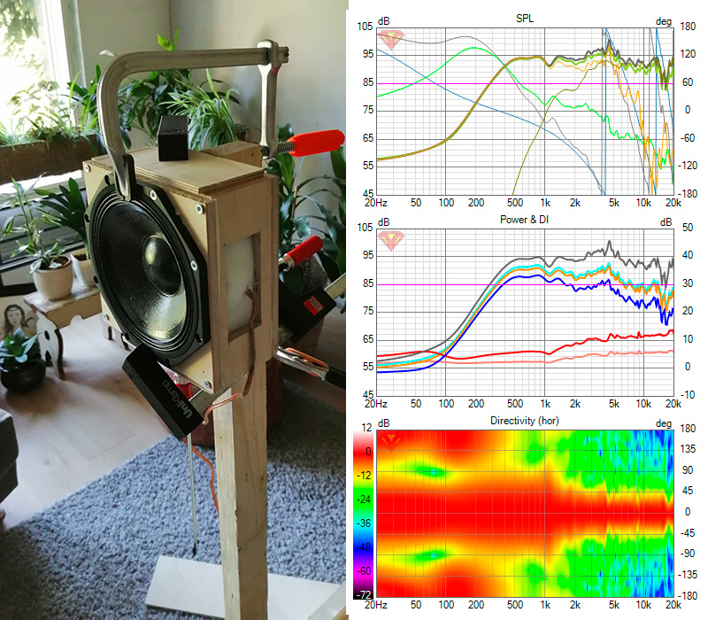

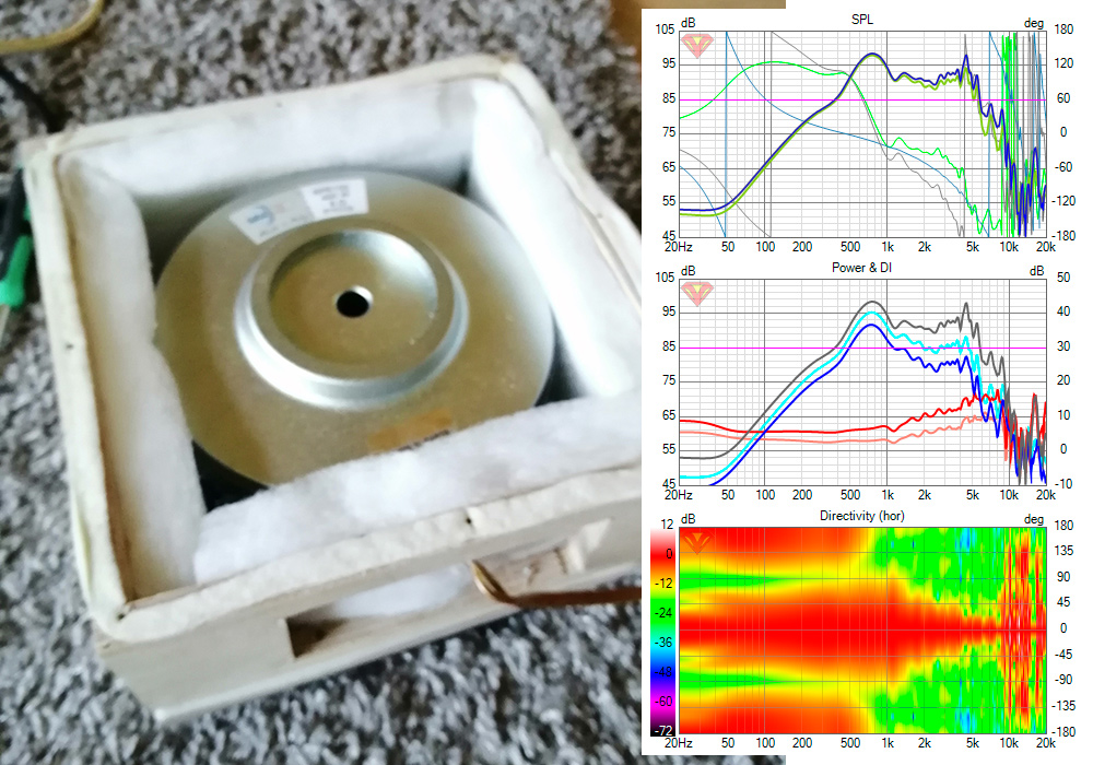

Attachments are:
1. Naked driver, showing dipole response.
2. driver with enclosure making an acoustic low pass filter.
3. some damping material inside the enclosure, mainly reduces ripple and defines the pattern but not much change. Dipole below something like 700Hz.
4. pattern control to lower bandwidth is achieved by blocking half of the apertures lowering the low pass frequency
edit. Hmm, I've achieved "flat DI" with the small box with damping material, but the bandwidth is only on the upper spectrum >700Hz. Too much damping according to emulations.

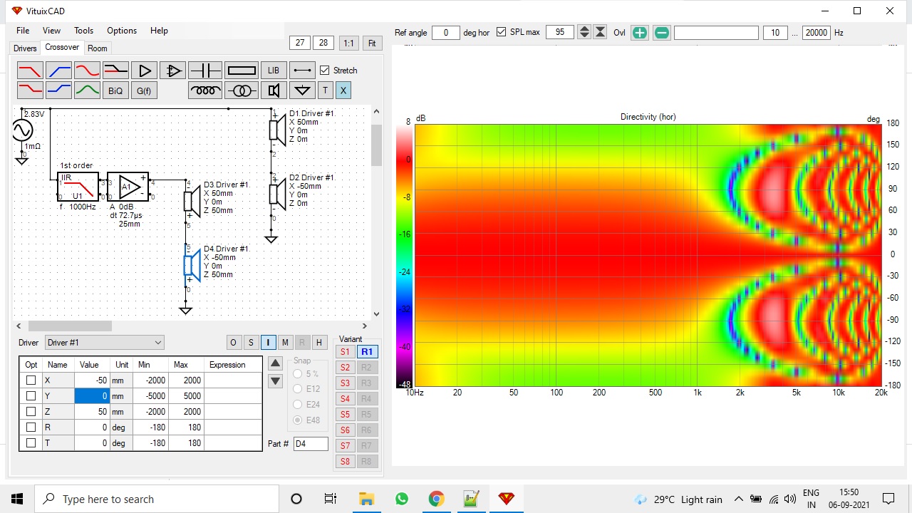

Hi Tmuikku,
Does this help? The front has been simulated as 2 sources since the front radiation is going to the rear via diffraction happens on both sides and I think that makes the difference.

I think wonderfulaudio example is demonstrating diffraction using drivers as edges, X offset on the front and back drivers as perfect point sources?
Same can be done more accurately with the diffraction tool like in my emulation project. The front driver is diffraction tool simulated perfect radiator on same size baffle as the prototype box. The diffraction tool simulated measurements results include baffle edge diffraction, but do not include what effect sides and back of the speaker have. Nothing that happens after baffle edge is in the diffraction sim but neither is in the wonderfulaudio point source demonstration.
Anyway, what these sims represent is that no attenuation or delay is needed on the port output to achieve "cardioid" response. Can it be right since the resistance seems to be associated with this kind of projects? Whats going on, what wrong with the emulation, or is everyone talking about resistance for wrong reasons or what? Back to the the original question

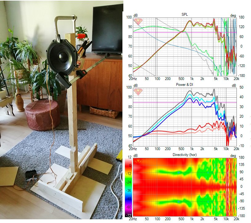

I make some more measurements one day, hopefully soon I'll measure the prototype (which is the bigger volume box of the two measured in #185) without damping material and maybe some variations with damping, trying to have some inside back of the enclosure killing reflections there. Maybe elongate the box to get some path length around the back, if the varying the damping material doesn't reveal enough info. What should I try to get more sense to all this through measurements?
To avoid confusion I clarify that: there was two boxes measured on the post #185. When I've been talking about prototype lately I've ment the bigger box, which I never measured without damping material. Todays attachments are measurements of the smaller frame which is a bit shallower box with less volume while other dimensions and damping material are the same. All posted on the #185.

The answer has been written above a number of times. The delay needs to be close to the path length difference from the front to the cancelling source to get a cardioid pattern. This delay can come from various sources. Once you have it from one adding more from somewhere else will degrade the pattern.Anyway, what these sims represent is that no attenuation or delay is needed on the port output to achieve "cardioid" response. Can it be right since the resistance seems to be associated with this kind of projects? Whats going on, what wrong with the emulation, or is everyone talking about resistance for wrong reasons or what? Back to the the original question
You are adding a low pass that includes delay in the filter. By picking the right filter you get the delay needed to generate the cardioid pattern. This is the fake part adding a specific low pass electrically when you are trying to represent an acoustic filter. The path lengths and properties of the damping material/port opening will determine the response of the low pass in the acoustic filter.
