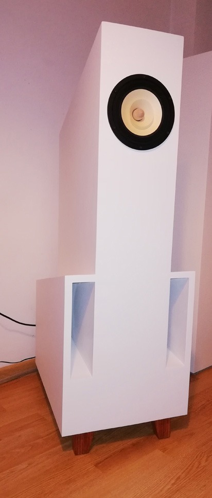

Aim: I would like to rebuild some full range FE168EZ sigmas BLH cabinets. Not like the Fostex recommended cabinets I built a decade ago. Just nice curves and smooooooth surfaces everywhere using CAD & a 4x8ft CNC.
Objectives:
1. Build a Full range BLH unless there's a better recommendation out there for this driver. Down to 50-70hz is good.
2. Have the driver set about 3.5ft/107cm up from the floor
3. I'd prefer having two identical horns come out from the back chamber. One eventually exiting at floor level, the other up top about 7ft/215cm high
4. The total horn mouth area to be less than 0.2sqm
5. Any audio reasons to not build these out of concrete or poured resins?
Some comments: This approach may look pretty but it is counterproductive.
How low the horn can go will depend on the horn mouth size. 2m2 is a 0.8m circle (max extention) > 5m circumference > 70 Hz. So if on the floor, 35 Hz, pushed against the wall, <20 Hz. Hope i got that right.
The current leading exising designs are Victor and Dallas II. Right on the edge, but FHXL works too. The Fostex recommended horns tend to be mediocre at best. The 1st 2 are horns are end-loaded with an initial air-cavity, the FHXL a tapped horn.
Do note that this driver wants to see a high Rout amplifier… what do you plan to use.
To expand on what waxx said, Scott (Woden) will do a custom design. This is by donations, and so far, only once has the donation covred all the work so Scott retains rights to the design. I will tell you that a “smmothly curved) BLH is not something he would tackle willingly.

I only have a moment, and what I'll quickly say more or less follows some of the above. However, for what it's worth:
- As Dave notes, smooth curves, while beneficial for midrange & HF horns, are in many ways counterproductive for bass horns, since they promote maximum efficiency at shorter wavelengths, i.e. the frequencies you don't want, while leaving the LF relatively unaffected.
- In a similar vein, given the terminus CSA limits and tunings noted, you're going to be using more resonant action over the operating BW than anything else, so the concerns over parallel surfaces, rounded lips to the termini &c. that would apply to an uncompromised / impedance matched horn don't really factor as significantly in this instance.
- The notes about the amplifier are fine; you can correct for that by using a high resistance speaker wire however. Thin (24ga - 30ga) is one solution, or you can move from the usual material suspects for the wire & shift to a higher resistance alternative. A power-resistor or resistor grid also works, but resistive wire is arguably a more elegant solution, and one Fostex themselves pulled 20 years ago at least one show.

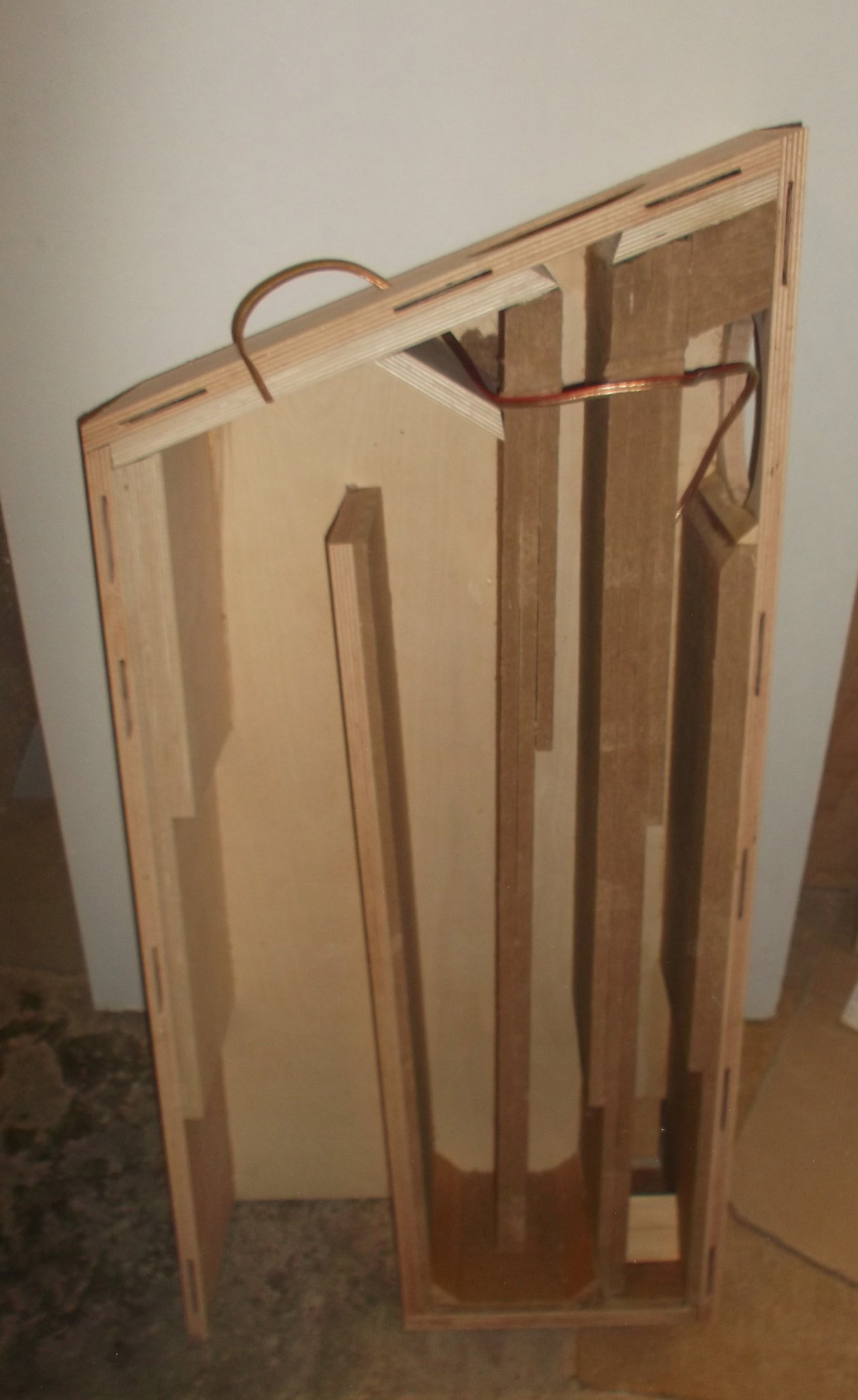

Another option is to replicate the curves as when they occur in the wooden cabinets, whilst changing the pathways from rectangular to circular/elliptical/egg?
In a bass horn a waste of time and could actually make things worse for the reasons Scott mentioned. Lose the idea of smooth curves. Those are useful in a front horn, a problem in a BLH.whilst changing the pathways from rectangular to circular/elliptical/egg
Youmay be able to do that in your CAD modeler, but they need to be in a TL Modeler and they do not support parametrization.I can parametrise the model
