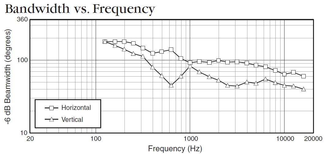

A 30" constant-directivity horn. Hmmm.
Why am I thinking you'll be sticking some midrange drivers onto the sides of that?
(BTW, is that a 1" throat horn or a 1.4"?)

It's a 1.5" throat.
Also...interestin idea for a synergy type horn.
"(BTW, is that a 1" throat horn or a 1.4"?)
The one shown looks like a 1" version (thread-on type), also available in a 1.5" throat, either injection molded (less cost), or fiberglass (bigger bolt circle, higher cost).
"But now that DJK recommends a differnt horn my wheels are turning."
It's a non-standard 1.5" bolt circle, and the minimum JBL uses it is 630hz.
I still love the EV HP640 and HR90, but the sound of the JBL is in a different league.
"My question to DJK is if I build a correct throat adapter for Altec 288 do you think the JBL horn will out perform my HR9040 with the Altec?"
The EV is a top choice for the 288, an adaptor plate would beed to be made to use the 288 on the JBL horn.
I haven't heard the HR9040 next to the 2384, but next to the smaller HR90 there is a non-subtle difference in the sound (beyond the Be driver).
I can't think of how to measure the differences I am hearing.

The shape of the JBL 2384 is similar to the QSC PL-000446GP/PRV clone.
I would imagine their directivity performance to be similar.
It is twice the size so it is quit a bit different.

"The shape of the JBL 2384 is similar to the QSC PL-000446GP/PRV clone.
I would imagine their directivity performance to be similar. "
They are quite dissimilar.
The inside corners of the JBL have a large radius, the sidewalls are not flat, and the dispersion is asymmetrical.
I have a pair of the PRV, they are great $10 value 1" horn.
