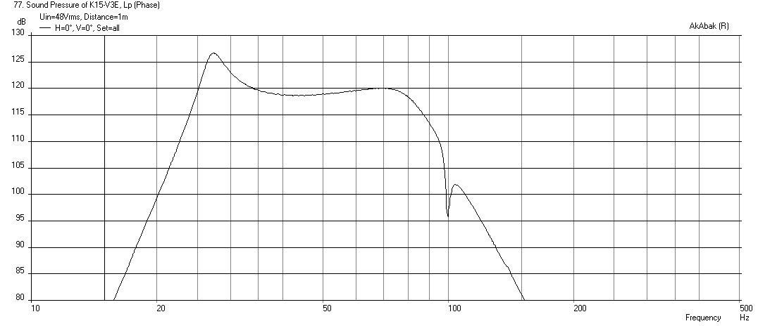

Freddi,
If you are happy with solid 25 Hz extension, you can achieve this using a single Faital Pro 18XL1600 driver in a K15 scaled up to about a 48 in tall x 20 in wide x 24 in deep cabinet, driven by about 600 watts. Stack 4 of these together and you can get 126 dB at 25 Hz and have the clean dynamics and punch that a Karlson is known for. Here is the response from one box (with K-aperture top slit going to a cusp and starting 5.3 inches from the top) with 23 Hz HPF and 80 Hz LPF (48 dB/oct) applied. Interesting result that a Karlson bandpass box can serve as a sub woofer.

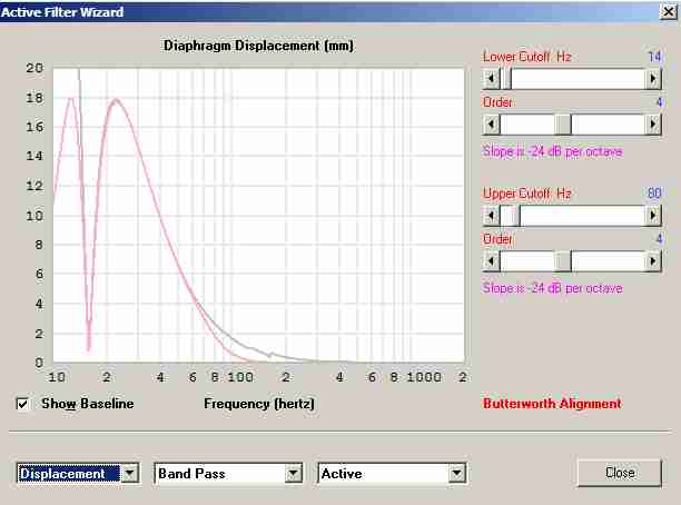

Hi Old Ears,
Happy that got you a step forward. Next - after you get the combined SPL - click on Filter Wizard under Tools, that'll open up the Filter Wizard: for the bottom right window pick Active, for the middle pick Bandpass, and for the left pick Displacement. Now you can set the lower displacement peak to be the same or smaller than the upper one by adjusting the Lower Cutoff Hz in the upper right hand box, and the Order right below it. Switch the lower left hand box to Response, and use the Upper Cutoff Hz and Order to set the upper frequency response.

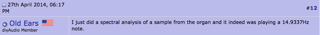

Hello,
A basic question.
Pipe organs often go as low as 8hz.
Have you checked out how low your intended organ goes?
Electronic organs do not go as low as pipe organs.
A basic question.
Yes, Steve did, results in post #12.Have you checked out how low your intended organ goes?

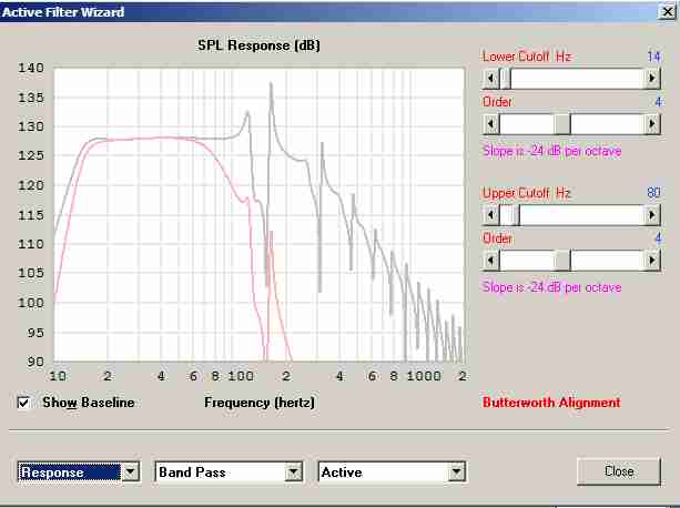

Hi Old Ears,

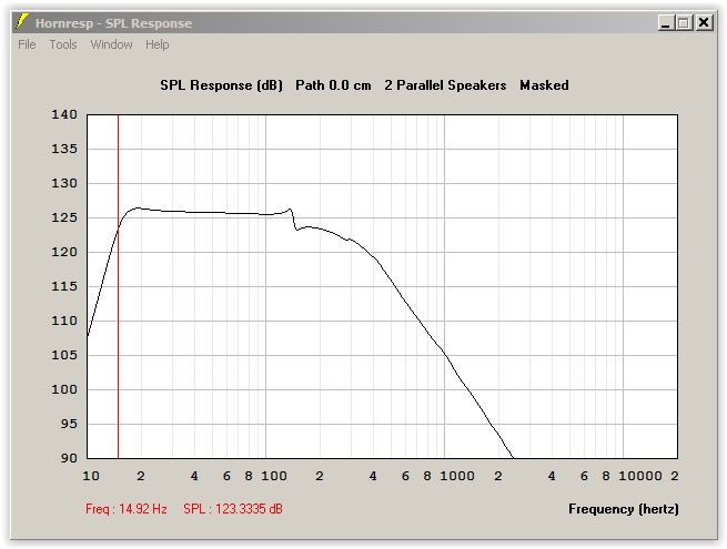

Oliver,
Thank you for your patience. I've been using loudspeaker wizard and filter wizard for some time working with TH. Hornresp is a powerful tool for those of us not ready to jump into Akabak.
Your BR design is perfect for what I need. And even using the $200 Dayton UM15-22 (since the 18 is not yet available) I can accomplish what I need with only 2 drivers. If I don't get a 1pi result from my strange speaker location, I'll just add 2 more.
Thank you again for all your help. It's forums like this that restore my faith in the internet.
Gratefully,
Steve Archer

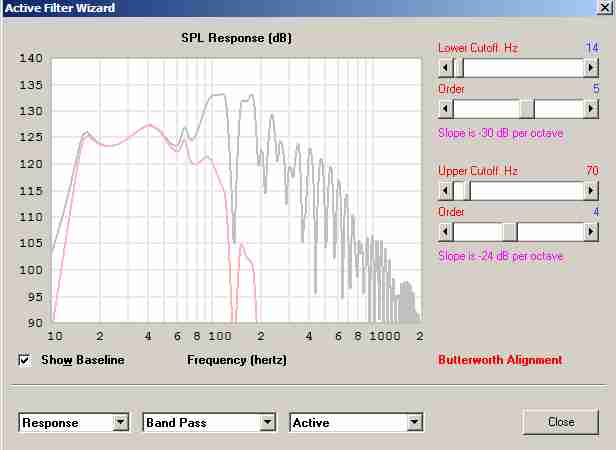

Hi Old Ears,
It might be worth it to wait for the 18" driver, on the other hand if the 15" will do the job you could use a smaller box. Just make certain that you get the port velocity down into a rational range, that's all the output you've got at the bottom range of what you are shooting for. If you decide to give the 15's a try go with four, you'll loose a few dB because of power compression and port compression. Those losses are not accounted for in the simulations.

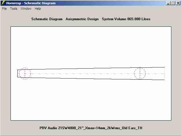

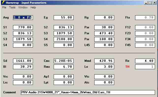

wonder how this PRV performs ? PRV Audio 21SW4000 21" High Power PA Subwoofer Speaker 8 Ohm | 294-2756
Hi freddi,
Post #50:"...PRV Audio 21SW4000 21"..."
This one doesn't want to go that low in a BR, but will get close in a TH, again, would be nice if somebody had any personal experience with this one. It used to be quite difficult to build that large a voice coil, and make it work in the long run, maybe all that has been solved by now.
Hello,
My understanding was that was the existing organ but not the intended organ. Perhaps I misunderstood?

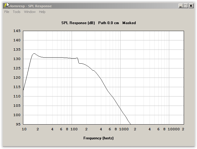

By the way, I've been massaging the BR cab to utilize a 4x8 sheet the best and with a proper high pass and 80 volts (3200 watts!) I can get a theoretical 130db from 2 drivers! Might ought to put an extra fan on that Crown amp. I hope Eminence hits the June release date for the UM18-22.

The UM18-22 is a Dayton product, made in China, Eminence is made in the USA.I hope Eminence hits the June release date for the UM18-22.
22mm Xmax for the published price is an outstanding deal, regardless of where it is made.
