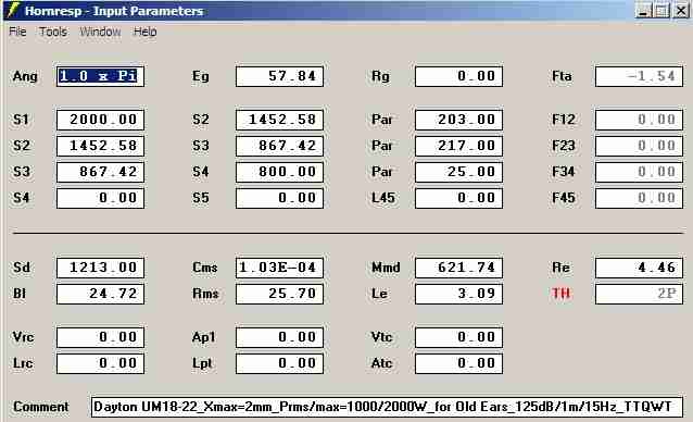

Do you remember this one?
Steve,
What exactly is that a sketch of??
It's not a horn expansion exactly...
I presume it is some variation of a tapped horn??

It's a tapped horn that get's narrower instead of expanding. Just use the dimensions in the drawing and plug it into hornresp. I think you will be surprised. Jbell drew it up as a quick solution for a 20Hz cabinet. Be sure to split the cabinet in two for your sim of 1 driver. I even plugged in an inexpensive Dayton PA460-8 (from Jbell's SS18 cab) and was somewhat shocked at the result.

Hi Old Ears,
You may have noticed, that Hornresp has an Import and Export functions listed under the File tab. So you can just export a Hornresp simulation you'd like to share, and attach it as you did the picture in Post #19.
The other option is to take a screen print of a Hornresp window, and attach that. I like Gadwin PrintScreen, it's available as freeware, or with edit extensions as PrintScreen Pro here:
Screen Capture and Print Screen software
The result would look something like the attached files.

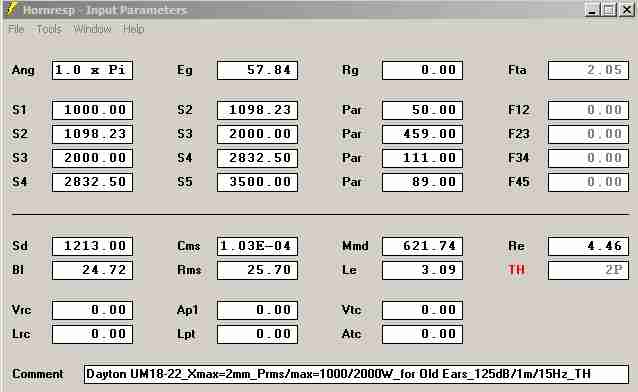

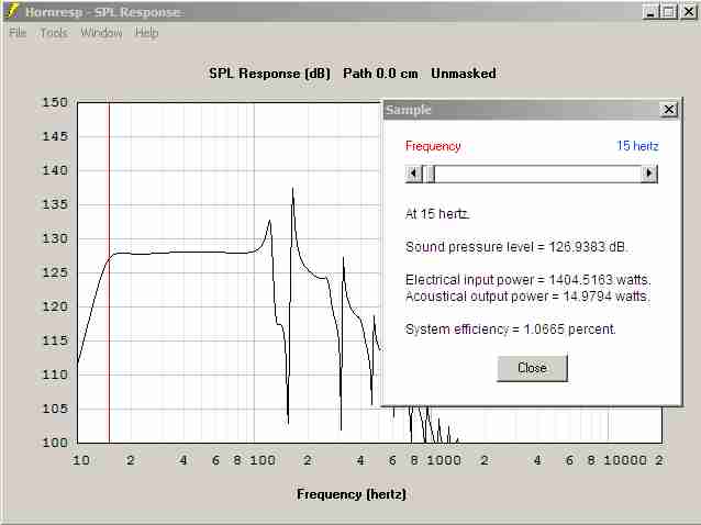

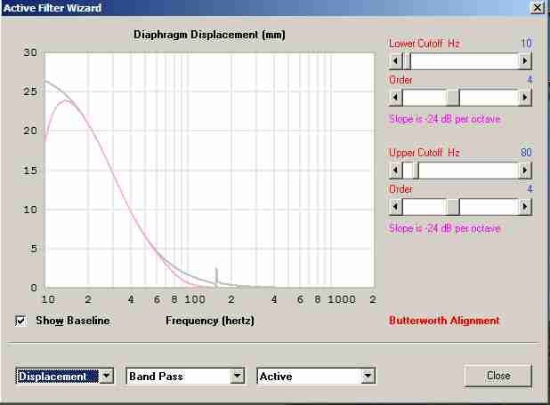

I like jbell's suggestion of the UM 18-22, and I put that one into Hornresp under the assumption that the sub will be radiating into 1.0 x Pi, w/ 1500W into 2.23 Ohms, and used two drivers per sub.
The TH would have a Vnet=1313.50 L; the BR Vnet=675 L; the T-TQWT (the type you suggested in Post 19) Vnet=623 L. All would reach you stated goal of 125dB/1m/15Hz withing Xmax. With the TH having the highest output, and the BR the widest frequency response. The enclosure types all need at least a low cut and a high cut.
In other words w/ four of the UM18-22 you should have the range you are looking for covered easily. After that it's just a matter of looking around to see if you can find a driver that will do the same at lower cost.

Thanks Oliver,
With over 22mm of xmax the UM18-22 can definitely move some air. I love that the TH you did only has a horn length of 23 ft! 😱 But Hoffman's iron law can't be broken. If my speaker location is 1pi then I am home free with 4 of these drivers. I did a BR that was 2x2x4 (453 L) to make it stupidly easy to build but it was just a little too small. Your BR is a much better even if it uses more wood, I adjusted the port a little to make it an easier build. And the BR goes much higher which means I can use smaller boxes up top. And thanks for pointing me to that screen capture program.

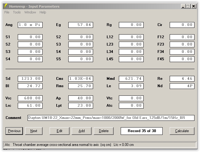

As to the BRs, I felt that the one I quickly simulated (for a two driver box) had a port that was a little too small because a@ the simulated power the Port Outlet Peak Particle Velocity was 25 m/sec, that may be a little high.
Your port tuning is @ 8.23Hz and the port outlet velocity is about 135m/sec @ 10Hz and coming down to 15m/sec @ 40Hz. That's not a workable port. We are talking about very high power (excursion) 18" woofers tuned very low. You'll need at least an 8"Dia. port per driver or better larger. It should be possible to integrate a shelf port into the enclosure design that reflects that; i.e.: port area for a Dual at least 650 to 1000 cm^2, port area for a Quad at leat 1300 to 2000 cm^2. I think that's one reason why the T-TQWT is such an inviting design, as it is based on a relatively large port to begin with.
By the way, what is the size of the opening into the room that is available for the speaker outlet?
Great that you can post Hornresp stuff now!

Oliver,

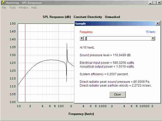

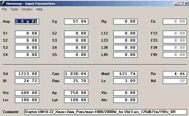

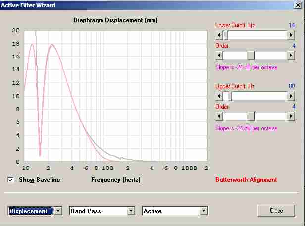

I just did a sealed box for 2 drivers at 650 L and it may be just right with a 10Hz 48db high pass. Check it out. It's 48"x48"x19". The speaker chamber has an opening that is 9' wide and 7' tall. We have an old Crown Macro-Tech MA5002 that weighs 77lbs that would love to drive these speakers. It's just been in storage for years.
Steve
PS Would it be stupid to build one big box with all 4 drivers in it?

Hi Old Ears,
Seems like you're getting the hang of this.
The CB (closed or sealed box) will not get to your 125db/1m/15Hz target, the BR will. The BR will also have slightly lower excursion (displacement). You could reduce the size of the CB quite a bit and not loose much at 15Hz; e.g.: cutting the volume in half will really reduce the displacement w/o loosing a lot of SPL.

Oliver,
In the BR I have to tune the port so that the Helmholtz freq is 10hz to get the maximum output at 15hz. But, the port is only 150 cm2 and 110 cm long. Why does the CB sim as well as the BR with the small port? If I use a larger port it really messes with the response negatively unless the port length is like 4 feet long. I'm not getting the port tuning thing at all.

In Post #31 I posted the SPL comparison between the 650 L CB you posted, and a BR in the same volume. In the range that you specified as your target range the BR (faint gray line) outperforms the CB (bold black line) by a wide marging (10dB). Using the Sample tool you can step yourself through the simulation results one Hz at a time.

...you are using the Combined Response after clicking Calculate?
That was it! Thanks, Oliver
