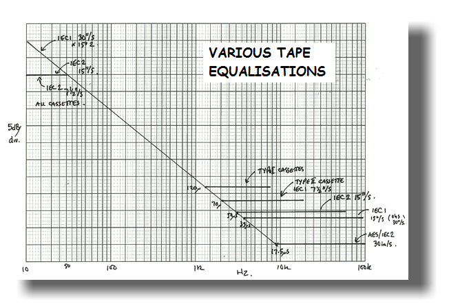

I have a reproduce EQ circuit here that I cannot figure out. Here's a .pdf of the Otari's service manual screen shot and the circuit I put into LT Spice. It is supposed to give an adjustable high frequency equalization; but in fact LT Spice says it just gives a HUGE low frequency boost. I have shown the circuit in LT Spice as it would occur in High Speed, with Q107 turned on and Q106 and Q108 off. What am I missing?

That is the standard Otari tape equalizer circuit, it has switchable time constants for LF EQ (NAB/IEC) and two HF time constants, but I think you are missing part of the EQ which may appear in the next stage. (There is also a preceding stage in this particular design IIRC.) Massive LF gain and a shelving gain function determined by the HF time constant zero.
This isn't the LF compensator circuit which is normally a pretty cheesy baxandall bass control in the next stage.

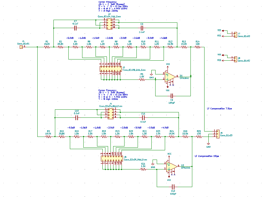

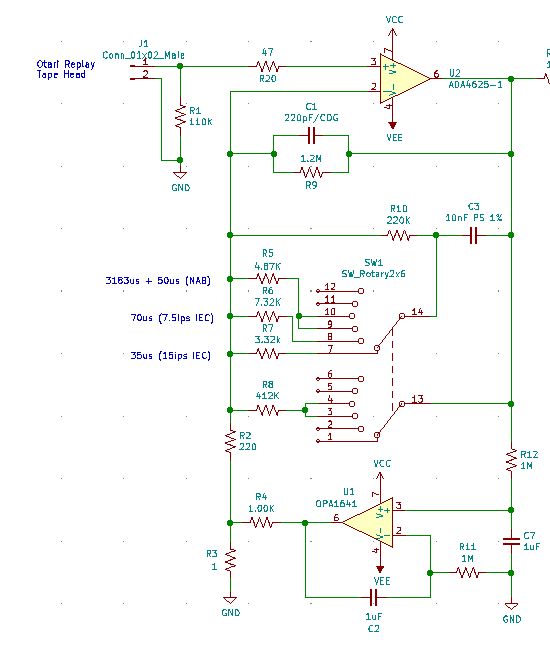

I've attached a capture of the front end amplifier stage in one of my tape amplifiers, and the LF compensator, you will note there is one for each speed and there are both multiple gain settings (attenuation only) and three different frequency options.
It does help, but the Otari heads would benefit from more sophisticated compensation, it is however unlikely the effort will be rewarded with results justifying the effort given the component and design quality of the rest of the deck.

I would have thought the deck would already have these stages, you actually don't need any more of these for head bump correction. You need the sort of thing I show in my LF correction circuit.
The deck does have the HF repro circuit I have shown, plus a LF Compensation circuit that is really just a LF shelving filter. These allow you set the deck to be flat at 100Hz and 10KHz to match the repro level setting at 1 KHz. These do NOT, however, address the rather large LF bump---+2 db @ 65 Hz and -1.8db @ 130 Hz. THAT is what I am attempting to cure. Many other decks have a similar malady and is commonly referred to as 'contour effect' or 'secondary pole effect', as it evidently is cause by the secondary pole formed by the head geometry--the length of the pole face, the length of the face window, and the shape of the lamination behind the head face. (This is from the Nortronics paper on magnetic heads). My Studer A810, for instance, also shows some of this, but nowhere near as much as my Otari 1/2" 8-track; with my Ampexes being somewhere in between these two.

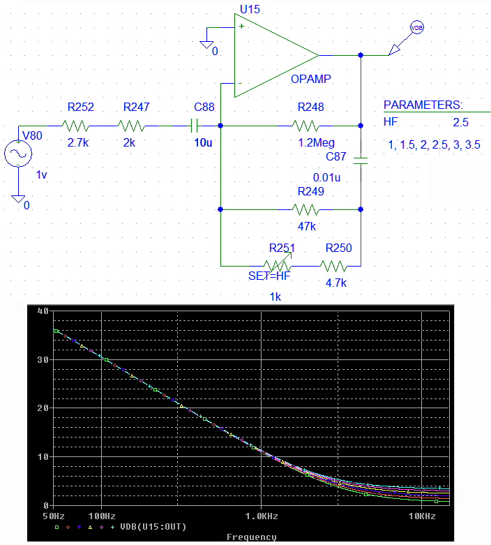

Show your work. We can't know if you are setting appropriate control voltage, polarity, signal level, circuit. Or what your expectation is. (And BTW, the slope is not "tape" but "wound head" correction). Compounded by the sketchy state of most audiotape literature (the NAB curve omits the slope and does not mention the fact).
I put the first JFET i found in a 2-decade old copy of a SPICE suite and quickly plotted from 135 Ohms at zero gate to mighty darn high at -3.3V gate. (It computed Gigs which is barely possible on plastic pack, certainly hard to confirm in real life, and totally moot around few-Kohm resistors.)
