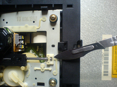

Hello All,
I have just replaced the laser unit (KSS-240A) of my Arcam alpha 9 CD player. The player had started to skip within tracks and it now appears that I was listening for a good part to the player’s error correction instead of the actual bits on a CD. I had almost forgotten what a great CDP the alpha 9 actually is. With the new laser it really sounds much better than it did even before it started to skip.
I’ve wanted to do this for quite some time but I was afraid to damage the player and I wasn’t sure whether the new unit was plug and play and I wouldn’t quite know how to adjust it. Anyway, the replacement proved to be very simple. Using a sharp knife, I cut out a small piece of the plastic bit that holds the slider axle at one end and then the axle can easily be slided out of the laser unit. The little piece I cut is pointed at in the picture below. I cut it such that it remained connected to its thin plastic extension that is also visible in the picture. Then I lubricated the axle, slided on the new unit, reconnected the ribbon connector and put the cut out piece of plastic back in place and applied a drop of superglue on its thin extension to secure it. That’s it. It can be done in about 15 minutes.
The picture was taken after the replacement. The new unit I purchased was plug and play and didn’t need any adjustment. There's no solder bridge and the only antistatic precaution I took was touching the metal frame of the CD player a few times during the operation (just don’t wear woolen socks). 🙂

Pleased you have had success with this. Yes the KSS240 is essentially plug and play. Static isn't much of an issue because of the on board circuitry effectively providing a low impedance across the laser iode itself.
The plastic you cut 🙂 the other end of the metal slider actually has a moveable piece of plastic to allow the rail to move forward. That frees it from the end you cut and it can then be pulled free. No matter. Well done !

There is no mechanical alignment, its all electrical as I show in that thread of mine.
Taken from the thread,
The KSS240 has three presets mounted on the pickup. APC (automatic power control) or "laser power", FB which is "focus bias" and TB which is "tracking balance". TB is also more correctly or universally called E-F balance. At the end of this post are two short zip files containing videos of actually performing E-F balance.
You don't ever alter the one marked APC. It is the laser power and is factory set.
FB or focus bias is important and should be adjusted using a scope. An experienced technician can adjust this by ear by listening to the noise produced by the pickup itself and find the point where there is a null in the white noise produced. You will see in the thread that I have extra length trimming tools to reach these while playing.
TB can only be done with a scope.
The bottom line is that you should be able to replace the pickup and get a fully working player without altering anything but you also have to bear in mind that repairing and adjusting players is also a skill that requires knowledge of all the theory (so you can interpret the results) the use of proper test equipment and tools.
