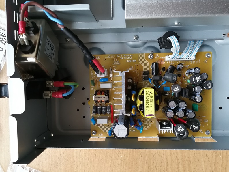

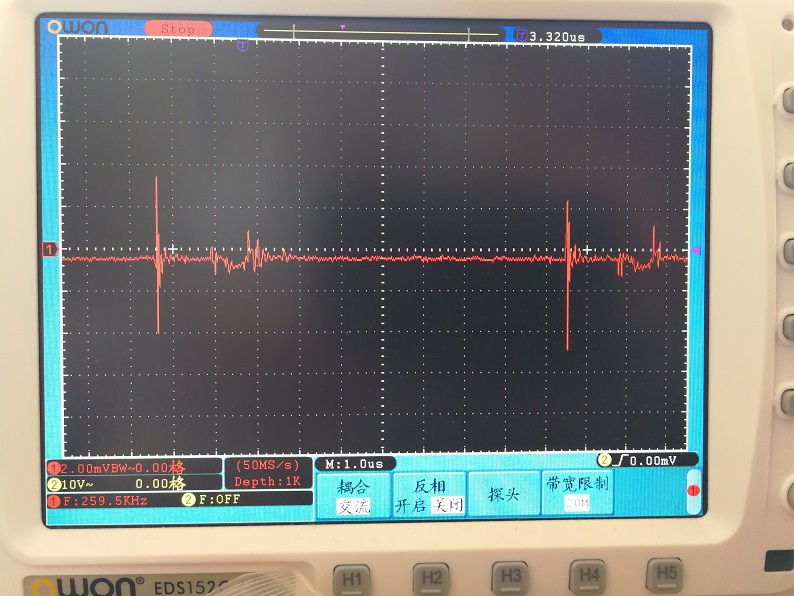

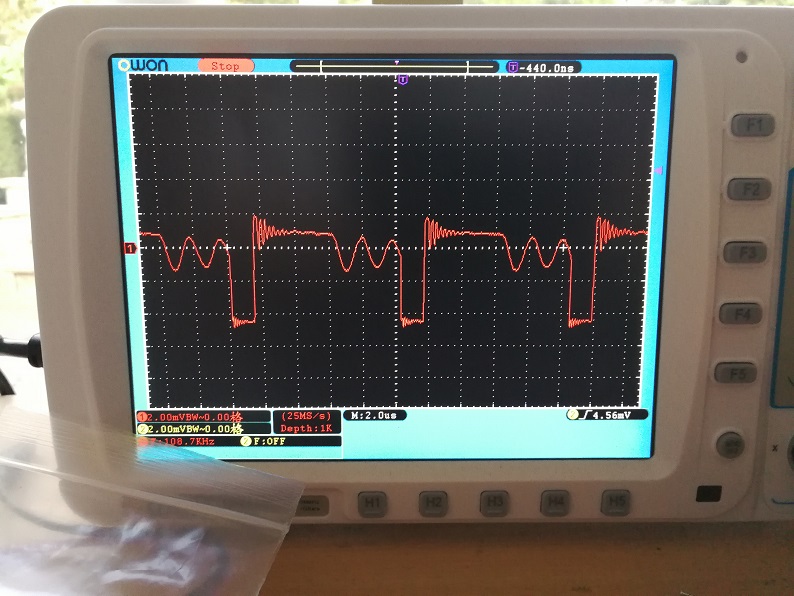

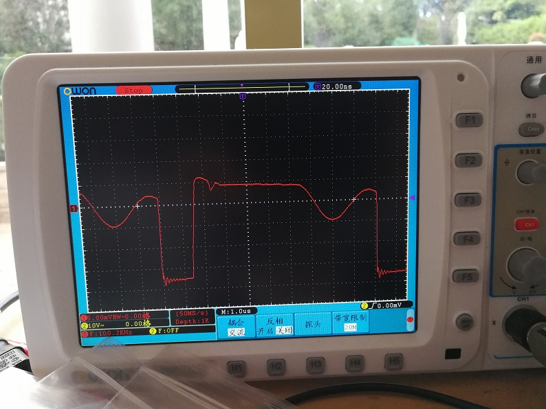

Many thanks to you for your help and guidance. After considering your advice from the other thread, I went ahead modifying the player and changed it from Class II to Class I in order to allow further suppression of common mode noise. This improved the sound of the player.
Below are some pictures.
1. The wave form before upgrade.
2. The wave form after upgrade.
3. The upgraded board.
4. Ground noise after upgrade. It is still there but reduced.

My guess is that PCON is 0V when the player is turned off. Then only the 5V standby rail is on, which powers up the remote control command board. All other rails are turned off. When I turn the player on by pressing the On button on the player or on the remote control, the remote control command board sets the PCON to 2V, which then activates all other rails. Of course, it is only my guess after spending limited time on the service manual.
I have just spent some time studying the service manual and the schematic.
I think that the player's CONTROLLER is powered by the +5VSTB standby rail all the time. When the player's ON button is pressed, it may first do a number of things then change PCON from 0V to 2V. The 2V on PCON opens a NPN transistor which turns on the +5V rail. At the +5V rail output, a voltage divider provides 1.6V to the base of a NPN transistor which turns on the +12V rail. Then a zener and resistor combination at the +12V output turns on another NPN resistor which turns on the -12V rail.
So basically, all rails other than the +5VSTB are turned on at the same time (or in sequence with a very small latency).
When the player is turned off, obviously the CONTROLLER does a number of things first then changes PCON from 2V to 0V. This turns off the +5V rail first. When the +5V rail output capacitor is discharged, the +12V rail will then be turned off, after which, when the +12V rail output capacitor is discharged, the -12V rail will be turned off. There is also a small latency between these steps.
