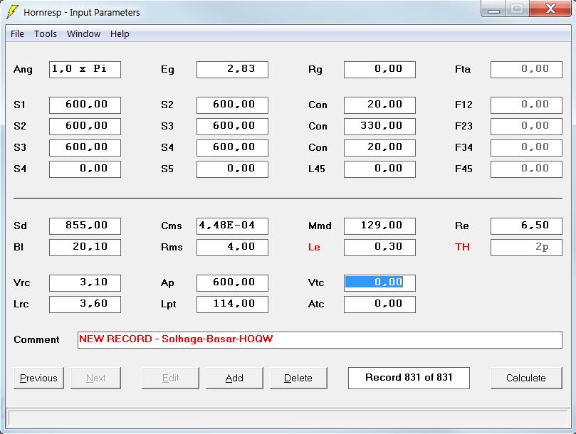

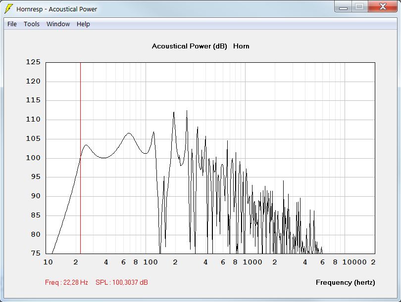

Hey, thanks for pointing this out (I cut /paste it all ) if I get to go into JPEG mode I’m good, because that’s so easy to operate and move around. I appreciate it and sorry about the phone pic thing . That’s been an issue on bulletin boards and forums forever sometimes you’re able to change the aspect ratio of the photo I think, but I’m rotating it intentionally to catch the 2 part HR screen fully which might be a bad idea, and not worth it if it’s bugging you 😀😀
If this form let us correct things after the fact I could fix those right now….

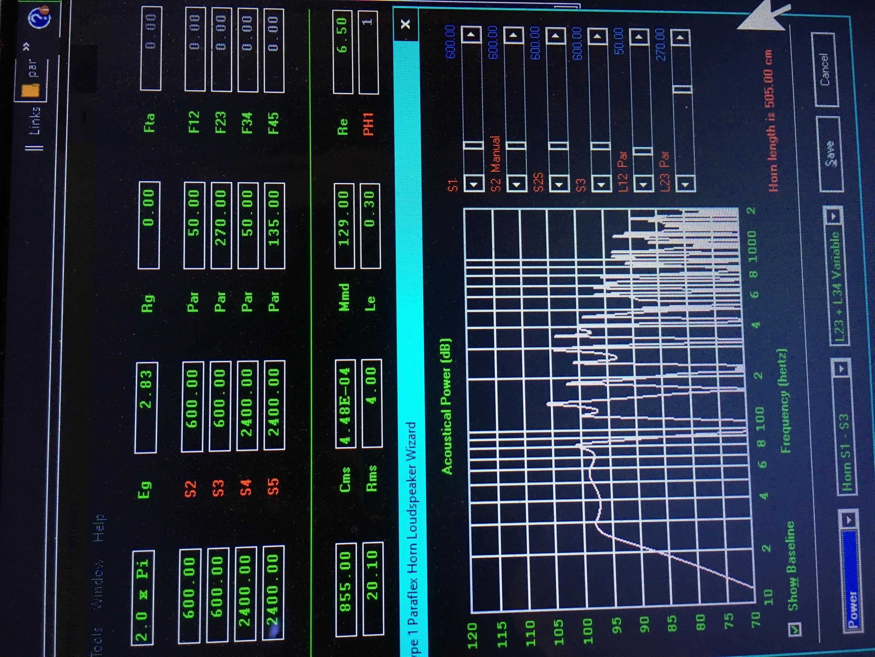

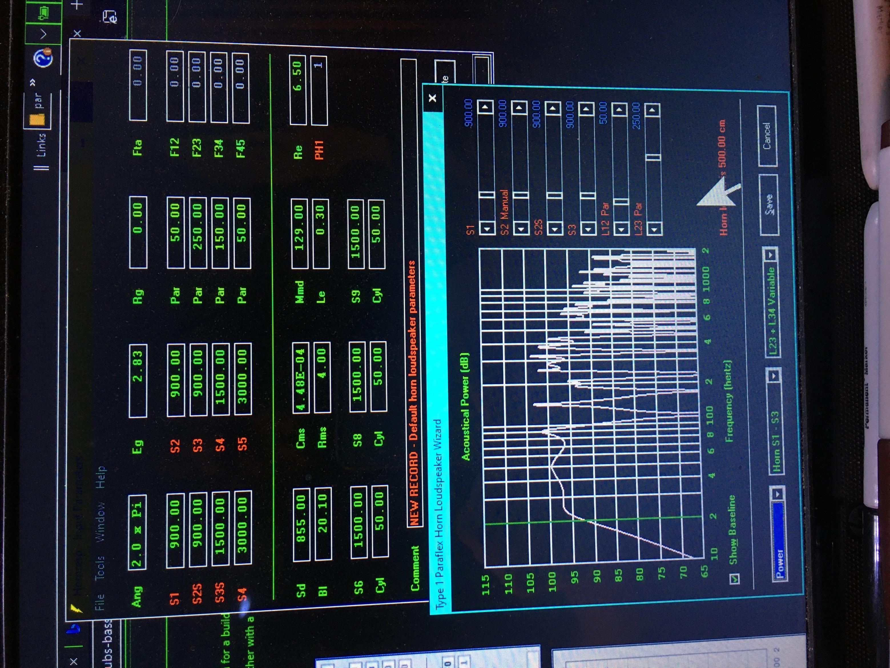

Yeah I fall into that zone as well on drivers. Some make some really really crazy fun looking things but just became so gigantic to cater to the VAS and to drag that down and take a vantage of that low FS and really see where to go and when you it at something that clearly was where it wanted to .. be it’s so huge and And often daunting as it what’s going to really be able to push those gigantic columns in here and not summers in the park cross the imaginary boundary of push of bulk and all of that hard to say I guess maybe the size limitation at some point is helping us make a decision instead of wasting wood and the frustration of finding out the hard way
Measured distortion is actually quite low in a properly designed Paraflex .... USRFobiwan ("Plippie Plop" on Facebook) has proven this time and time again with his measurements ......
Group Delay is also tame and well behaved in a properly designed Paraflex (which is also something else people have made faulty assumptions about) ...... Moral of the story is that it is best not to assume anything😛
For those of us who don’t want to use FB, do you have any examples that you can share please? Ideally with the measurement conditions.
I think that many of the ‘distortions’ associated with alternative subwoofer loadings than the more common reflex and sealed type fall into the same kind of ‘not well defined’ psychoacoustic categories that Earl Geddes (and others’) research into subjective evaluation of things like THD and IMD.
I’m always looking to learn more on this front, and data on stuff that is fast becoming popular would be very useful. Klippel & Powersoft have shown that systems designed around resonance can compensated with smart electro-acoustic vettical integration, but you've got to quantify and model those things beforehand.
