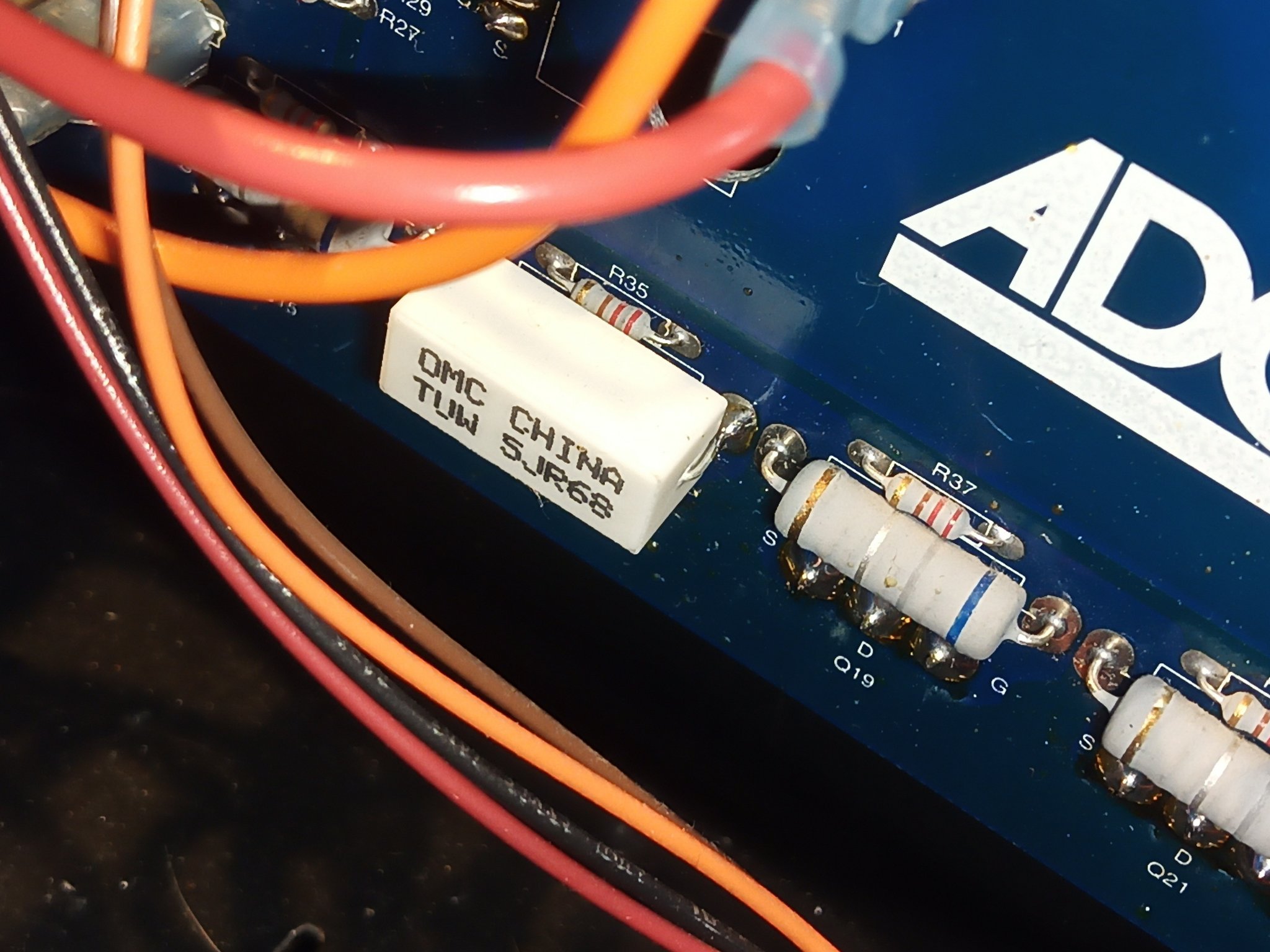

There is actually a big difference in voltage between most of the 0.68ohm resistors. Yesterday I let I idle (with no load) for about one hour and then measured all of them. The highest voltage was 92mV! The lowest 51mV. R50 and R51 measured both 60mV.
So that would mean the there is also a big difference in current...
And suddenly I saw this! A resistor that does not match the others. Looks like someone replaced the original one time.
Guess this does not cause any problems and the value is the same?

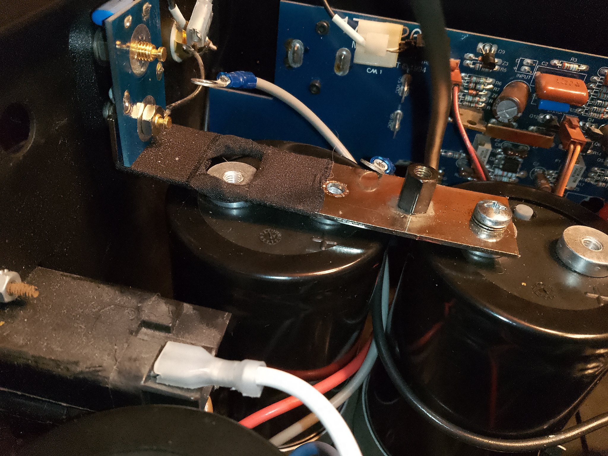

I have just replaced the filter caps with new ones, 22000uf and are reassembling the amp.
I have one question. Why are the caps directly connected to the negative speaker output by the metal bar? I have never seen something like this in an amplifier before
There could be many reasons and not necessarily what you might expect.
Cost... it could be cheaper than wires and terminations.
Mechanical integrity... it secures the caps mechanically. That is probably the real reason imo.
