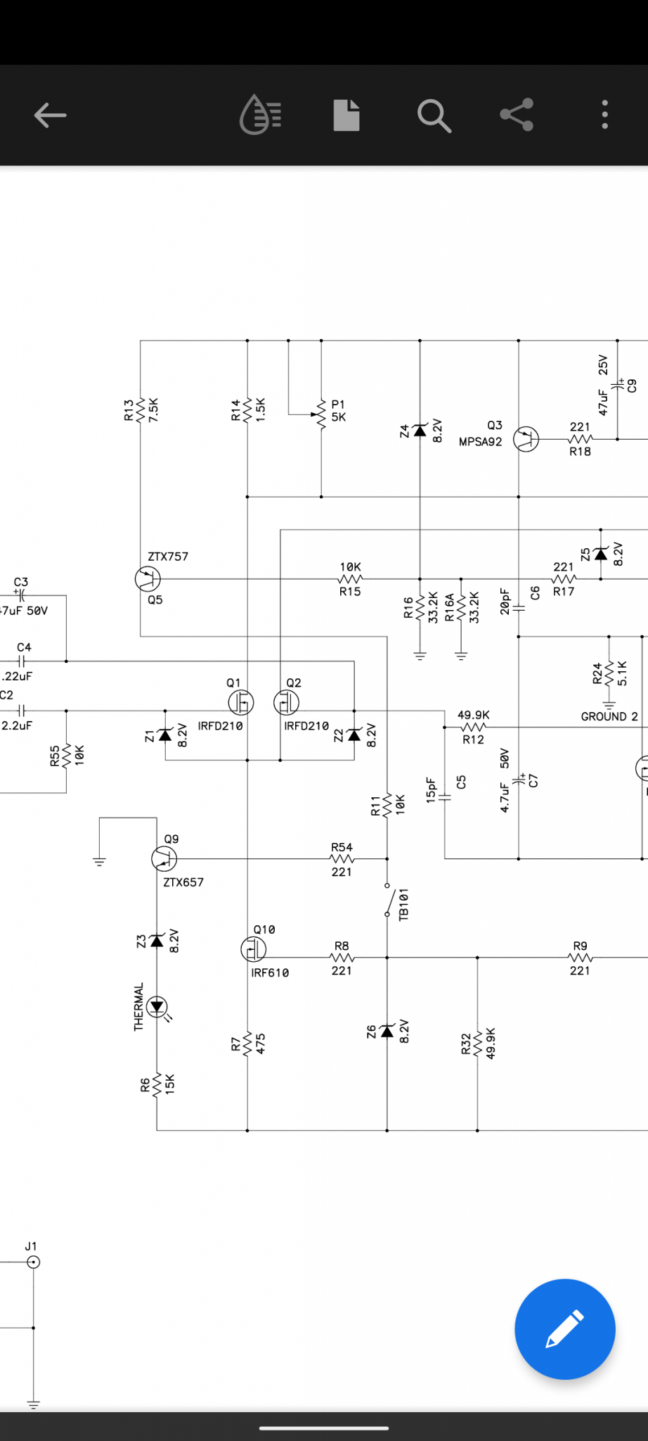

The two IRFD210 MOSFETS on the input long-tail-pair of the GFA-5500 run pretty hot, and the solder connections get cracked from thermal cycling, which can cause noise. Perhaps it doesn't make the noise without the input terminated by the preamp...? Anyways, the fix is to re-flow the solder joints, and affix a small heatsink across the two of them with thermal epoxy. There is supposed to be a copper bar here already, but they often fall off. The heatsinks I use are meant for DIP-14 or DIP-16 packages, and it cools better than the stock copper bar.
While you're at it, the eight 1000uF/100V caps are problematic in this model. They cause weak bass when they go bad. Go for something 105C, meant for power supply duty not "Audio" grade.
Are those the Q1 and Q2 you are talking about? I will take a look at them.
What is the correct way to adjust bias on this amplifier? In the service manual it says there should be measured ca 50mV between resistor R51 and R52, but I have read some place that this is incorrect! It's R50 and R51.
I have bought 4 low noise fans and will be mounting them on the heatsinks, two on each side. I also want to check the bias voltage, maybe setting it at bit higher to 60mV
There is a nice thread about this amp on avsforum. There a guy adjusted bias to 72mV without any problems
Its actually the same difference :) Look at the circuit.
Ideally the current should be the same in each 0.68 ohm resistor (and you have ten of them) but in practice they may differ because of differences in the FET's.
50 mv between an upper 0.68 ohm and lower 0.68 means that I=V/R or 0.050/(0.68+0.68) = 37 milliamps is flowing in that pair. Its hard to immediately visualise but it doesn't matter which upper and lower set you use because they are all the same.
Set the bias with no load attached because a small DC offset can skew the result.
