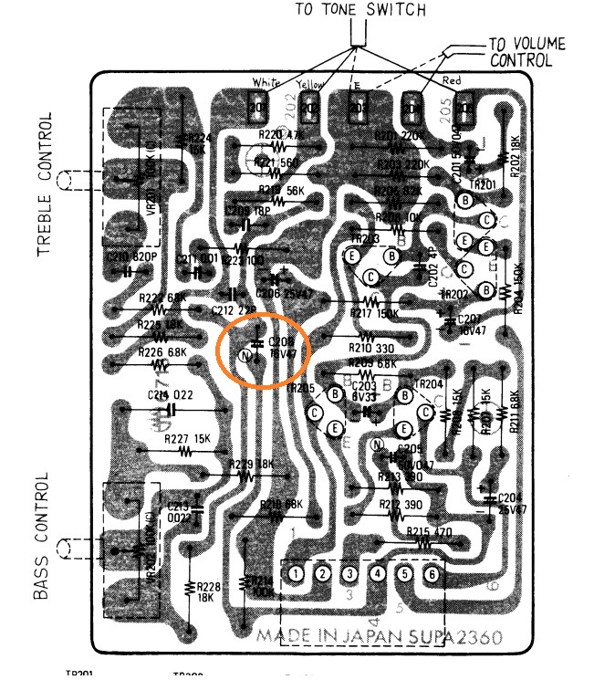

That 33uF cap is the negative feedback dc blocking cap.
A non-polarised electrolytic like the Nichicon Muse (as mentioned earlier) is good. Film are better but usually huge and you don’t want it to act like an antenna for noise at this sensitive point in the circuit.

It;s a Technics SU-3500.
The cap I want to change is the 33uf polar one .
I posted a photo showing the cap location .
Yes, these caps are worth replacing. Certainly not with BPs and God forbid, not with films. Depending on your taste, Nichicon FG, Panasonic FM, Silmic are all valid, good sounding options, which will to some extend improve the sound. Worth replacing any single coupling cap as well and the 33uf nfb decouplers in the riaa. If money allows, go for the main filtering caps too.
