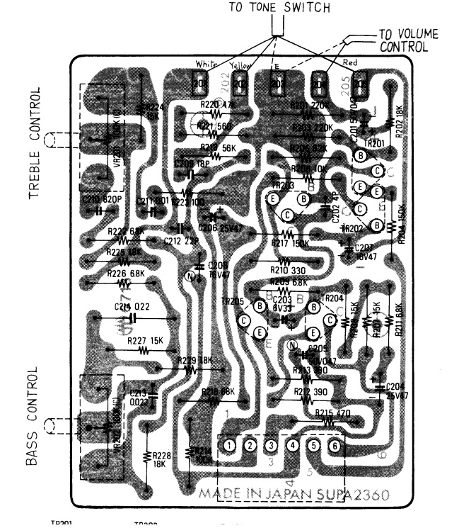

The cap I want to change is the 33uf polar one .
I posted a photo showing the cap location .

What do you think about the 47uf NP cap showed in this photo ?
This is located on the tone circuit board .
What effect have this cap in the circuit ?
