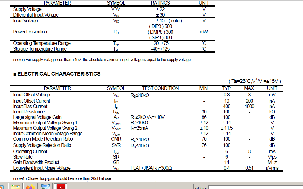

Its a confusing datasheet. I think they are saying the 20kHz bandwidth input-refered noise is 0.9µV with a source impedance of 3k3, probably using an RIAA network. About 75 SNR for a 5mV signal.

Interesting---this preamp uses the exact same IC (HA12017) that is employed as a magnetic tape reproduce head amplifier in my Otari MX5050 tape machine; they also conclude, as I have, that this IC is too noisy to use alone to amplify a very low-level signal (~2 mV at maybe 2KΩ source impedance)); They utilized a transistor-based gain circuit to amplify the signal to the point where the HA12017's noise is not a factor. I am trying to select a modern IC that will replace the 12017; so far it appears that the old NE5534A may be the best. I am trying to interpret the noise figures quoted on the HA12017 datasheet (HA12017 Datasheet PDF - Datasheet4U.com). It's confusing, as they quote two figures---one with an RIAA equalization, and one with a 40 db amplifier. Anyone able to decode these datasheet figures into voltage and current noise density?

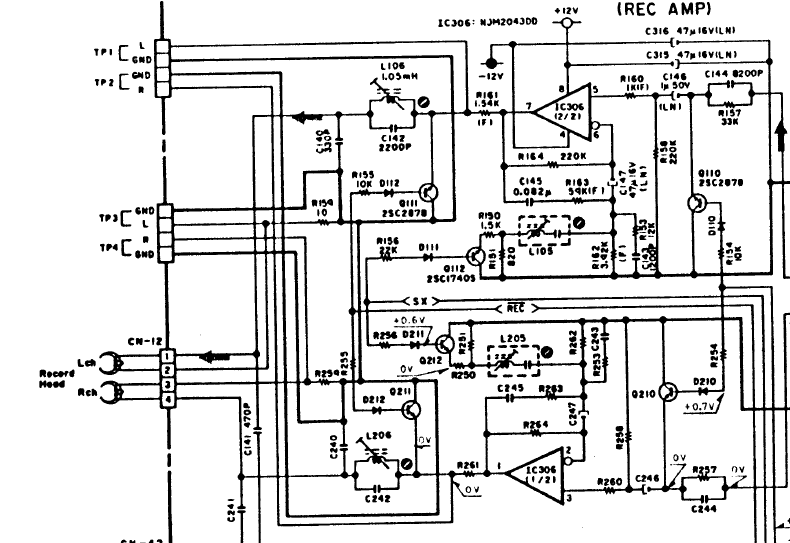

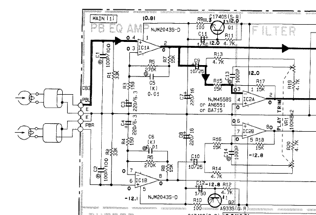

njm2043 can do something that none of those op-amps can: it will work with VCE-0.25 v output offset ! Its slew rate is good enough, its combined noise is actually lower than NE5532, its 400ohms drive...
Below you have Yamaha KX-930 tape play head preamp , and Nakamichi CR-4(all Nakamichi dragon, zxl-1000 have the same schematic on that side) rec head amp...you might argue that the tape noise is masking njm2043 noise, but you need to build something based on bjm2043 to really understand what it is.
