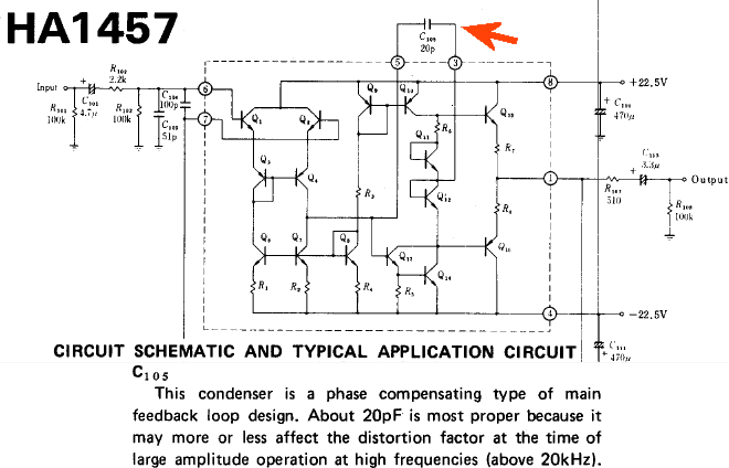

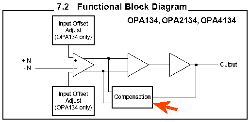

Hello, I just found this thread. I know it is old... but I have a similar project. You guys gave good ideas here. Thanks. But what happened to the 20 pF capacitor connected between pins 3 and 5 in the original HA1457 (pic attached)? I understand it is ignored / unnecessary. Thanks.
...what happened to the 20 pF capacitor ....
"It's in there".
The HA1457 required an external compensation cap. The OPA2134 has the compensation built-in.
There's history behind this change but you don't need to study it.
"It's in there".
Ok many thanks. That explains well. I've seen that diagram in OPAx228 (it is very low noise 3nV/SQRT(Hz) but doesn't use FET inputs). I will use the OPA134 to replace the HA1457. Thanks.
