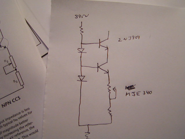

So would the HV NPN CCS be the ticket to solve my problem?

For a diffamp tail I always use cascode BJT current source.
A single transistor current source has 2 problems.
1st its output impedance is limited by Early Effect. This can be mitigated by using higher reference voltage on the base and hence higher emitter (current set) resistor in the emitter. As a "rule of thumb" you need an absolute minimum of 450mV being developed across the emitter resistor but more is better (This sufficiently addresses thermal effects and starts to mitigate Early Effect).
2nd the single transistor current source output impedance drops significantly as you increase frequency due to device capacitance. This will show up as lack of detail in the top end and loss of image. The way to address this is to use a cascode.
Aside: In an early "Baby Huey" I ran a single transistor current source, Red LED reference, for the front end diff amp. Changing to a cascode gave an immediately noticable improvement to top end detail, smoothness and stereo imaging.
The frequency limitation is the main reason why I've never been a fan of LM317 and similar devices as a current source in low level signal areas. They just don't present the output impedance to a high enough frequency due to output capacitance.
For the same reason (output capacitance) it is important to keep wiring between the CCS and the tube cathodes "short and sweet" to minimise stray capacitance.

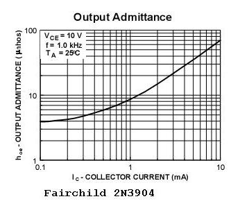

Hi Forum, Jorge and SY
It is wrong to tell something like a typical transistor constant current source has...
Better have a look at the datasheet.
http://www.datasheetcatalog.com/
hoe is the admittance of the current source with Re (emitter resistor) = 0.
You can read this value from the attached graph.
You can see that 1/hoe is ≈100KΩ at 1,3mA.
You can calculate the resistance of the constant current source
in the following way:
((Re x Ie/UT)+1)/hoe = r output
In this formula
Re is the emitter resistor
Ie is the emitter DC current
UT ≈ 40mV (Silicon)
hoe is the collector and emitter admittance, see attachment.
r output is the resistance of the constant current source.
Now start calculating, you'll be surprised!
Kind regards,
Darius
Re: calculating a BJT ccs ...
Hi, Darius
Not surprised at all, I already know that the resistance looking in the collector of a Bipolar Junction Transistor, even without emitter resistor, is very high and can be considered a "almost perfect" CCS.
At 1,3 mA the intrinsic emitter resistance is ~ 20 Ohms, if as stated early in this thread, the output collector resistance was the product of (hfe)X(Re), for a output resistance of 100Kohms we must have a hfe of 5.000... 😉

Please calculate it, and you'll be surprised. 😉
Tube_Dude said:
Hi, Darius
Best Regards
Thanks for the example.
Just forget SY's formula, it is totally wrong here.
Kind regards
Darius
