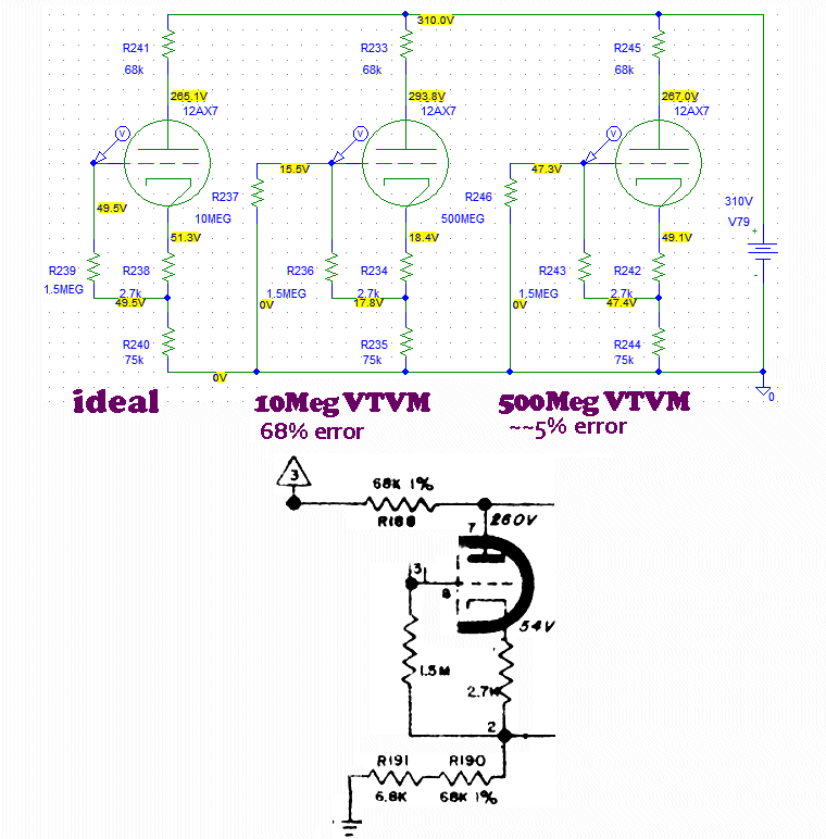

Are we talking about the same tubes and pins? I'm referring to pin 7 on the 12AX7s immediately before the output tubes. I get 19.5VDC and 17.7VDC on those pins. I do see 68VDC on pin 8 of those same tubes (the schematic can be a little hard to read).
I'm trying to figure out why I see high grid voltages on pin 7 of those tubes and pins 2 and 7 of the cathode follower immediately after the phono section.

The grid (pin 7) and cathode (pin 8) voltages of the 12AX7 will be very close, within a volt or so of each other.
The elevated grid DC voltage is due to the self-bias network for the 12AX7, and is correct.
All cathodyne phase splitters will have an elevated grid voltage unless the cathode resistor goes to
a negative voltage instead of ground.
The 6EU7 cathode follower after the phono stage is also self-biased in the same way, and should have
about 48VDC on its cathode.

However, the disparity is far greater than 1V. For the cathode follower, I see pin 2: 27VDC; pin 3: 50 VDC; pin 7: 34VDC; pin 8: 75VDC. For the phase inverters, I see pin 7: 17.7VDC; pin 8: 59VDC on channel 1 and pin 7: 19.5VDC; pin 8: 58.2VDC on channel 2.
And a clarification: when I wrote "I do see 68VDC on pin 8" in the previous post, I meant that I see 68V on the schematic (rather than 58V). The measured values are as above (59VDC and 58.2VDC).
Strange voltage readings like that can be caused by the loading that the voltmeter makes on high impedance circuits, like those around 12AX7's. What kind of volmeter are you using?
If you have two voltmeters, you can confirm whether or not this is the case by fixing one voltmeter from cathode to ground, and observing changes when connecting and disconnecting the other voltmeter to grid.
It's common to measure voltages around valves at the anode and cathodes only, and to *infer* grid voltage from those.

......the disparity is far greater than 1V. .....or the phase inverters, I see pin 7: 17.7VDC; pin 8: 59VDC on channel 1 and pin 7: 19.5VDC; pin 8: 58.2VDC on channel 2......
You can not measure these grids directly!! Not with any meter in the house.
Cathode follower, Cathodyne, Fender Long-tail. If self-biased, touching the grid with any material meter throws the grid voltage WAY down. There is a lot of leverage here.
Here is a Sherwood (maybe not the right one) with "no" grid-loading (normal operation), a 10Meg load (you poking a VTVM at it), and an unlikely high 500Meg grid load (nearly electrometer territory). The plain VTVM pulls 49V down to 15V. This can be computed forward or back to find the no-load condition but it is a brain buster. You have to go to 500Meg to get a mild 5% error, and such meters have troubles. (We can do it inside sealed microphone heads, but dirt and moisture never sleep.)
On these stages, just check the cathode voltage! If that is nearly right (almost never critical) then the grid will be right when you are not poking it. So don't bother to poke it.
