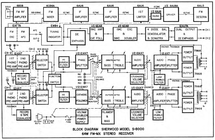

Replacing 12AX7 tubes in Sherwood S-8000 preamp
On the schematic that voltage is 58VDC.
Are we talking about the same tubes and pins? I'm referring to pin 7 on the 12AX7s immediately before the output tubes. I get 19.5VDC and 17.7VDC on those pins. I do see 68VDC on pin 8 of those same tubes (the schematic can be a little hard to read).
I'm trying to figure out why I see high grid voltages on pin 7 of those tubes and pins 2 and 7 of the cathode follower immediately after the phono section.
You might also look at the connection to the tape record jack on channel 1 (pin 8 of the cathode follower). Somehow, that doesn't look right to me.

The grid (pin 7) and cathode (pin 8) voltages of the 12AX7 will be very close, within a volt or so of each other.
The elevated grid DC voltage is due to the self-bias network for the 12AX7, and is correct.
All cathodyne phase splitters will have an elevated grid voltage unless the cathode resistor goes to
a negative voltage instead of ground.
The 6EU7 cathode follower after the phono stage is also self-biased in the same way, and should have
about 48VDC on its cathode.
Thanks for the info. I figured that there was some reason that these (and only these) grids showed elevated voltages.
However, the disparity is far greater than 1V. For the cathode follower, I see pin 2: 27VDC; pin 3: 50 VDC; pin 7: 34VDC; pin 8: 75VDC. For the phase inverters, I see pin 7: 17.7VDC; pin 8: 59VDC on channel 1 and pin 7: 19.5VDC; pin 8: 58.2VDC on channel 2.
And a clarification: when I wrote "I do see 68VDC on pin 8" in the previous post, I meant that I see 68V on the schematic (rather than 58V). The measured values are as above (59VDC and 58.2VDC).
Strange voltage readings like that can be caused by the loading that the voltmeter makes on high impedance circuits, like those around 12AX7's. What kind of volmeter are you using?
If you have two voltmeters, you can confirm whether or not this is the case by fixing one voltmeter from cathode to ground, and observing changes when connecting and disconnecting the other voltmeter to grid.
It's common to measure voltages around valves at the anode and cathodes only, and to *infer* grid voltage from those.

The plate voltage on pin 1 of the CF is a little puzzling. Pin 1 and pin 6 are fed by the same 282V source. Pin 6 connects straight to the source; there's a 47K (actual 51K) resistor between pin 1 and the source. The schematic says that pin 1 should see 180V; that seems a huge drop across that resistor. Since pin 3 is close to spec (50V vs. 48V), is it reasonable to speculate that might just be another error in the schematic?
It's also not clear if the 9-10V difference between spec and observed at the cathodes in the PI is anything to worry about. I'm kind of inclined to think that since both tubes exhibit similar behavior, that may be acceptable.
The auto-ranging feature on the meter was mentioned. That can be turned off and a specific scale (Ω, KΩ, MΩ) selected. Would it change anything to do that?

......the disparity is far greater than 1V. .....or the phase inverters, I see pin 7: 17.7VDC; pin 8: 59VDC on channel 1 and pin 7: 19.5VDC; pin 8: 58.2VDC on channel 2......
You can not measure these grids directly!! Not with any meter in the house.
Cathode follower, Cathodyne, Fender Long-tail. If self-biased, touching the grid with any material meter throws the grid voltage WAY down. There is a lot of leverage here.
Here is a Sherwood (maybe not the right one) with "no" grid-loading (normal operation), a 10Meg load (you poking a VTVM at it), and an unlikely high 500Meg grid load (nearly electrometer territory). The plain VTVM pulls 49V down to 15V. This can be computed forward or back to find the no-load condition but it is a brain buster. You have to go to 500Meg to get a mild 5% error, and such meters have troubles. (We can do it inside sealed microphone heads, but dirt and moisture never sleep.)
On these stages, just check the cathode voltage! If that is nearly right (almost never critical) then the grid will be right when you are not poking it. So don't bother to poke it.

The cathode followers are strange because one channel is actually a phase splitter. Back in those bad old days it was (at least thought) possible for one channel to be out of "phase" (actually, polarity) with the other. The switch to the right of the upper valve half (in my very, very poor schematic copy - sorry, can't read the number) does that. Some amplifiers had provision for flipping one speaker's polarity; this one does it in the preamp line stage.
Measurements within 20% are almost always plenty good enough. We normally don't know how the original measurement was taken, or even if it were taken - the number might easily be a design center - and our own measurements inherently change what's being measured.

I thought I'd attached a copy of the schematic earlier. I guess I didn't. Sorry about that. Maybe this version is more readable.
I thought the combined CF/phase splitter was a bit outside the box myself, particularly when I started looking at different resistors in the two sections (i.e. there is no plate resistor on channel 1, and the cathode load resistors are different). When I look at the readings, though, they're pretty close, so I'm guessing that these values were chosen so that both settings of the phase splitter switch would yield the same output from that triode (which would match the output of the other triode).
The strange thing about all of this is that I retired this receiver ~35 years ago because it kept blowing fuses, and all of this poking and measuring hasn't come up with any obvious failure point. I suppose that I should replace the filter caps, death caps, and add a polarized cord as a matter of course, but I still haven't got the a-ha! moment which would explain the fuses.
