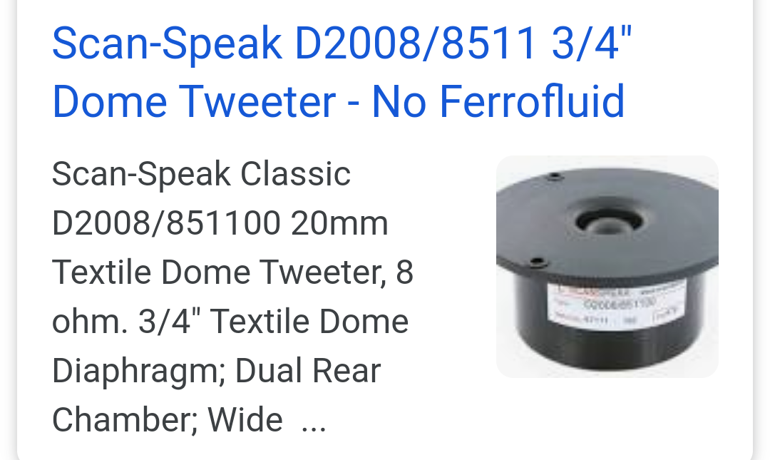

The D2008 from scan speak resp. Hiquphon's OW-1 is a very good replacement, but the sound character isn't the same, therefore the question in post #1. Nevertheless many thanks for all information so far.
