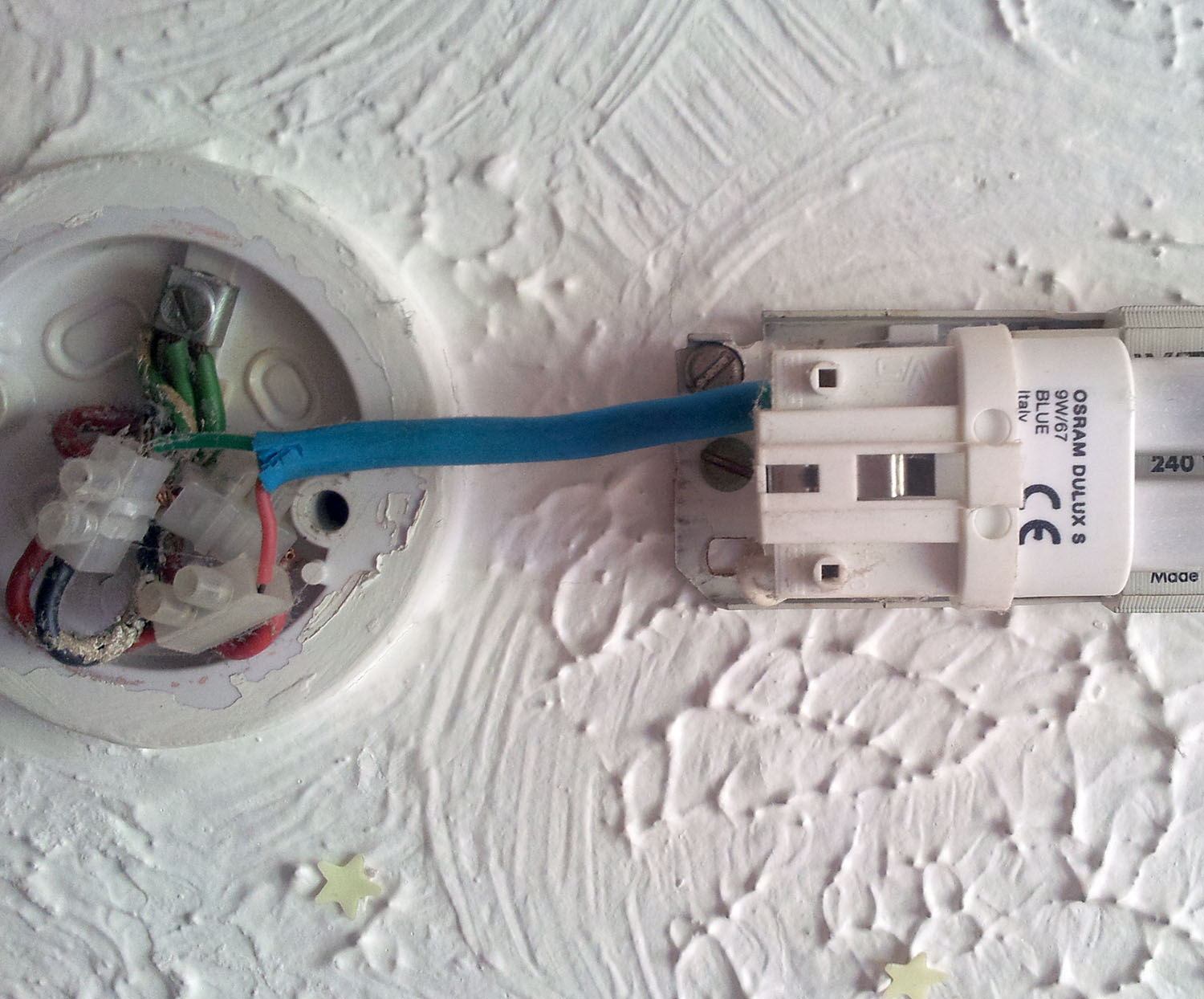

Hey Mike, that speaker cable was called 'live wire' I think, and I still have about 4 inches left as I used it to wire up a ceiling lamp !

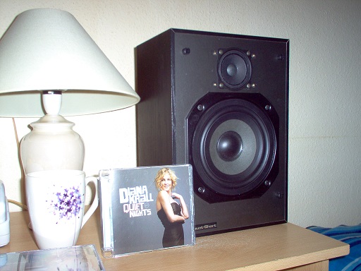

All good fun, BarbieBoy. I've spent the last three days on my little ones. They're cute, IMO. 6" bass plus cone tweeter. 😀
They sounded terrible. Harsh. I did about 6 builds. Finally got it. A 8.2R + 1uF Zobel across the tweeter was what they needed. Now they have pace and rythym and a laid back feel. 😎

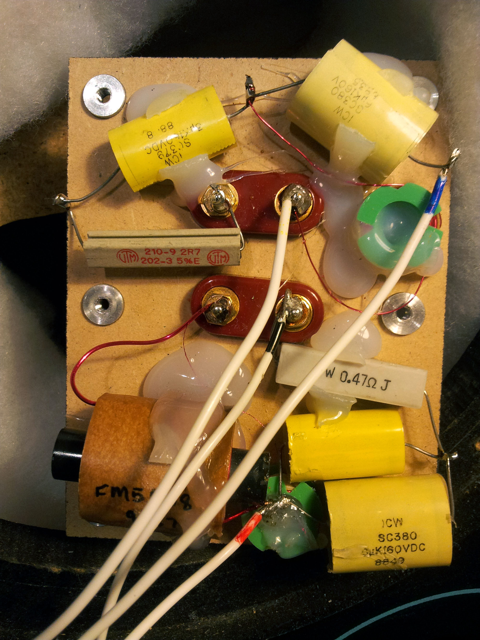

I'm looking at renewing the caps and Falcon are asking for a tolerance to be selected ?

When designing crossovers, I'd never worry about getting nearer than 10% even with a notch. That's why you go for the nearest preferred value. Resonant frequency of an LC circuit is the root of 1/LC.
So 10% change in value produces a 5% change in frequency. I don't suppose film types vary much.
Preferred values are stuff like 2.2uF, 2.7uF, 3.3uF, 3.9uF, 4.7Uf, 5.6uf, 6.8uf, 8.2uF, 10uF, 12uF, 15uF, 18uF, 22uF. Falcon and Wilmslow have that.
I wouldn't have use for anything closer. Same for coils and resistors. With resistors, I just get biggish 10W wirewound types because they work for everything.
A rougher range like Maplin's, frequently stocked is 2.2uF, 3.3uF, 4.7uF, 6.8uF, 10uF, 15uF, 22uF. That can be problematic.
Occasionally you encounter 10uF, 12uF, 16uF, 20uF and so on.
The price hikes with 250V, 400V, 630V and 1000V. But curiously, I find smaller cheaper 250V types have some advantages with build size and a theoretical smaller common-mode crosstalk and interference, and are my current weapon of choice. 🙂

The ones in the MC4s are 3.0uF and 6.0uF @160VDC, so these Claritycaps @250V should do the trick
3.3uF and 5.6uF would be an imperceptable change. I'd do that if it saved money. 🙂
Can't see the point of changing the values just to save pennies. Got other things to explore like speaker cables and changing the power valves on my amp
