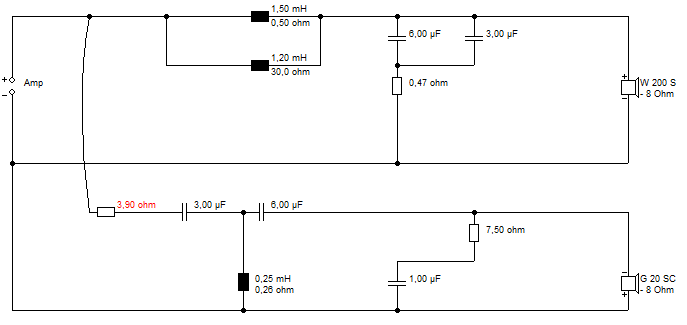

The tweeter X/O is third order electrical, 2R7 on the input, then 3mfd, 0.22mH, 6mfd. Bass is a weird kind of 2nd order - it has 9.87mH in parallel with a 1.2mH inductor which has 30R resistance - cap is 9mfd.

The bass had 6mfd and 3mfd in parallel to make 9mfd - and I forgot earlier, a 0R47 resistor in series - I'm doing this from memory and haven't seen the x/o for about 10 years...

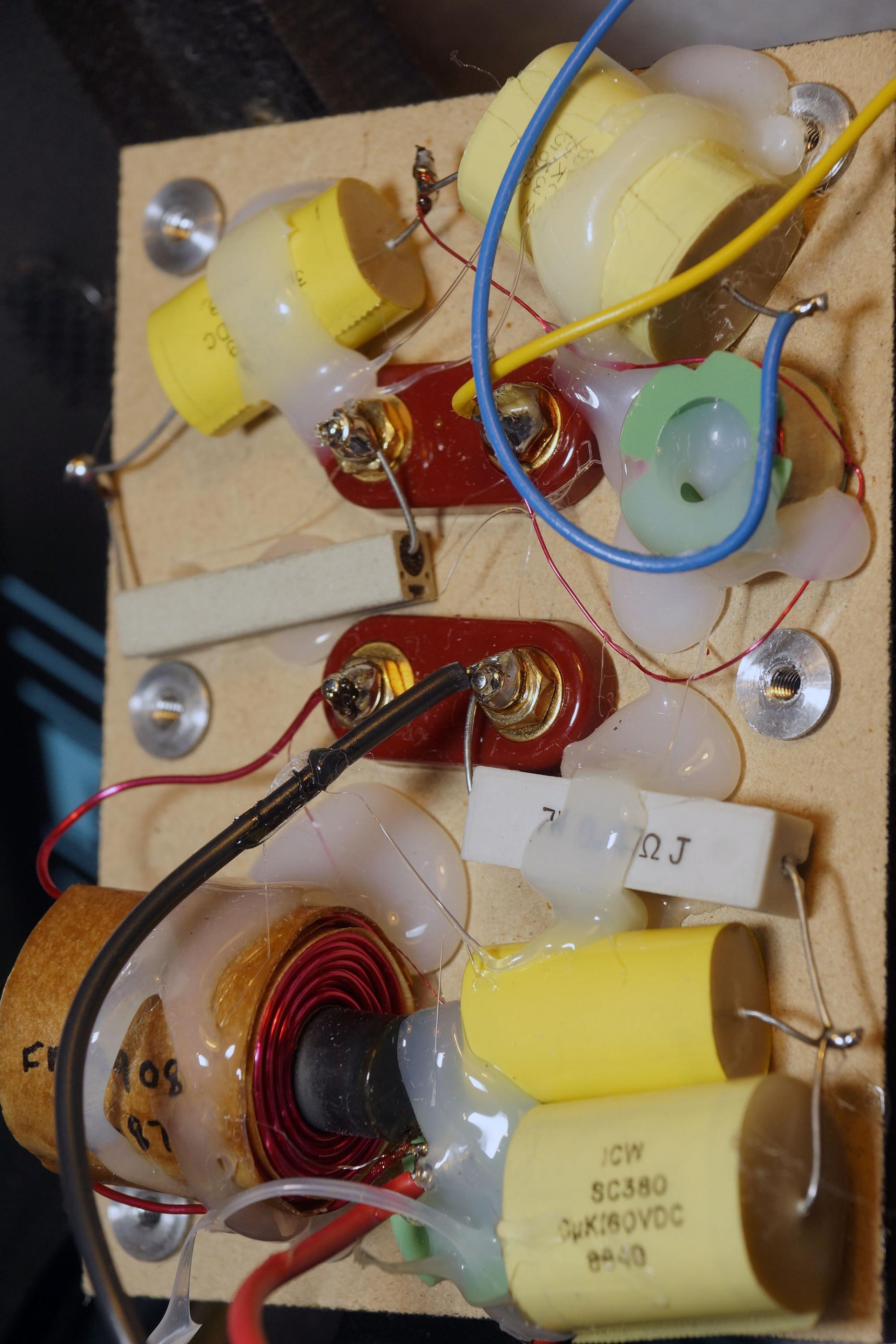

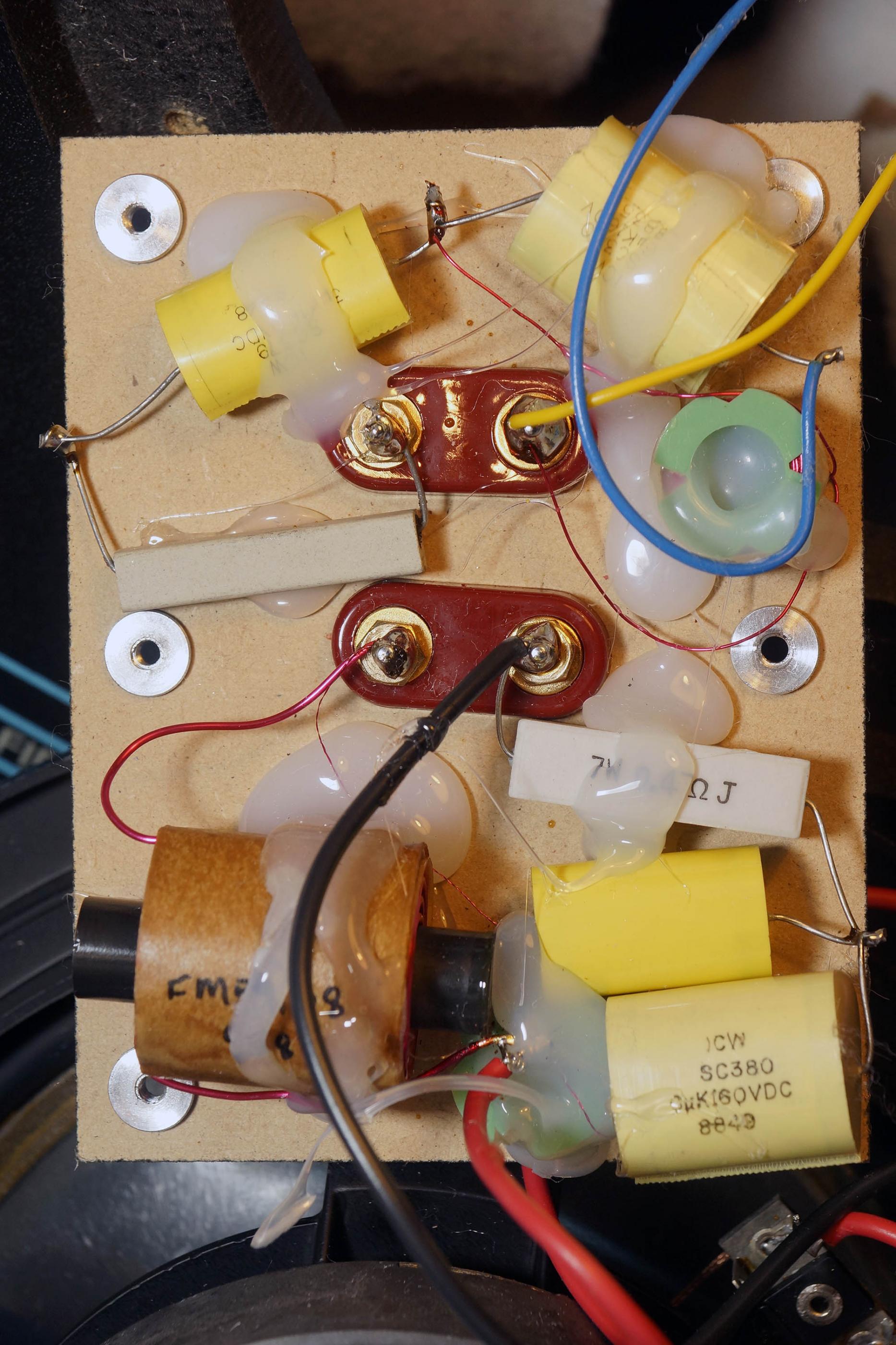

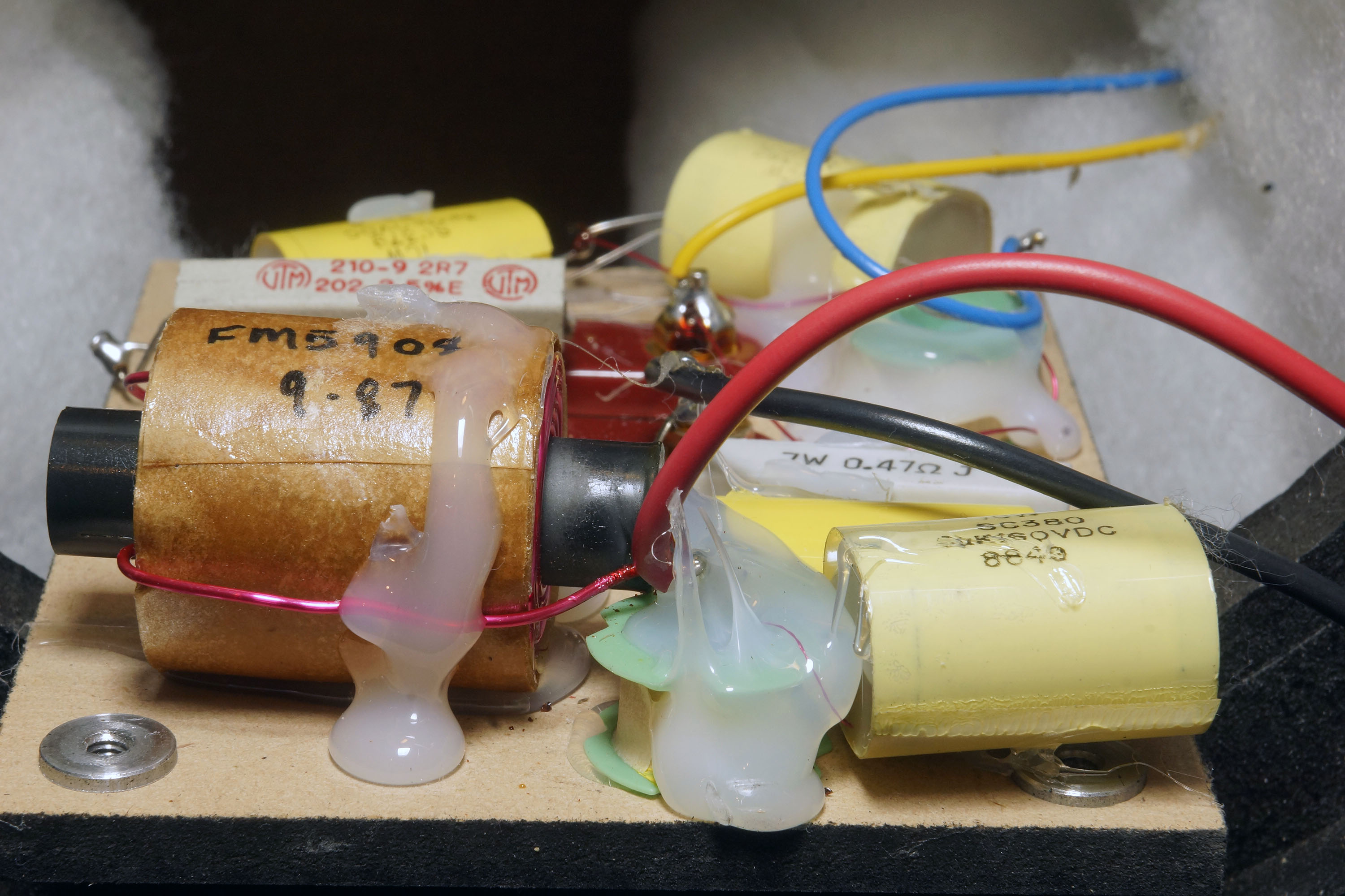

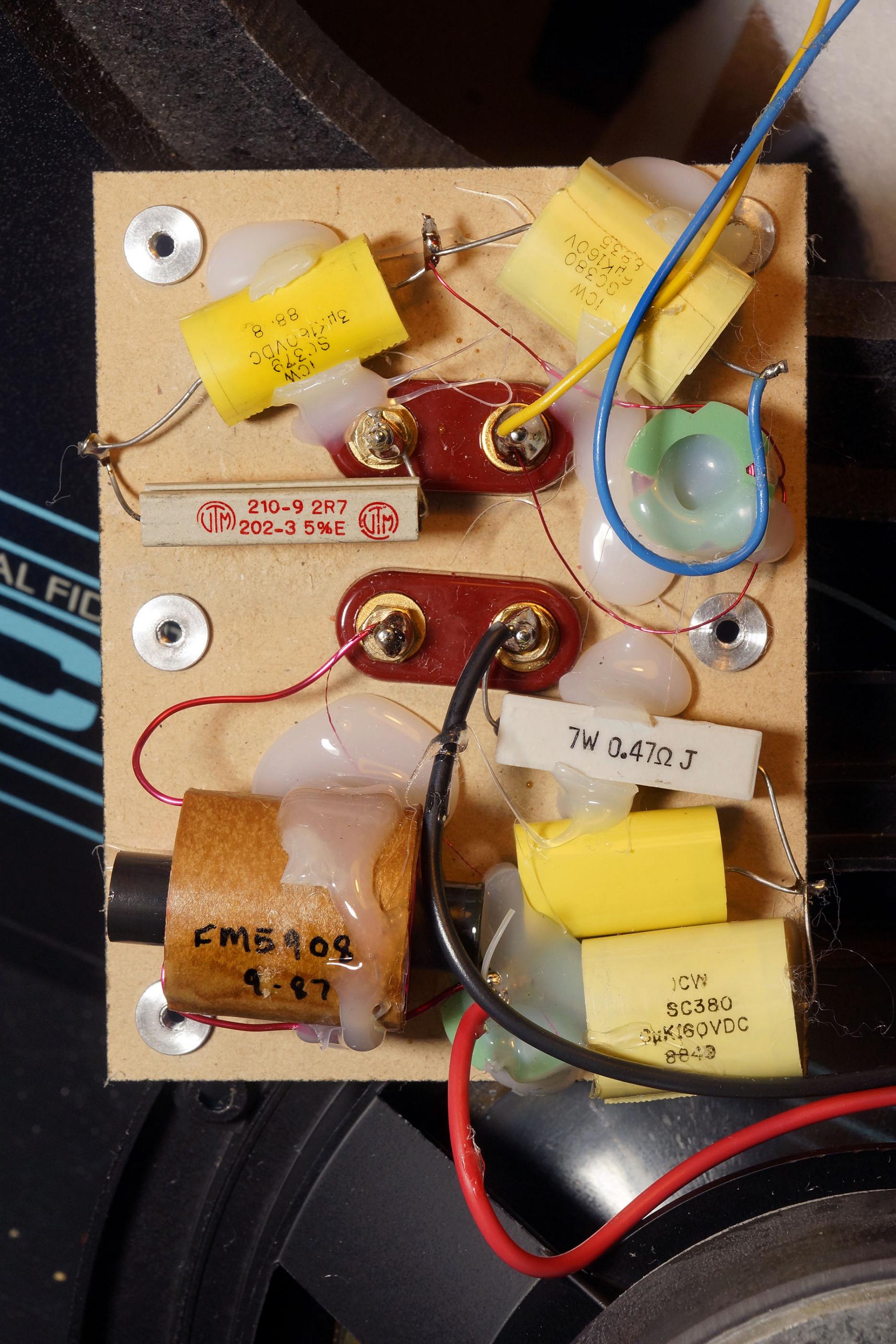

Ok guys, as promised photos of my MC4 (V1) crossover. Hope someone can make some sense of whats under all that glue 😉

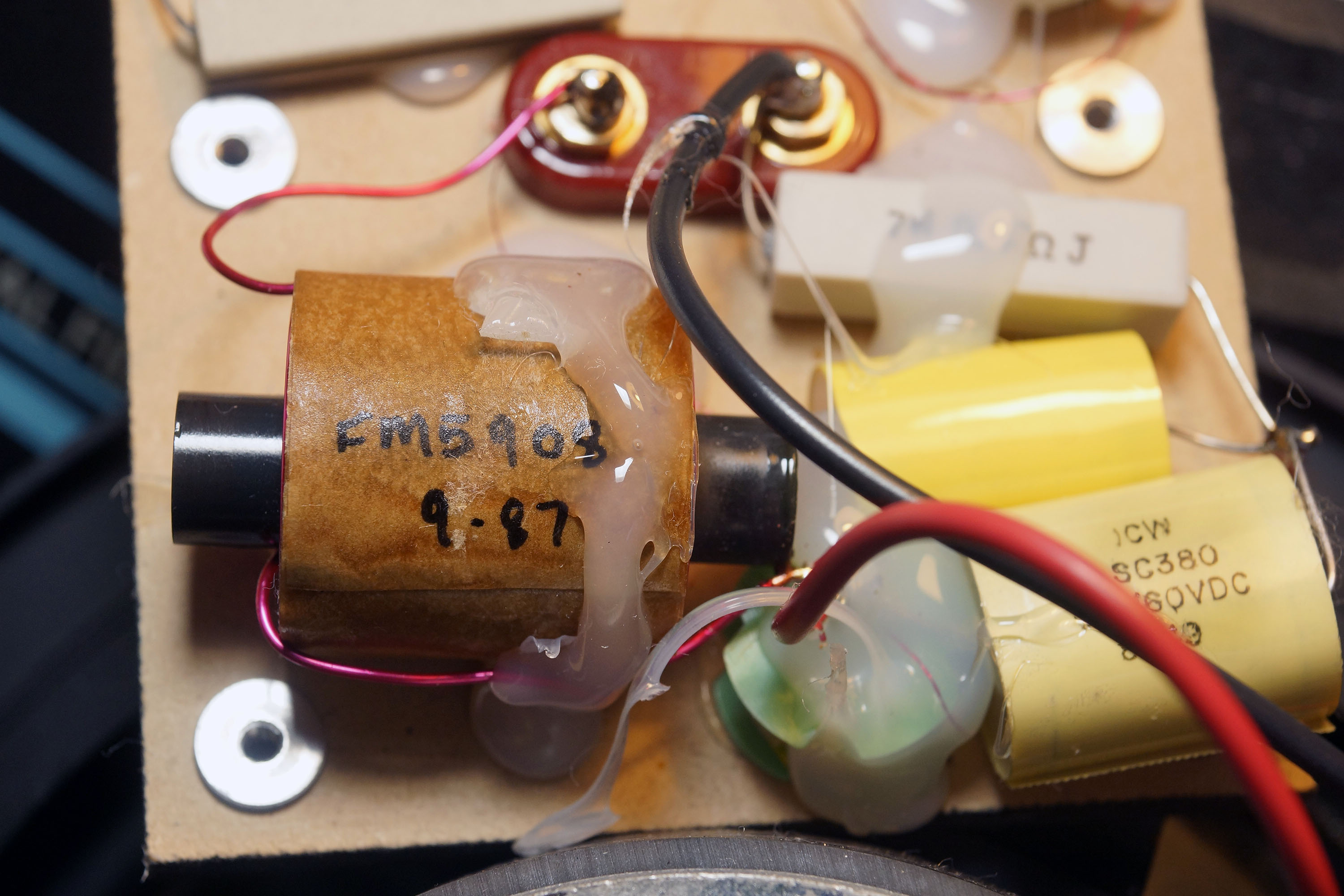

What I'm coming up with is below. I'll ignore a 9.87mH coil. That makes no sense, it's too big a value. Maybe they've deliberately obscured the value.

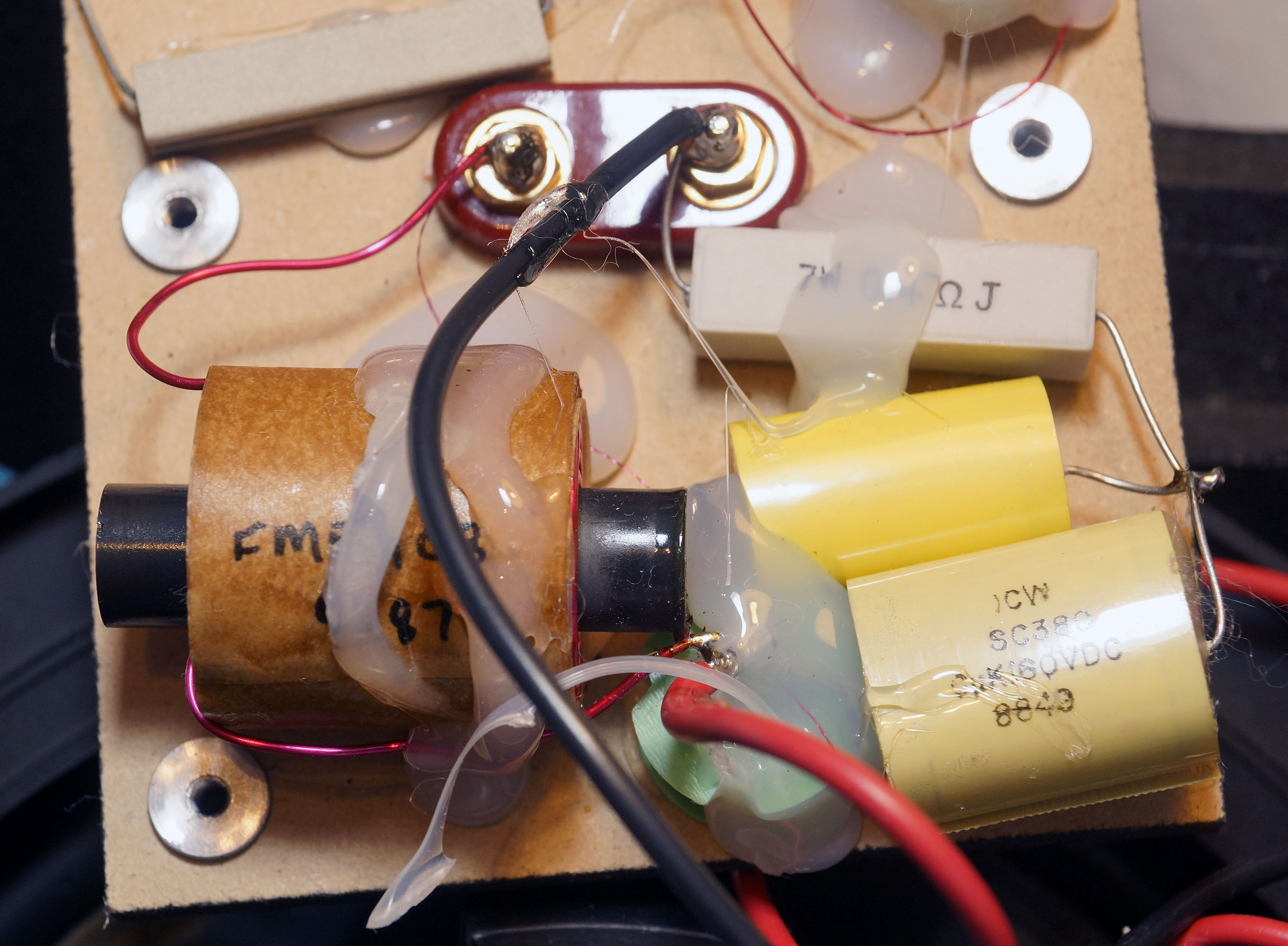

It doesn't look like anything I've ever seen though. That 1.2mH coil with 30R resistance that Zuhl mentioned might be tailoring the bass crossover slope and phase a bit.
But it's really odd, IMO. Is that what it looks like to you BarbieBoy? See, I'd just expect a simple ca. 1.5mH coil here.
FWIW, the tweeter crossover looks totally standard, even down to being wired in negative polarity here.
BTW, I think I've drawn the RC (0.47R +9uF) shunt the wrong way round from your crossover.

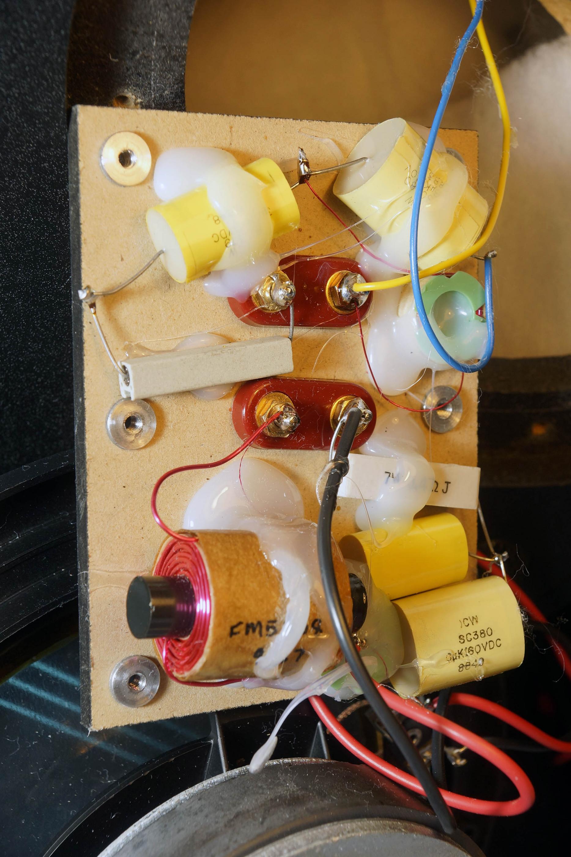

You can't see it on those images, but I have what's left of the crossovers I had here. The inductor says 9.87 on it - I have no way of measuring inductors, but it's a similar size to some 10mH I have in a sub x/o.
The 0.47R does go to the negative.
Interesting you have a single board. Mine had two boards: bass was glued in the bottom of the cabinet and the tweeter in the top rear of the cabinet.
Well, we have a mystery on our hands then! 😀
9.87 is bizarrely accurate, don't you think? 10mH is the preferred value.
Some measurements would help a lot here I think. But you need a good multimeter with a mH inductance scale.

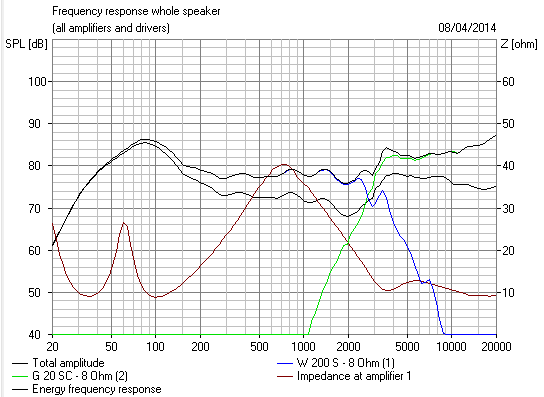

10mH bass coil does THIS to the frequency response in my VERY rough sim. 😕

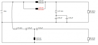

If it is a straight 3dB tweeter reduction you want, which is quite a lot actually, this is how you'd modify it. That will sound a lot less bright at the top end.
The RC Zobel on it's own just rolls off the very top. Which helps metal tweeters IMO.

9-87 is more likely a date code than inductor value.

Yep, Sept 1987 is the cabinet's date stamp so makes sense.

What you do to increase the bass is add, say, 50% value to the bass coil and take a third off the capacitors in the bass circuit back to 6uF. The LC product stays the same, if you follow. This slopes them down more.
However, you then also need to increase attenuation on the treble. Phase shouldn't be affected too much.
But you'd need to know what the bass coil is by measuring it.

Having had another look at the sim, I'm guessing the bass coil is about 1.2mH with that 9uF capacitance for a near 3kHz crossover. I'd reckon 2mH and 6uF would be bassier, perhaps with an ohm or two in the shunt too. The little weird coil might as well go in the bin by my estimation. You'd then add 2-3 ohms to the treble filter input to balance it out in the simplest way.
